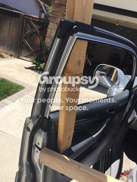

The wind and road noise was really getting to me so the door had to be addressed.
Harnessing the laws of physics, I ever-so-slightly bent the corner back towards the truck:
IMG_2445.jpg~original
Flush and much quieter now:
IMG_2446.jpg~original
Note: use a towel around the 2x4's if you attempt this, or you'll ding the door paint like I did:frusty:

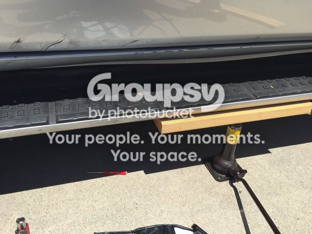

The running board was bent down slightly (another artifact of the aforementioned side impact). I tried to bend it back up:
IMG_2447%201.jpg~original
Not perfect but much better than before.

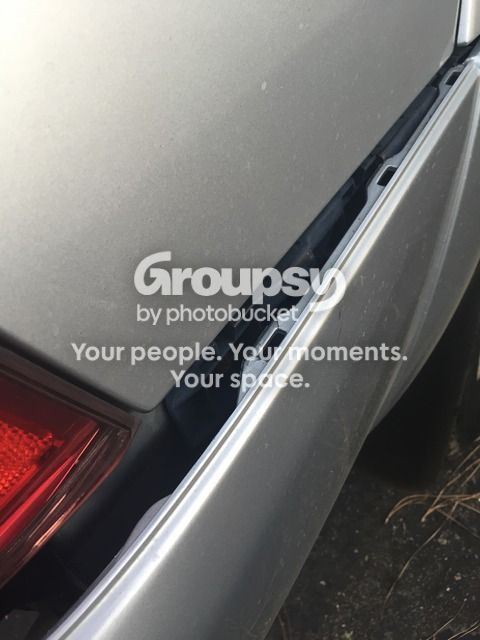

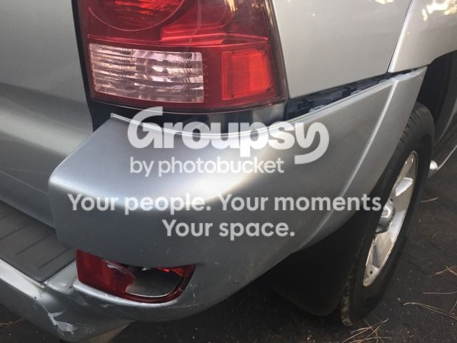

Taillight is ordered. Do I need special clips or something to re-attach this panel?I can see where the tabs go, but not exactly sure how to do it.
Update: the bumper cover clips into a black strip behind the cover. Unfortunately the clips are all busted off mine so I'll need to find another black strip.

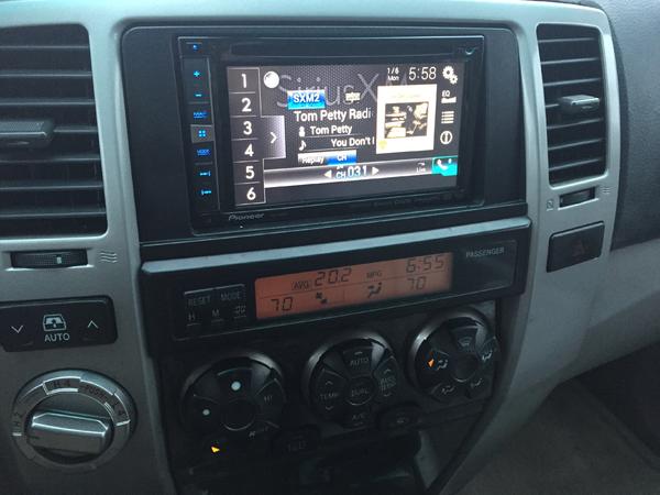

Found this Pioneer AVIC 5000NEX on Craigslist for cheap. Not sure if I need all the bells and whistles, but I like the "factory" look. The biggest challenge was squeezing all the adapters up into the dash: Sirius controller, PAC-TATO unit, ASWC-1 steering wheel control, GPS antenna wiring, etc. I'm happy with how it turned out though; the Metra bezel cleaned it up nicely.

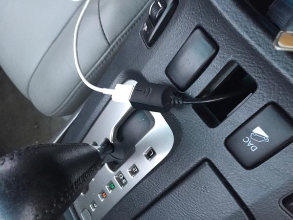

...I also ran the USB input down through the console (for Apple Car Play). Is there a special USB adapter I could put into the button slot to make it look nicer? I browsed Ebay but couldn't find a male-to-female interface.
Found two rear bumper brackets at the junkyard today. If you look closely you can see the clips busted off the old one:
ECE0F2B7-F9D3-4360-9955-01EBE15E9C28.jpg~original
Installed both sides and now the bumper is flush and tight.
