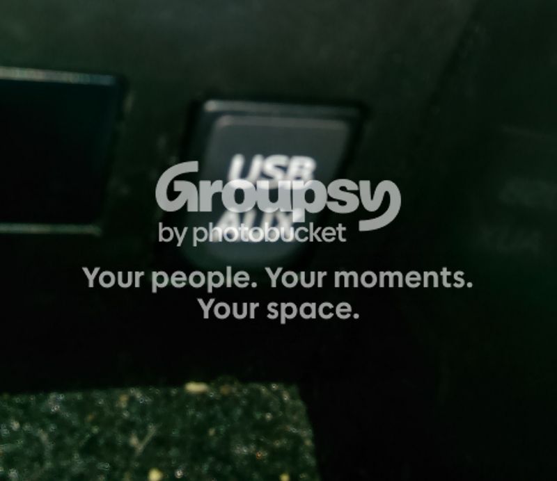

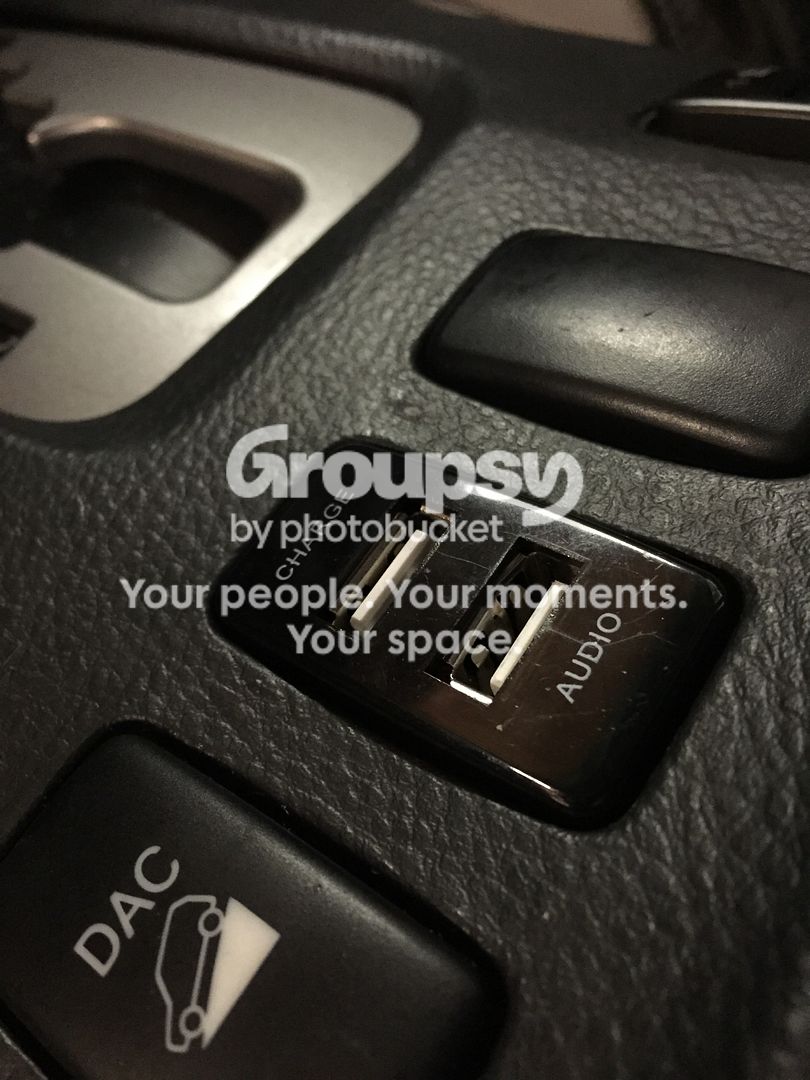

...I also ran the USB input down through the console (for Apple Car Play). Is there a special USB adapter I could put into the button slot to make it look nicer? I browsed Ebay but couldn't find a male-to-female interface.
https://www.amazon.com/gp/product/B...fl_title_40?ie=UTF8&psc=1&smid=A15H3UKRB6RHF9
I found this a while back on amazon. I decided not to get it because I prefer Bluetooth wireless over the wired. one less wire to deal with.
^^ that would work if you want to use that slot. I don't use apple car play, but I routed my usb with a music drive to the inside of the console in the slot where the auxillary plug was located. I originally replaced the insert with a factory usb/aux plug to keep a stock look (in the picture), but my connections weren't the greatest (you have to create a male-female end by taking apart an adapter) and it would restart the usb everytime I hit a bump. I have since then just did what you did and fished the female end through the empty slot inside.
a4bd8c31-5e4d-4abd-8be6-4ad68760e7be.jpg~original

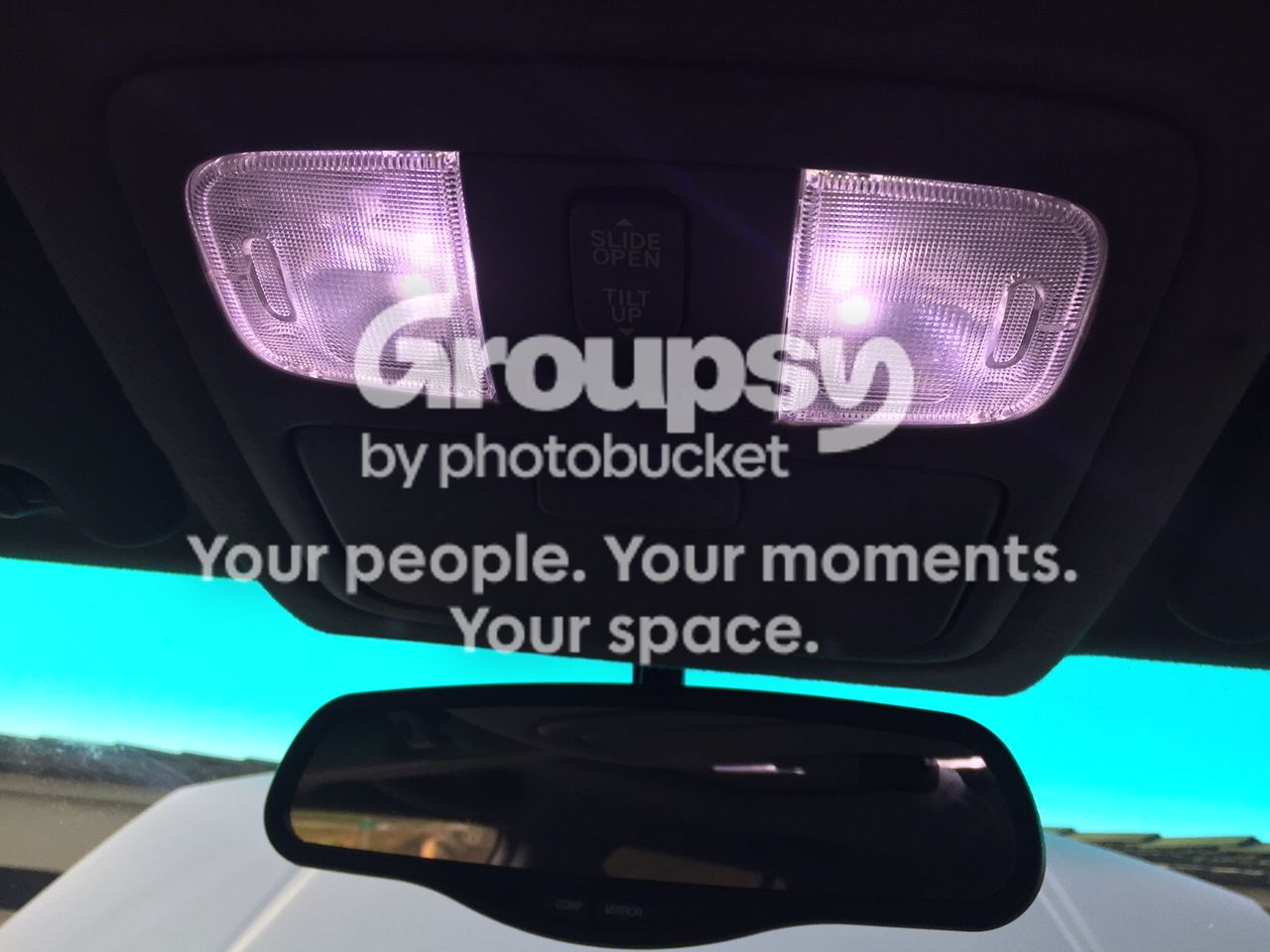

Swapped out the interior bulbs for LED's from Amazon.com.
IMG_2926.jpg~original
Replaced map lights (2) dome light (2), cargo light (1) and door lights (4). There's one extra bulb of this 10-piece kit that I can't account for.

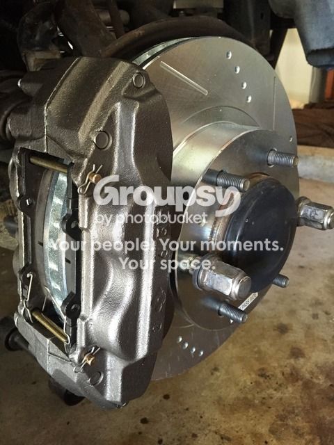

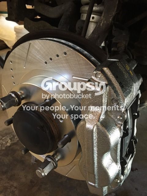

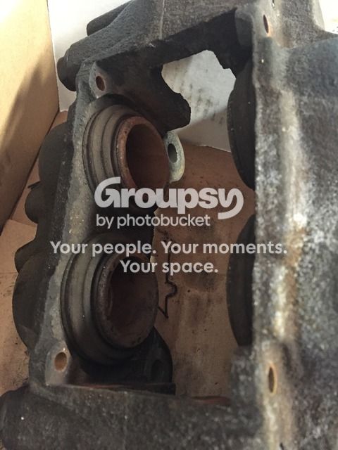

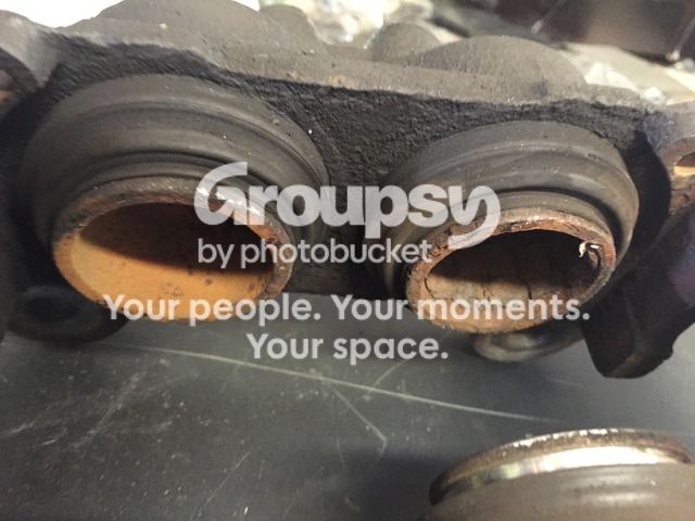

New rotors and pads all around this morning. The back was cake, but the front had TWO frozen calipers:
IMG_4022.jpg~original
...So new calipers as well. Drivers side and passenger side are different colors though, is that normal?
IMG_4016.jpg~original
Brakes are still a tad squishy, has anyone had any luck with re-bleeding to help with the plush pedal?
UPDATE: With a little help from the spouse, I was able to bleed-out an additional amount of air from the brake lines. Much better now.

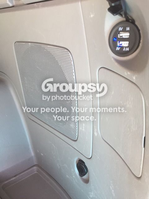

The sub on my JBL system has been blown for a long time now, making that embarrassing rattle whether it's hip-hop or rock-n-roll. I picked up the Rockford Fosgate P3SD2-8 only because of its Amazon reviews (yeah, too lazy to do too much research).

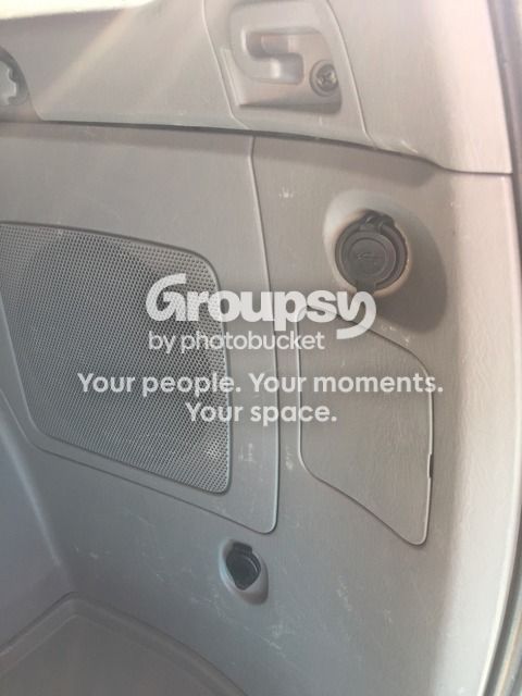

Accessing the subwoofer wasn't too difficult, although I was able to break-off one of the cargo net holders. Two write-ups mentioned that it simply popped out. Well it didn't and I was left with a eyesore, so I put a USB charger in it's place:
IMG_4645.jpg~original
Not sure what I'll use it for, maybe camping?
