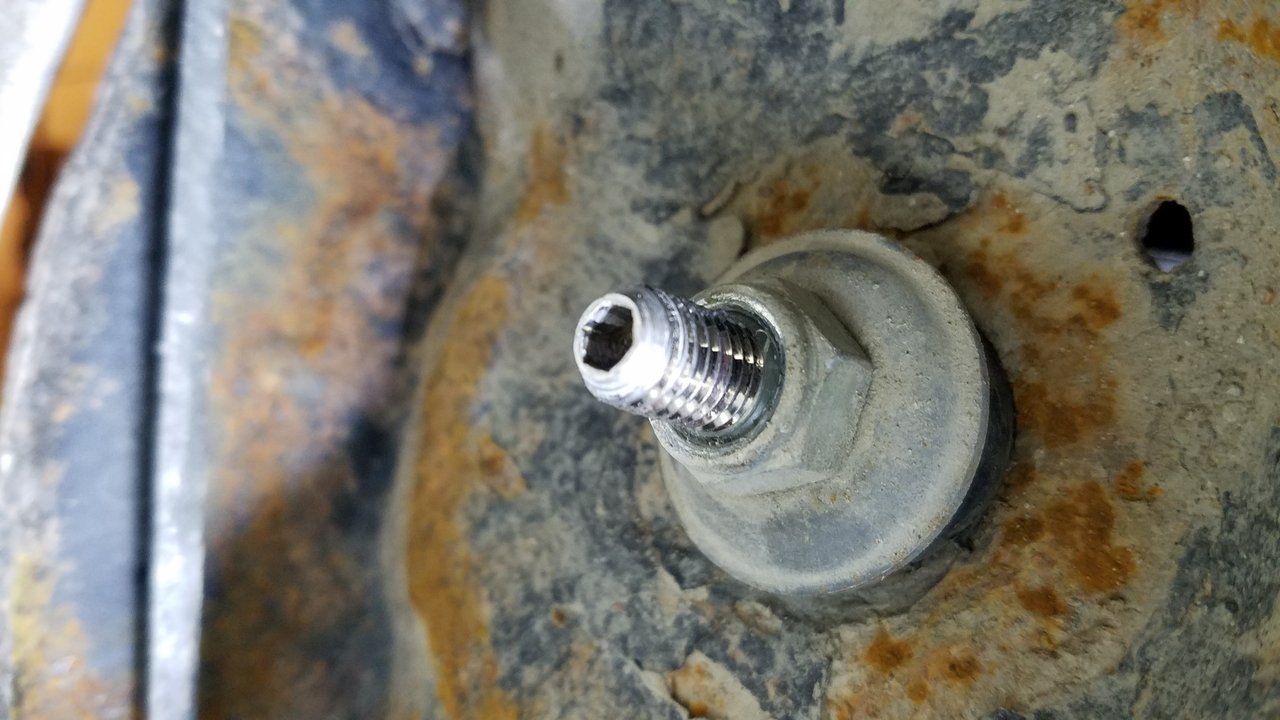

I crawled underneath and looked at them to confirm this actually works and isn't bro science and those threads and hex sockets are completely pristine after 3 winters!

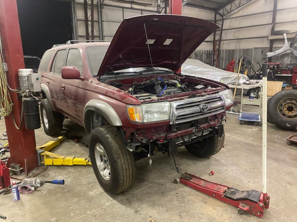

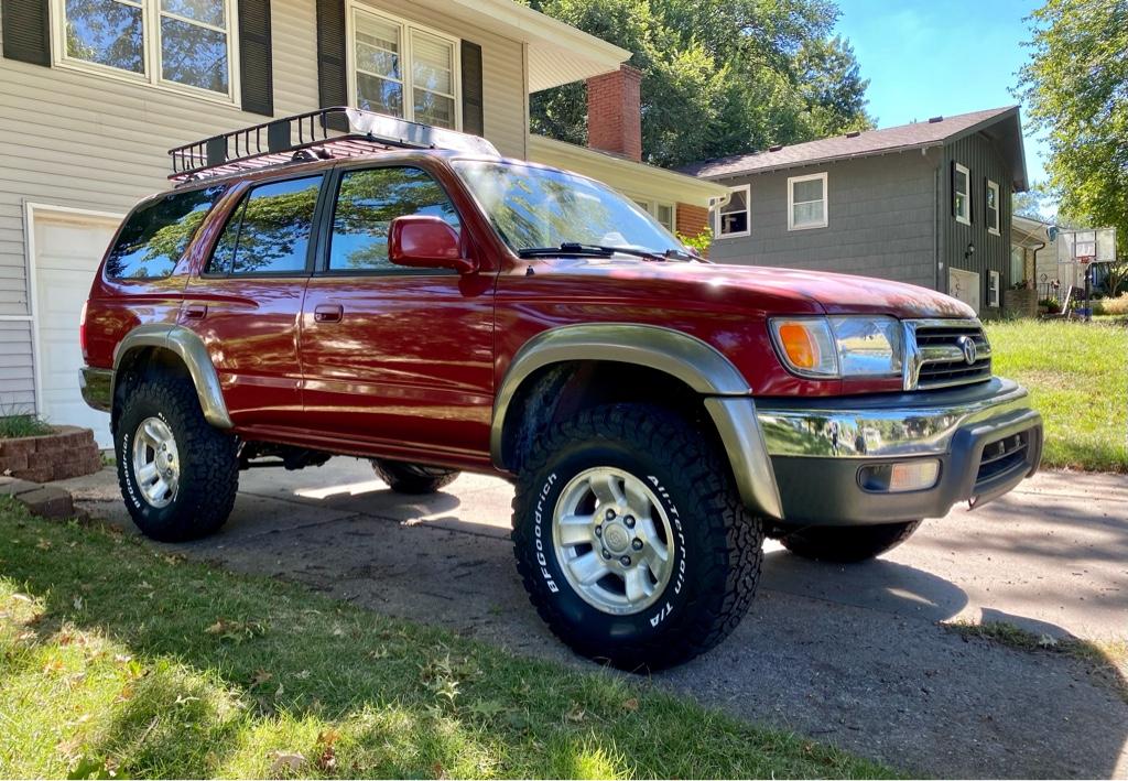

Frame swap is done!!
Still a number of little things to take care of here and there (torn cv axle boots, 4WD issue), but… she runs!
Ride height measurements before and after.
Measured from center hubs to the bottom edge of my oversized fender flares with a half tank of gas, full size spare, and 30-50 pounds of tools in the back.
Original 21 year old suspension:
FRONT DRIVER: ~ 19 3/4”
FRONT PASSENGER: ~ 20 1/4”
REAR DRIVER: ~ just under 20”
REAR PASSENGER: ~ 20”
After frame swap, new poly body mount bushings, and Bilstein 5100s with OME 880/906:
FRONT DRIVER: ~ 21 1/16”
FRONT PASSENGER: ~ 21 1/4”
REAR DRIVER: ~ 22 1/4”
REAR PASSENGER: ~ 22 1/4”
The stance is so much better. I love it. Looks very balanced with the 265/75s to my eye.
I do however still have a slight taco lean in the front. Just under 1/4”. D’oh! I should’ve added that OME 5mm trim packer on the driver front, it would’ve been perfectly level side-to-side. Maybe I’ll add it later…
EDIT: [MENTION=139000]phattyduck[/MENTION] pointed out in another thread:
The front suspension has about a 2:1 motion ratio. That 5mm spacer would add ~10mm of ride height, or ~0.4" Don't mess with success...
So I'll leave well enough alone and I won't add that trim packer unless after settling I somehow get a more pronounced lean.
Before:
After:
Side view to better show forward leaning rake. The rear will likely settle a little bit. Should ride pretty level (but not sag) when fully loaded for trips. I like.
