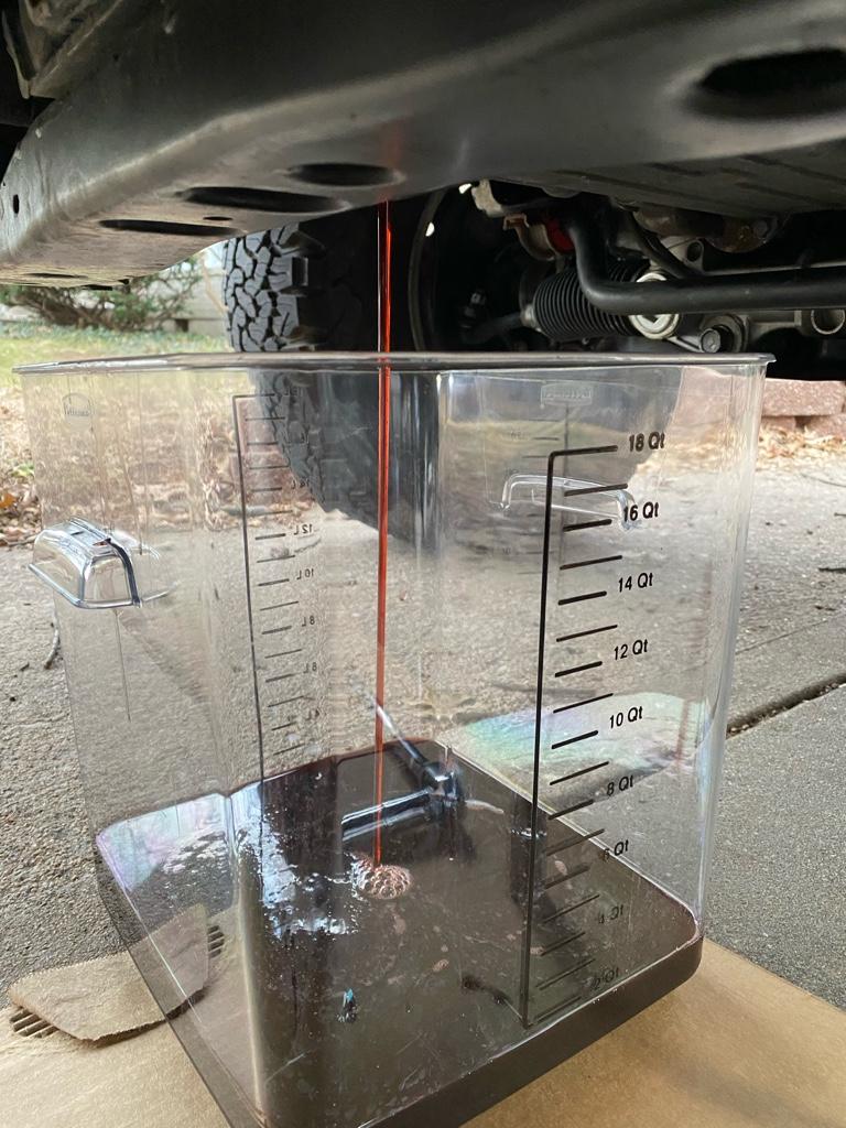

Drained the ATF pan. As far as I can tell, the fluid looks OK. Dark but not totally black. Definitely smells old but not burnt (I think, although I don’t have much experience). No sludge or particulates that I could detect with a paper towel or magnet.
So, I think it’s time for a DIY flush, and then I’ll drop the pan, clean the magnets, and replace the filter. I have about 27 quarts of Valvoline MaxLife for the flush. The Magnefine filter only has about 200 miles on it, so I’ll leave that in place and change it at my next drain and fill (every 10k miles).

If anyone thinks that ATF does not look OK, or thinks that my plan needs to be different, I’m all ears!!
The pan was dropped at some point, but at least 12 years and 100k miles ago. (Previous owner says he didn’t do anything to the transmission. Original owner must have, since there’s a rubber gasket instead of Toyota FIPG.)
That fluid looks pretty good to me
All in all, I pushed about 24 quarts through the transmission system. For the last several quarts it was coming out looking bright red. No sludge or particulates in any of the old fluid.
At this point, I’m pretty sure I don’t need to drop the pan and change the filter. But I already have all the parts from Toyota, so I’ll get to it eventually, but no rush.
At this point, I’m pretty sure I don’t need to drop the pan or change the filter. But I already have all the parts from Toyota, so I’ll get to it eventually, but no rush.
Looks good. If you dropped the pan fluid first 24 quarts sounds correct as I think they hold close to 3 gallons. :)

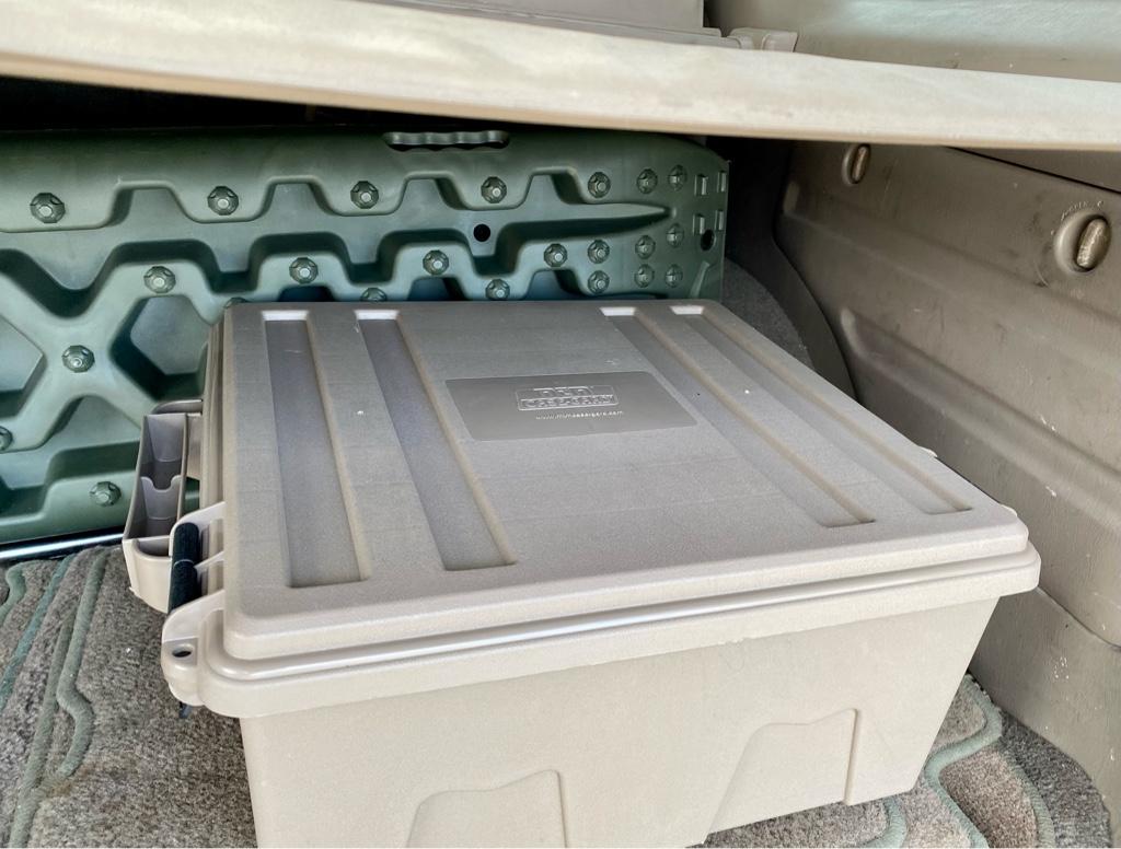

For those who have the oak colored interior, the MTM ACR8-72 Ammo Crate Utility Box in “Dark Earth” is a pretty good color match, relatively cheap, stackable, nice medium size, and very lightweight. FWIW :)
UPDATE: this post reads like a commercial — it is not. Just a quick review of a product I bought and ended up liking. I bough 4 for various purposes.
