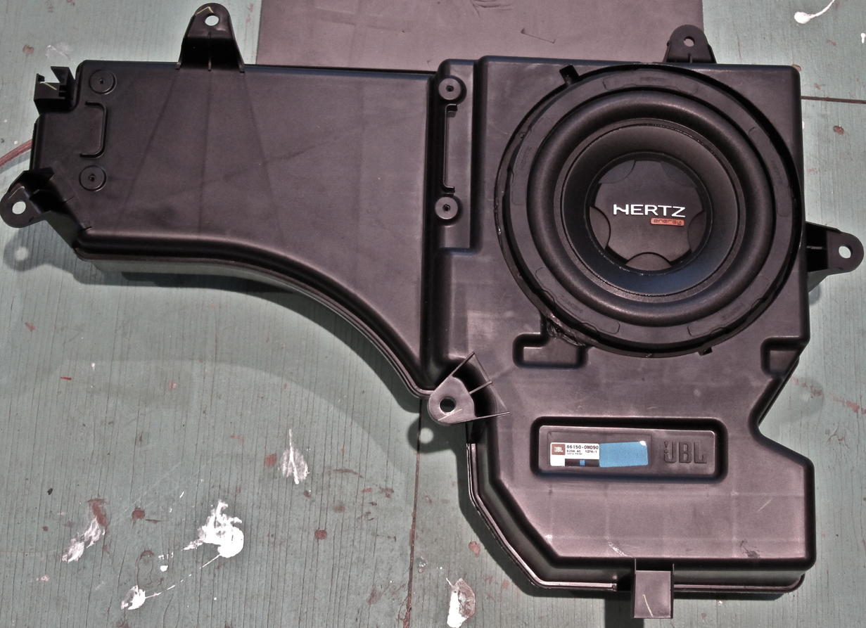

I'm in the process of doing the same thing. Here's my solution so far.
I will be adding an amp to run this. Since I have the no-frills SR5, I expect to find room where the Nav ECU would have gone to put the amp.
I needed to remove all the bracing on the inside of the sub enclosure that would be behind the sub magnet but that was not difficult. (I used a hammer and chisel since I'm a wood worker and that worked really well; the chisel needs to be really sharp and you need to take your time)
I suspect that I will need to trim the inside of the body panel as the mounting flange of the sub is a little proud of the enclosure.
I'll post more as project progresses.

PS: Thanks to Ark_Swamp for all the info that is making this project a lot easier.

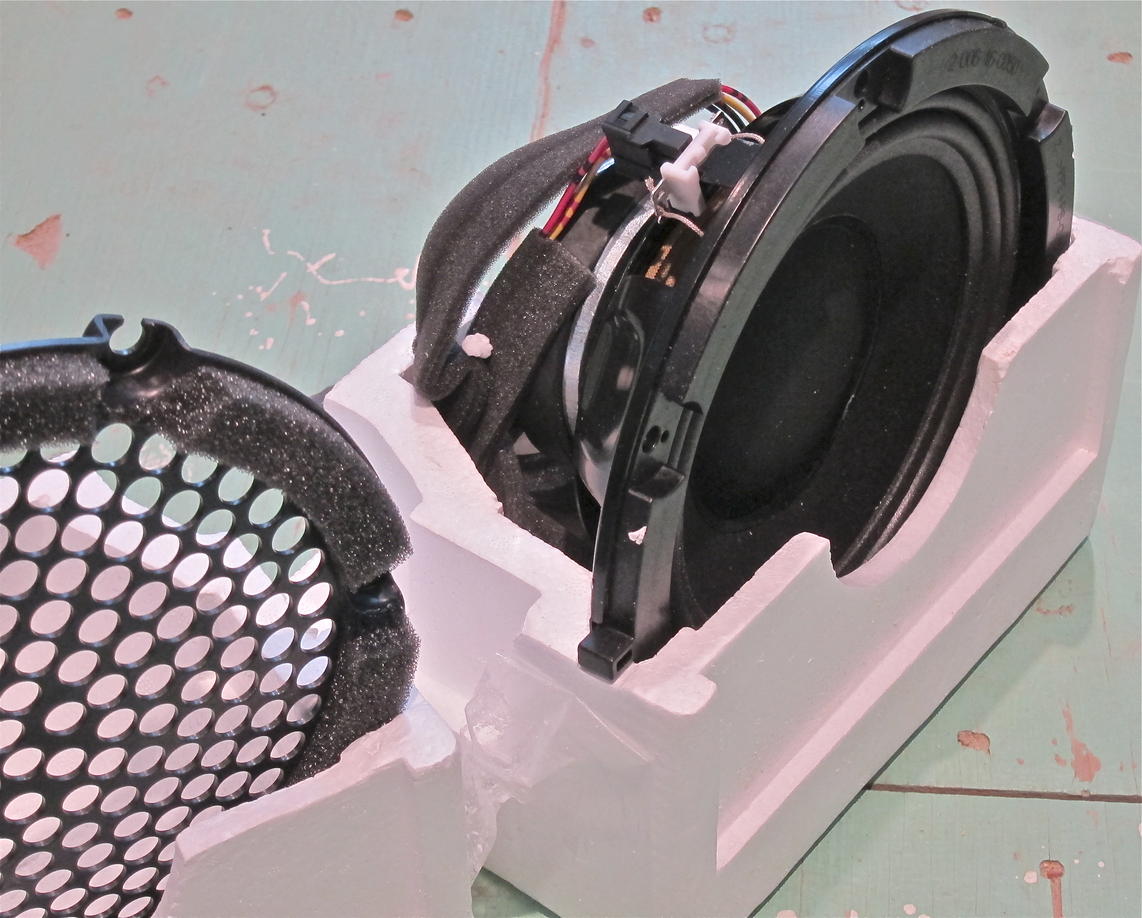

Are you in luck or what ! If you really want that original sub, I happen to have the brand new one that I removed from the above pictured enclosure. I'll sell it to you for $50.00 plus shipping. Sub has never been used.
I have no idea what Toyota gets for a replacement sub alone so you might want to check on that to see if that price is fair. I know the sub enclosure (which included the speaker) was a pretty spendy way to keep it all looking stock.
My personal preference would be to replace it with something of better quality but the original would be the easiest and you can follow Ark_Swamp's tutorial to change it yourself.
let me know, Jon
let me know, Jon
