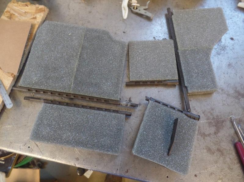

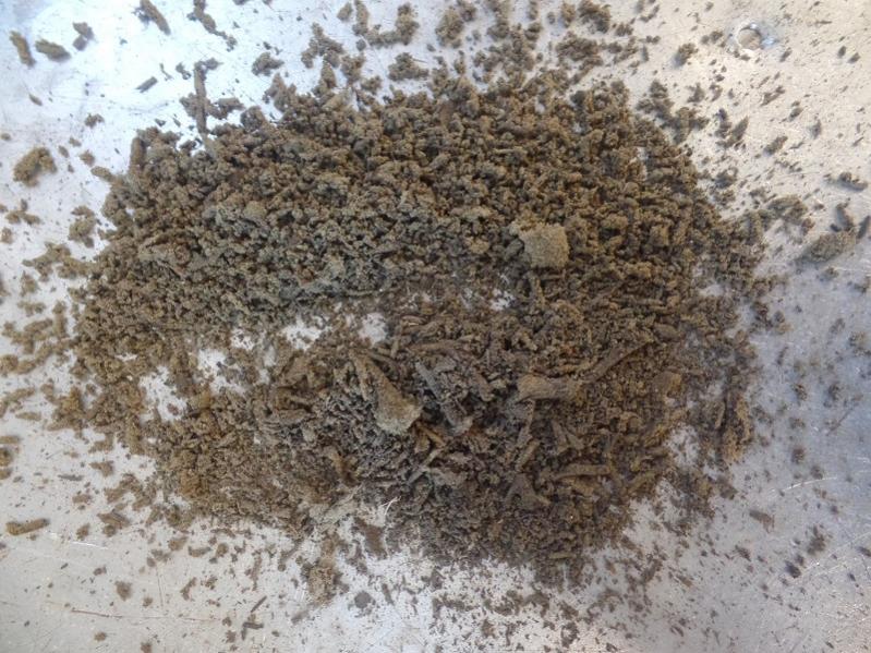

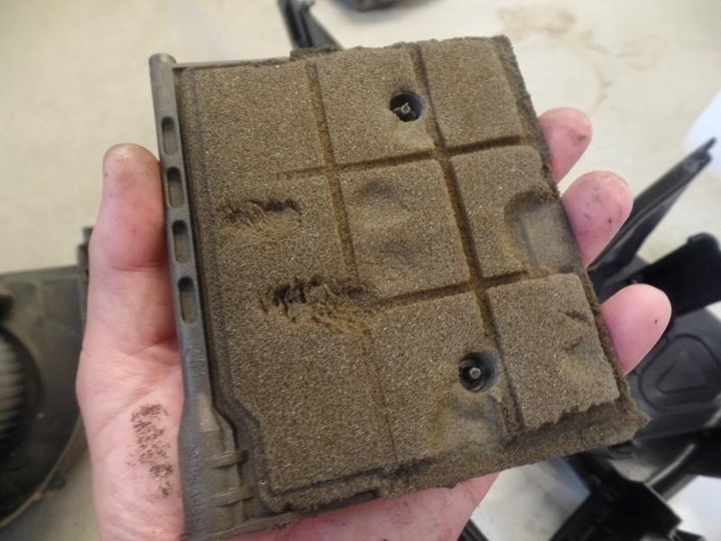

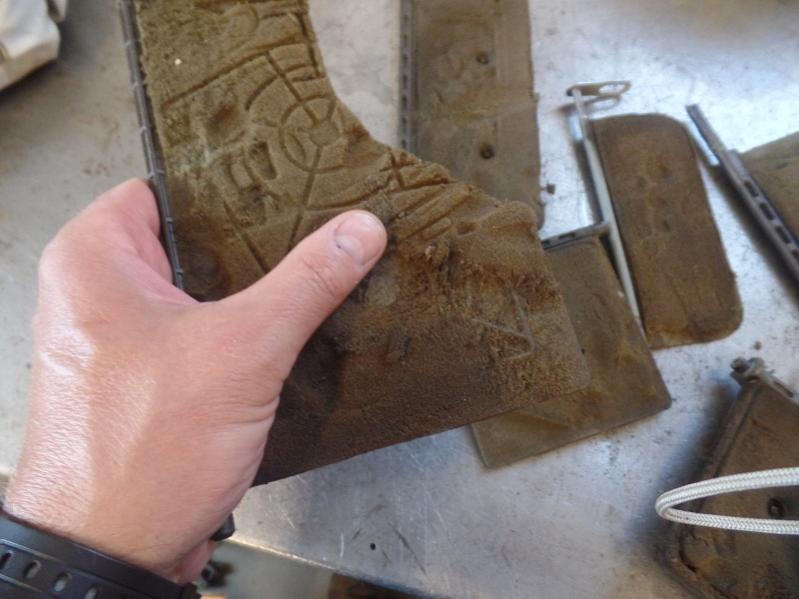

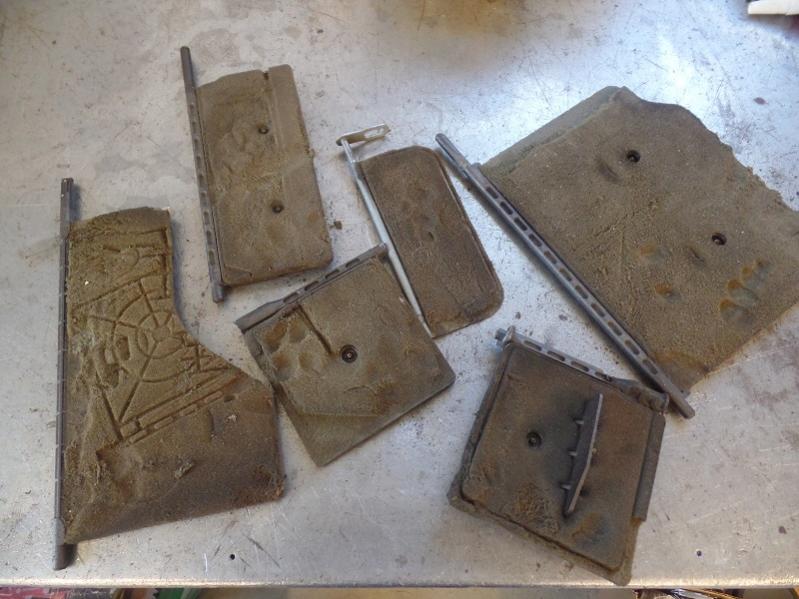

Hey, how was the foam on the blend doors when you had it apart?
I just put a heater core in my 96' Tacoma and they were shot. I fixed them and am in the process of a write up on how I did it for the Tacoma forum I may post on here also.
Tbh, I was so involved with the project I didn't even think to look at anything else when it was all apart...I was racing the clock to get back to the shop to get it recharged. Out of curiosity, had did you find out your blend doors were shot?
Blend doors
When I touched them the foam was really mushy and when I pushed my finger into it, it just left an indentation and didn't return. Then I started rubbing them with my fingers and the foam was just balling up and falling off the doors.
Last pic is some of the doors with the new foam.
