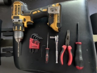

Tools:
-Phillips Screw driver
-9mm ratchet
-5/64” allen wrench
-5/32” drill bit
-Pliers

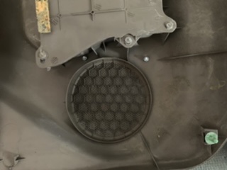

The most difficult part is removing your door panel which I suppose is not required but I thought it made life easier and this didn’t come with install instructions so I thought it best to see what I was doing.
1.Remove door panel, I used a pick to release the clip on the door handle rod (hardest part of the process aside from taking your time so you don’t break any of the 20 year old door panel clips).

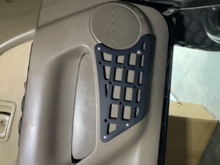

2.Line panel up with edge of speaker
3.On the Victory website it has a picture of the molle panel mounted with nuts/bolts on all four corners. However, the molle panel I received had larger hole pre-drilled on the bottom inside corner and the screws would not hold without a washer. There are smaller holes you can mount through but I chose to use this hole with a washer as it moved the screw mounting location behind the panel instead of inside the door cubby.
4.Drill corresponding holes
5.Insert bolt through panel, through spacer and secure with lock nuts. The top bolt mounting position nearest the speaker required me to hold in place with a pair of needle-nose pliers…not enough space to get a ratchet on it.
Thoughts: Too easy…haven’t used yet but seems practical. I don’t love the extra length of the bolts sticking into the door cubby and will likely remove them and cut them down later.

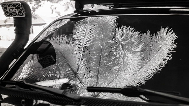

So I did a thing...added SunTek clear window film to my windshield with the goal of heat reduction. It worked very well! Here is an unusual pic taken with a full spectrum modified camera with a 850nm filter showing blockade of IR light (windshield is black) and a really sharp reflection. If you feel like you get significant heat through your windshield and don’t want a tinted film (illegal I think), this clear stuff worked better than expected!

So I did a thing...added SunTek clear window film to my windshield with the goal of heat reduction. It worked very well! Here is an unusual pic taken with a full spectrum modified camera with a 850nm filter showing complete blockade of IR light (windshield is black) and a really sharp reflection. If you feel like you get significant heat through your windshield and don’t want a tinted film (illegal I think), this clear stuff worked better than expected!
Wow, nice update and a cool photo effect!
I have LLumar AIR80 window & windshield tint which is optically clear but blocks UV and IR frequencies -- sounds like what you got. It makes a huge difference! Whenever we drive down into sunny Florida I am so grateful for it.

Sounds very similar....really wish I did this years ago. I went with 15% ceramic on the rear and it is so much cooler overall. If you make it down to the Tampa area would be great meet the famous JZiggy!

Gee whiz!! We are usually on the east FL coast to see family but maybe we could meet up for some wheeling!
