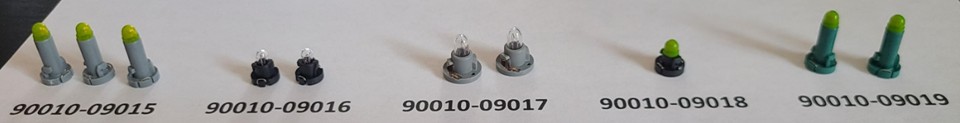

Alright, I'm going out of my mind reading page after page after page. All I want to know is how many bulbs, what kind of bulbs, and I want them in white LED for the climate, clock buttons and screen. Please help because I have no lights in my gauge right now and don't want the OEM ones.
The same thing happend to me you need 2 bulbs. sold on ebay oem factory bulbs perfect brightness solves the problem for under 8$. Installation takes no more than 15 min. I tried going the after market route and the cheap route . I ended up putting in factory oem bulbs and im happy. Anyway id buy these for now and take your time sourcing out a kit for led bulbs or what not.

This shows 8 bulbs total.
HVAC and info center bulb information
This shows bulb heights.
Amazon.com: GENUINE TOYOTA OEM COOLER CONTROL CONSOLE BULBS (SET OF 10) 90010-09015 - 90010-09019: Automotive
These are the bulbs.
C = 09017 = T4= NEO4 led Main screen/clock 2 qty (These are the only two with the 6 volt/12 volt concern)
D= 09018 = T3 = NEO3 Reset and Mode 1 qty
A= 09015 = T3 = NEO3 Three control buttons 3 qty
E = 09019= T3 = NEO3 defrost/recirc 2 qty

I am still attempting to specifically identify LED replacements for the OEM incandescent bulbs in the climate control panel in a 2007 Toyota 4Runner SR5. Attached photo reflects those OEM bulbs and bulb numbers.
The post below from 81Runner indicates that 5630(t4) will work on the display and 5630(t3) "for everything else". But then he says that 5628(t3) are needed for the "buttons".
While the info below is helpful, the comment above is a bit confusing. Of those bulbs shown on the attached photo, which ones require the 5628(t3)? ...5630(t3)? ...5630(t4)?
Also, what about the varying height/length of the bulbs? I don't see that accounted for in sources for the 5630.
Finally, I have scoured internet sources and the 5628 is not to be found anywhere. Can someone identify where the 5628 can be purchased? Or is this supposed to be 3528 instead?
I just need very specific LED identities and sources for each of the bulbs in the climate control panel:
90010-09015
90010-09016
90010-09017
90010-09018
90010-09019
Can someone assist with this detail? Much thanks!

I am attempting to specifically identify LED replacements for the OEM incandescent bulbs in the climate control panel in a 2007 Toyota 4Runner SR5. Attached photo reflects those OEM bulbs and bulb numbers.
I've seen in other posts that the Samsung 5630(t4); 5630(t3); and 5628(t3) bulbs will work but details are lacking on specific sources and specifically which of these bulbs replace which of the OEM incandescent bulbs.
Also, when trying to identify LEDs, I don't see addressed anywhere the varying height/length of the bulbs.
In summary, I just need very specific LED identities (item or part #) and sources for each of the bulbs in the climate control panel:
90010-09015
90010-09016
90010-09017
90010-09018
90010-09019
