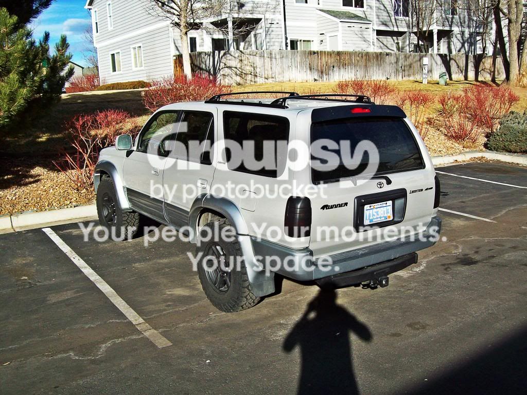

OK so i have a pretty straight forward question for you guys. I absolutely HATE any little bit of chrome, so i'm looking to do something with my emblems and grill. (2000 Limited) I just plasti-dipped my wheels and have about a can and a half left so I could 1: plasti-dip them, 2: Just debadge the truck, or 3: ??? (other suggestions)
Plasti-dip all of them and totally remove the Toyota from the bottom right corner.
Thanks for the idea! I ended up going with this idea and it turned out to be exactly what i wanted.
100_0530_zpsb69a1ce5.jpg~original
Looks good, Thats exactly what I'm going to do as soon as the weather warms up here. How did you go about removing the Toyota badge?
It can be a pain sometimes and I ended up breaking it accidentally, but just take some floss and run it underneath the emblem pulling the ends back and forth, to act as a mini saw in a sense. Then when you get the emblem off just pick the leftover adhesive bits off and clean up the area with some adhesive remover (it may take some solidelbow grease). And then you're done!

Sad part is that's actually just the factory tint. After i went "Dip Crazy" (emblems tails grill wheels) i pulled it off the emblem on the grill and itwas too chrome for me so i went and did just one layer of dip and it dulled the chrome perfectly!
