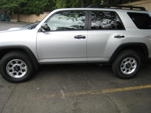

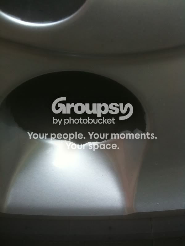

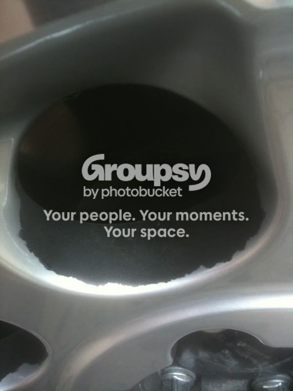

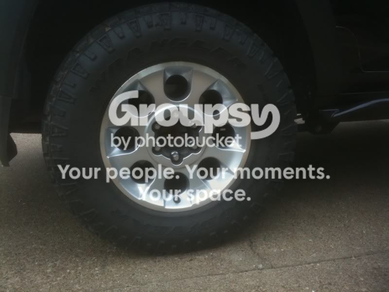

Almost a year ago, I applied the plastidip and it has held up great. Today I removed the dip to see if the wheels suffered from any side effects.
Once removed, the wheels looked just like I remembered before application. The only thing that was damaged was my poor fingers. The thickness of the coating around the holes in the rim was thin, causing me to use friction to remove.
**Lesson learned: The thicker you apply, the easier it will be to remove!**
Here are some pictures! I still need to rotate the tires, and remove the plastidip around the lug nuts.
I am going to apply plastidip again in the near future, and I am currently experimenting with adding color this time. The future may hold a dark gray wheel this next time. Your thoughts?

Thanks for the update. Any pics of how the plasti dip looked just before you removed it?
Sorry, my camera was acting up and I did not get any pics before removal. The coating still looked like the day it was applied. I only removed to check on the wheels and to prove a co-worker wrong at work.

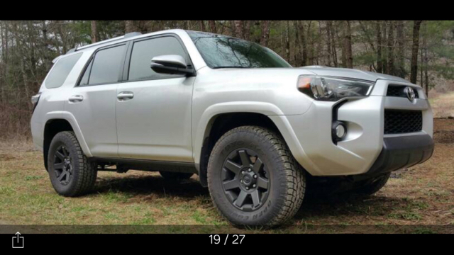

Sorry to revive a really old thread, but has anybody plastidipped the new style Trail wheels? I've searched and haven't been able to find many pictures.

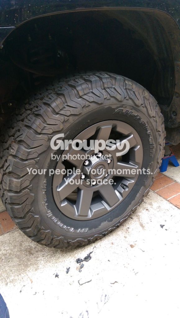

I just painted mine the other day. This is anthracite gray from dipyourcar.com. I bought the wheel kit (comes with 4 cans - two gray and two anthracite gray). Still have a lot left over.
Not my truck it's another member on here, I saved the pic when I was planning on doing mine.

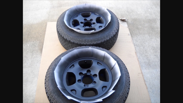

A helpful trick that I learned when spraying the wheels on my old car, go buy a pack of index cards and slide them in between the wheel and tire, they will all flare out and and save you the headache of taping and masking off. Worked like a champ on my wheels, also makes touch up super easy if you scrape it.
i guess a silly question, but if you are really wheeling, arent you going to rough up whatever your wheels are painted/coated with??
Can you post some close up pics?
Definitely use the index card trick. Here is what happens if you don't and its the biggest pain in the ass to get it off the rubber:
[MENTION=98734]Osmith[/MENTION] this is the best I have right now. Currently they are covered in salt so I wont have them clean for a while. If you want I can take pics of them salty and dirty. Just let me know!
Nope looks good thanks. How metallic are they? Any sparkle in the sun light at all? Did you use the pre dip spray stuff or the protective dip coat?
sorry, I didn't see this.
They aren't super metallic. They are more on the matte side than metallic. You could throw a coat of glossifier on and it'll be much more metallic but I wasn't going for that look.
I didn't use pre dip or the protective dip coat. I feel like that is all snake oil and a waste of money. Comes out just fine without any of that stuff
