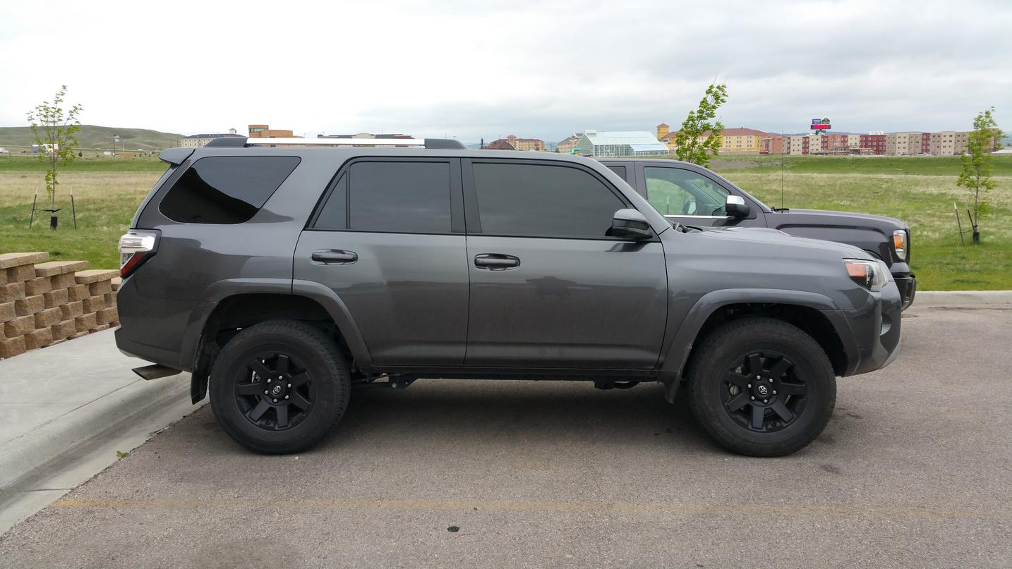

Painted the wheels and center caps black. I removed the Toyota emblem and left that silver.
