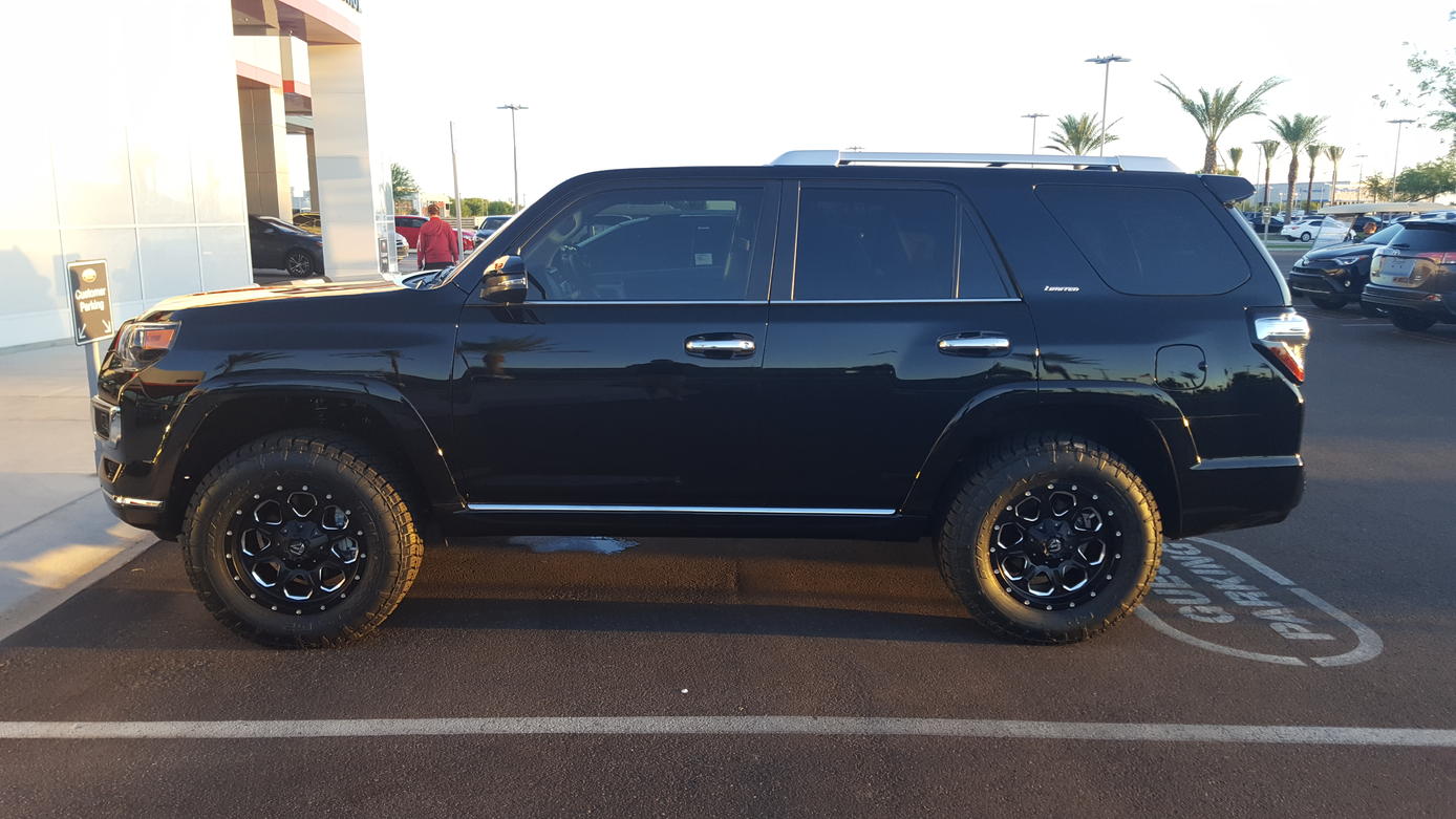

New guy here from AZ... Just brought her home!

Bilsteins all the way around.
1.75" on front and OME 10mm spacers on the back. Also put on a 3/8" spacer on driver front and an additional 10mm on driver rear to account for the lean. I have a 0.75" rake after all said and done.

this might be a stupid question, but did you plastidip your fenders or is that a part that you added on? and if you plastidipped them, how's the durability been?

I do not have them plastidipped. That is how the 2010-2013 Trails come. Some people on here do paint or plastidip them though. I would assume that it holds up well.

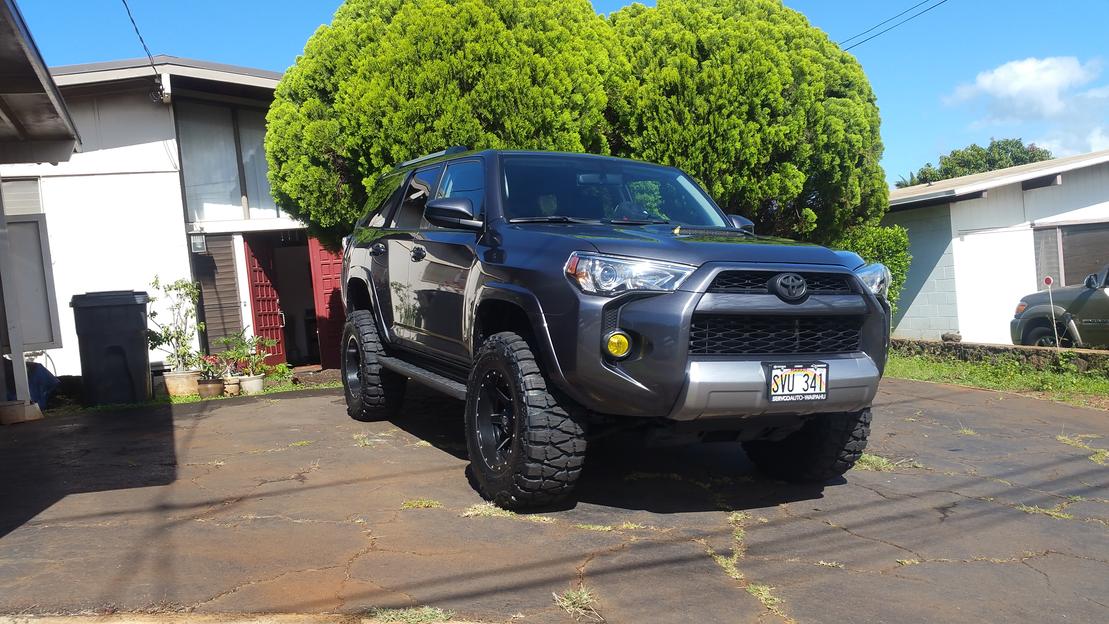

Bilsteins 5100 (fronts at 1.75) and rear OME 2895e coils in the rear & 1 OME trim packer on the drivers side rear to compensate for the lean. In all honesty I would like to set the fronts to 2.5 because it looks a little "too raked" but I think I'll just leave it for now... Unless adjusting the front struts can be done easily without too much work.

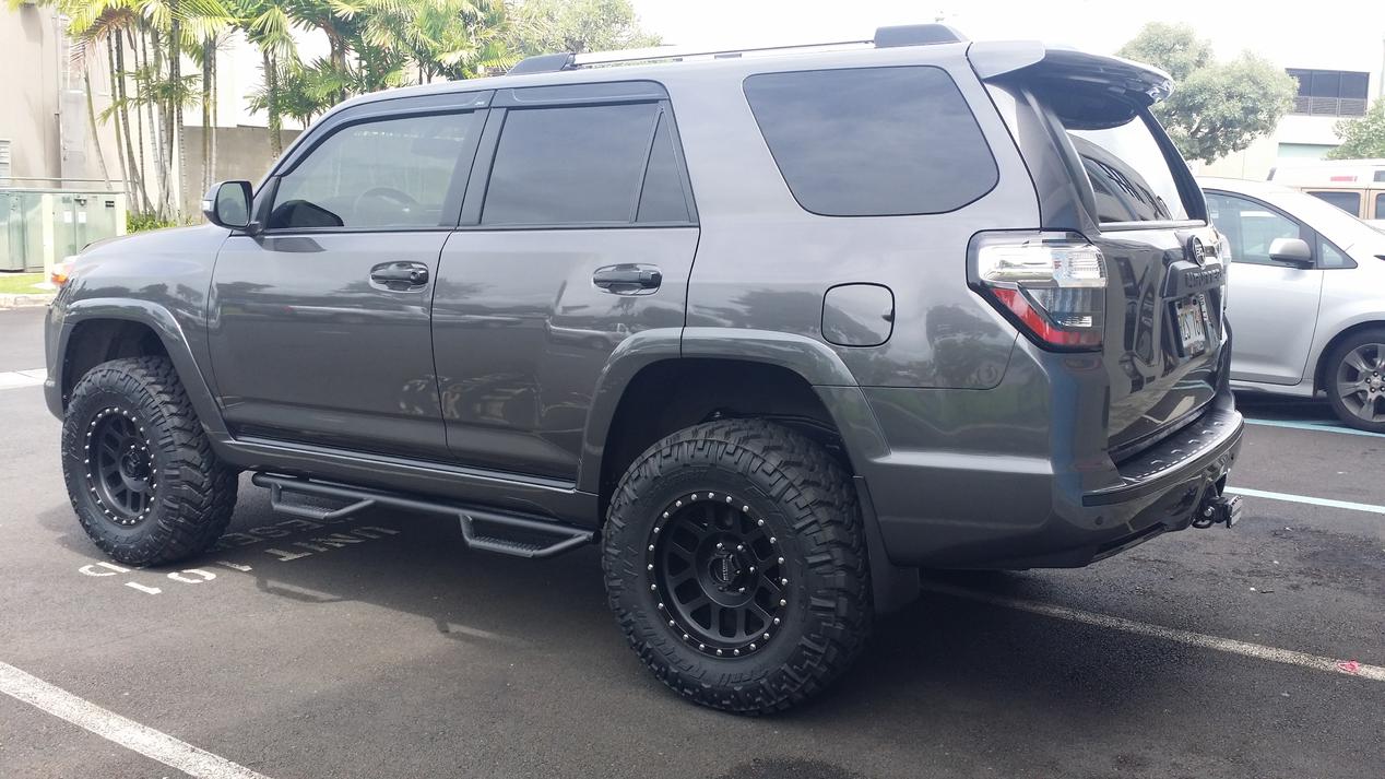

Mine - still in the process of modifying the mud flaps, using a combination of trim and heat gun.
ICON Stage 2 suspension, Motometal 951B wheels (17 x 8), bridgestone ATK's 285/70/R17
The sliders are on order, but a 4-week lead time (Demello Hybrid bolt-on)
