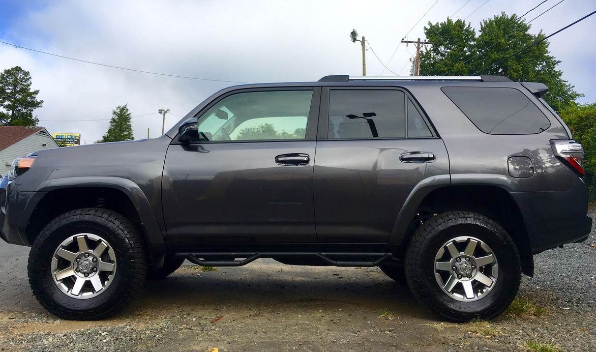

14 Trail Premium w/ KDSS. BOSS Suspension , 285 Nittos

So I'm new to the 4Runner world but have always had lifted trucks. All I can find are either custom tall lifts or bolt on 3"... Are there no options bigger than 3" ????

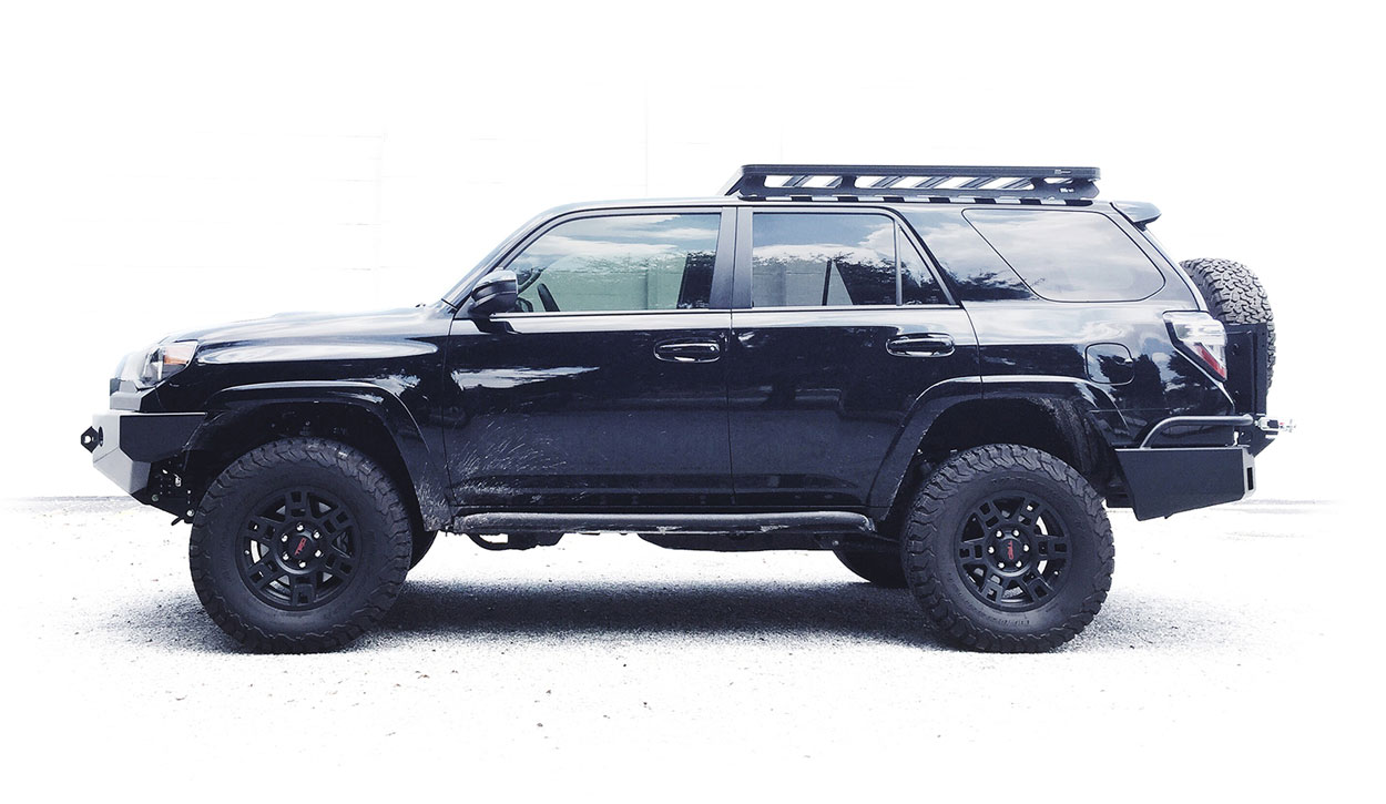

Here's our 2016 Trail.
3" lift:
Icon 2.5 Coil Over Front struts
Icon upper A-Arms
Fox 2.0 Resevoir Rear shocks
Icon Rear Coils
Icon Rear Trac Bar
BFG All Terrain KO2 285/70R17
TRD 17" black wheels
and more.
