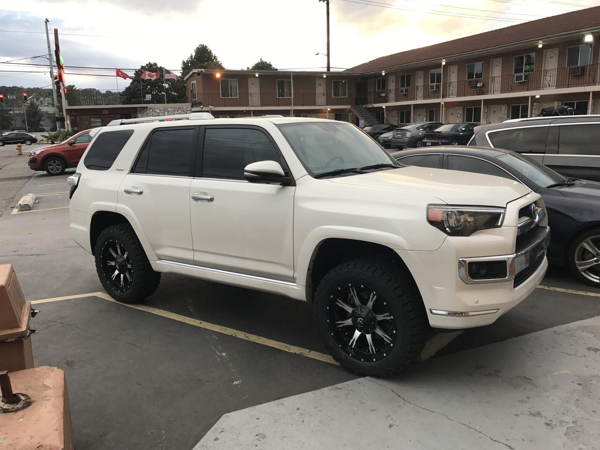

Spent the day yesterday installing the lift, UCAs, diff drop, wheels and tires.
Bilstein 5100 (front 2.5, rear 1.5 Toytec spacers), SPC UCA, Toytec diff drop, Rotiform 17x9 et1, BFG KO2 285\70. No trimming yet, very light rubbing on front bumper when at full lock backing up at stupid speeds. No rubbing at normal driving conditions. Will see how it is on the trails this weekend.
Just curious, why did you go thru the trouble of a diff drop and UCA's with only a 2.5 lift? Are you planning for the future or just anal? Lol. Looks great tho!
I dig the processing style you did here on the photo. Just FYI. Looks like a dealer catalog photo.
A combination of both I guess. I know the stock UCAs are fine under 3" but I wanted the piece of mind we would have zero issues getting everything into spec once on the alignment rack, and would clear the body mount with the 285 tires and 9" wheels. With the diff drop, it was just a matter of us having one so installed it. At the end of the day, both the UCA and diff drop were no trouble and fairly easy to install, the hard part will be convincing my wife we need a higher lift! :D
And thank you!
Thanks!
