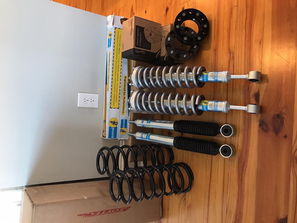

LOOKY WHAT WE HAVE HERE! After 6 years of looking on this forum, hours and hours of research, selling one Runner, buying another. I will finally have something worthy of this thread!
Wife's Christmas Present from me this year!
Toytec/Bilstein 3"/2" Lift
SpriderTrax Spacers
Thank you, all of you. Lots of good dudes with good info here.
I plan on posting before an after pics. Install date is Jan 16th.
(not sure how to make photo stay upright)

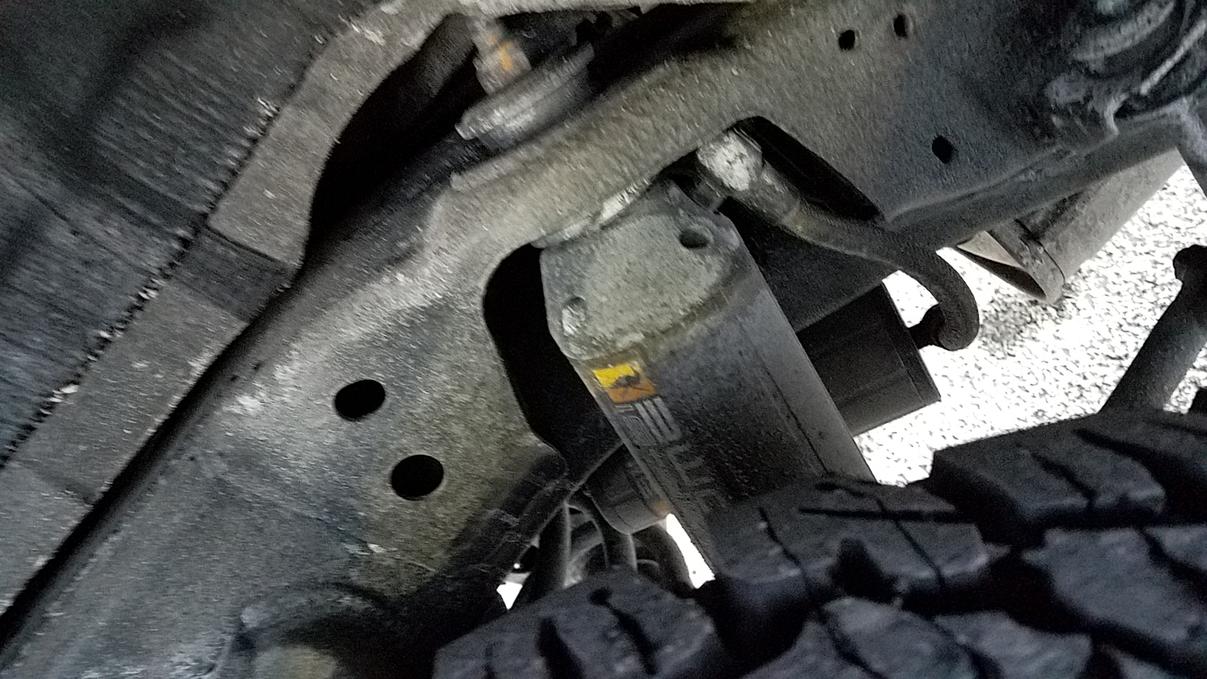

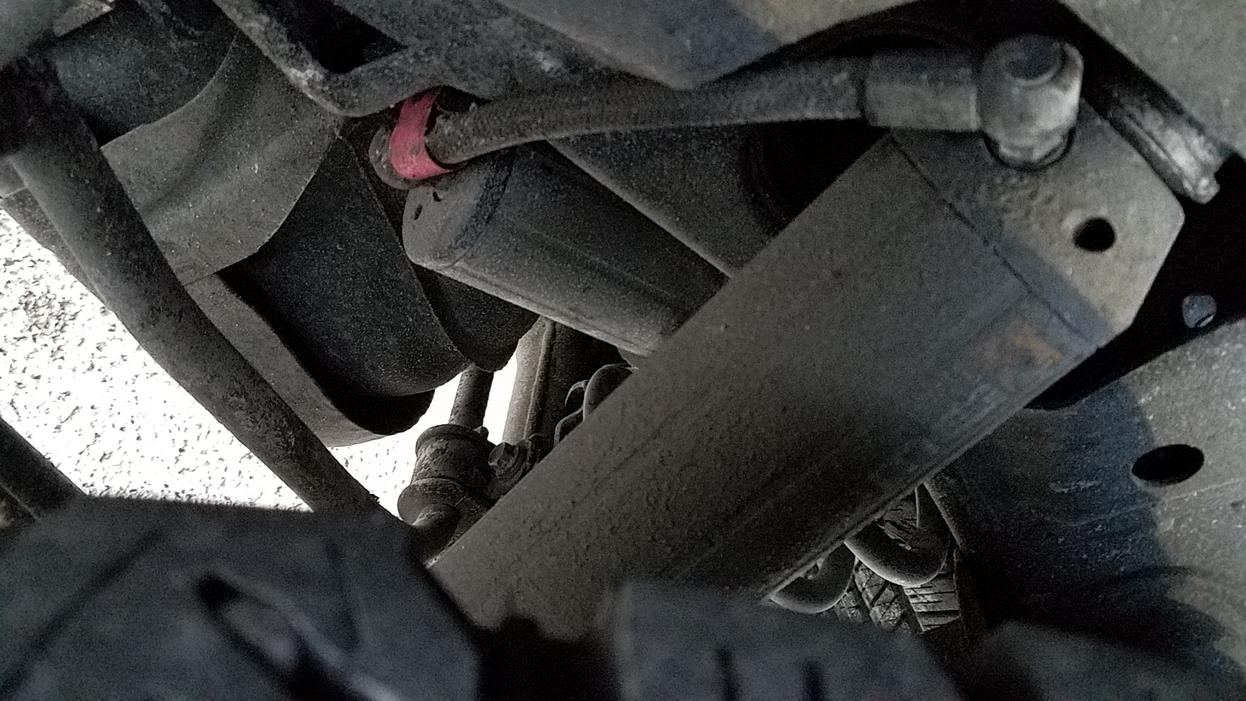

I've looked into adding the body spacer to fit bigger tires. Do the 295/70s rub much? I like the look

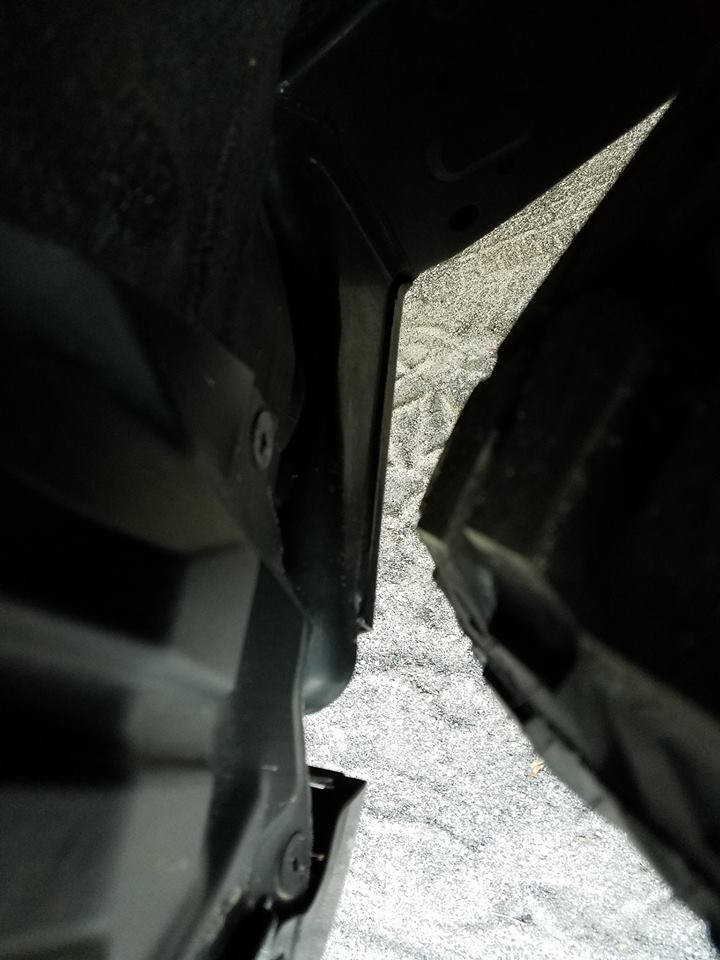

You don't need the body lift even though it does look great. I'm lifted 3" and only had to trim the front lower inside lip of the front bumper skin. I also removed the front mud flaps but that was long before the lift, I just hate the look. I have the 295/70/17 Ridge Grapplers and have no issues.

Definitely have to trim a lot in the bottom corners of front wheel wells behind the tires, both the fender flares and the body mounts. But keep in mind it really depends on the specs of the wheels and tires you're running

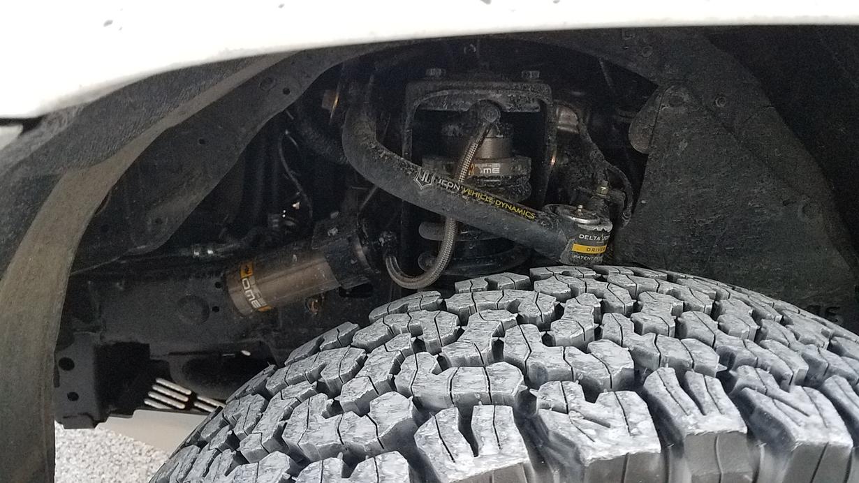

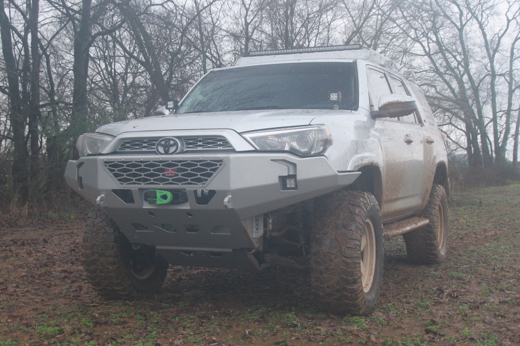

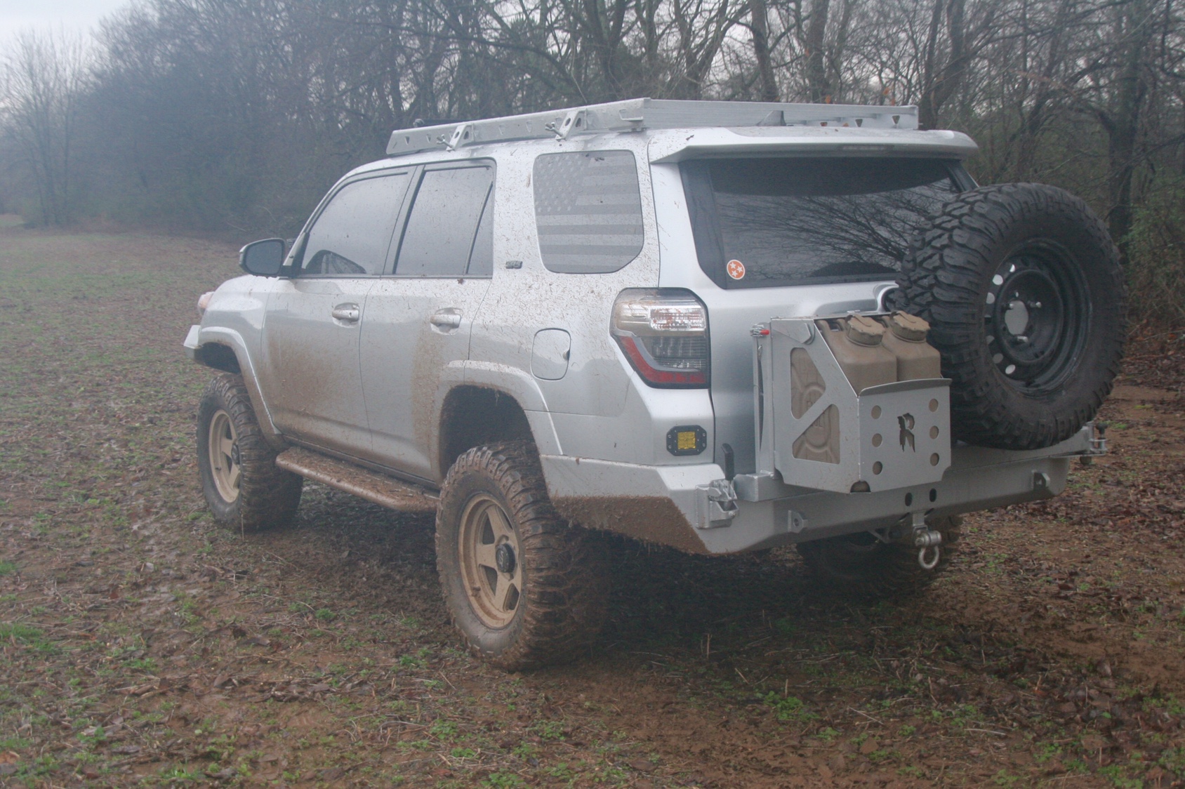

Wife's 4Runner...plan is to install front and rear airlockers, a magnuson supercharger, and lotus cv axles.
