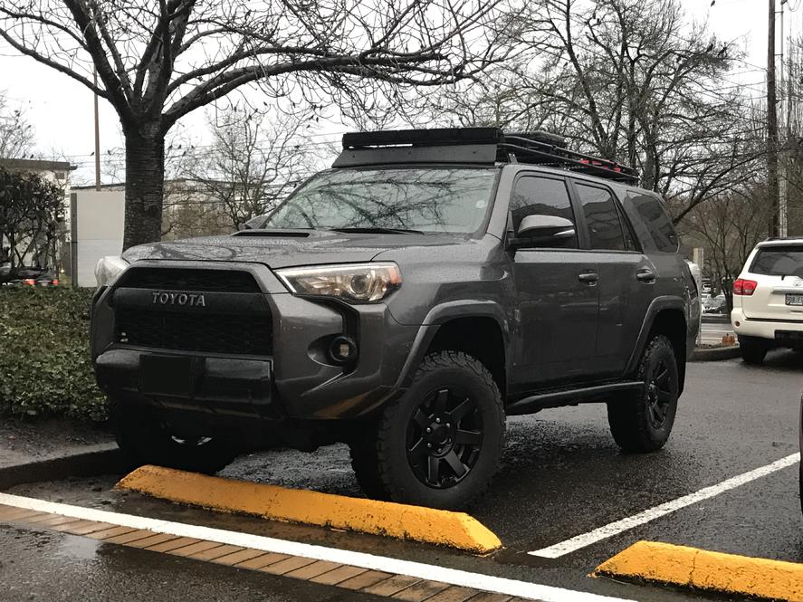

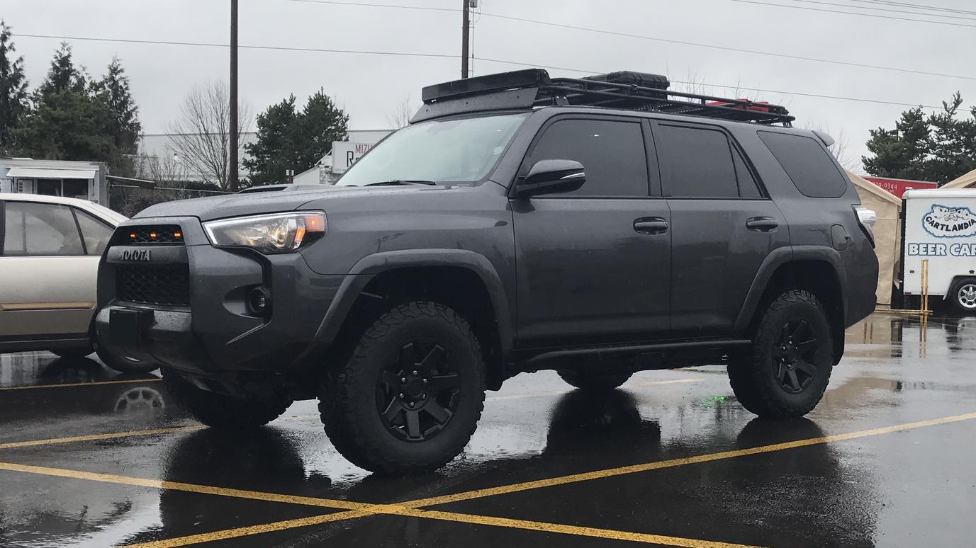

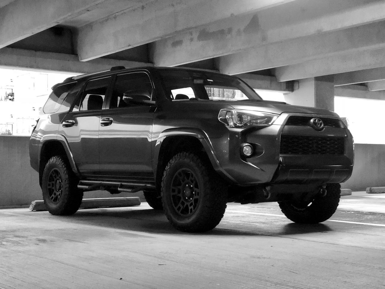

Finally Lifted
Front: Bilsteins 5100s (set at 0) w/ OME 2883 coils + 1/2in top spacers & Camburg UCAs
Rear: Bilsteins 5100s w/ Wheeler's T13 coils + OME 10mm trim spacers
Trail wheels with 255/75/17 BFG KO2s

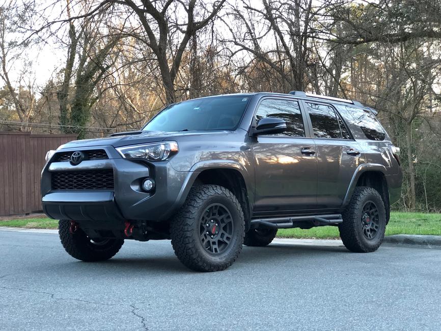

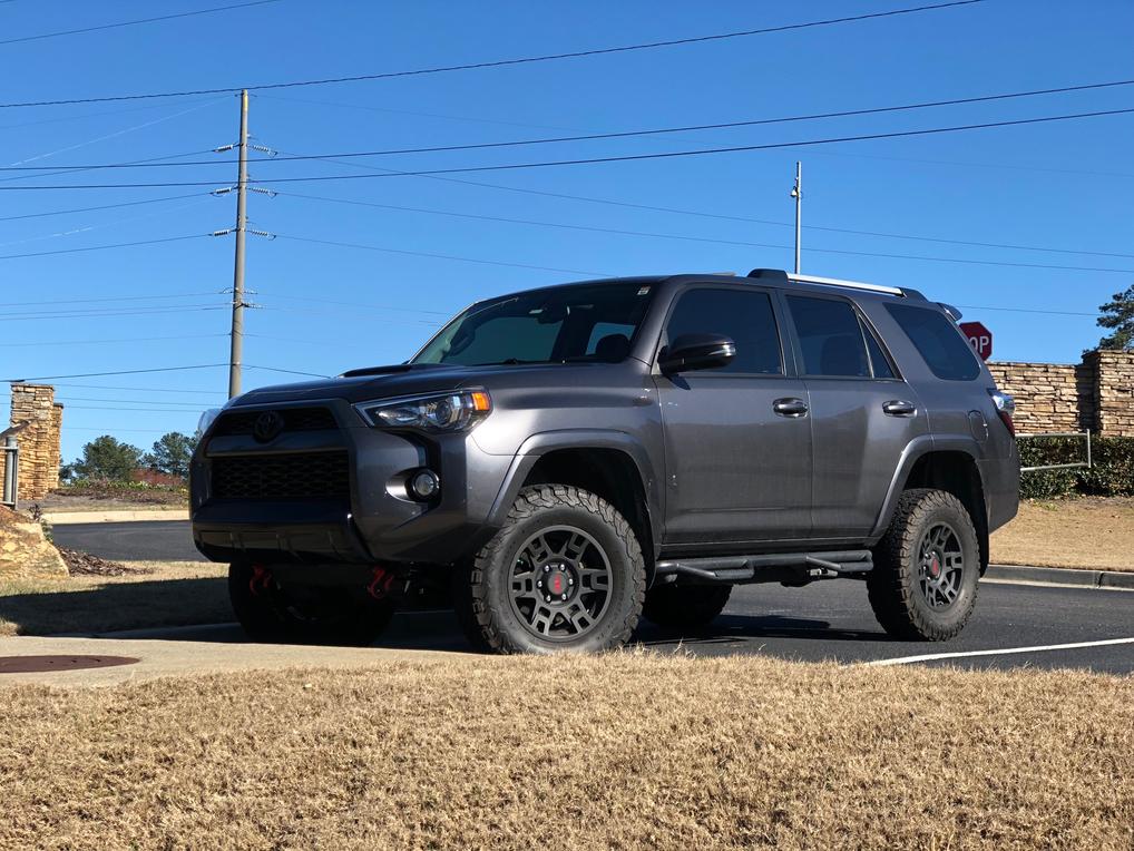

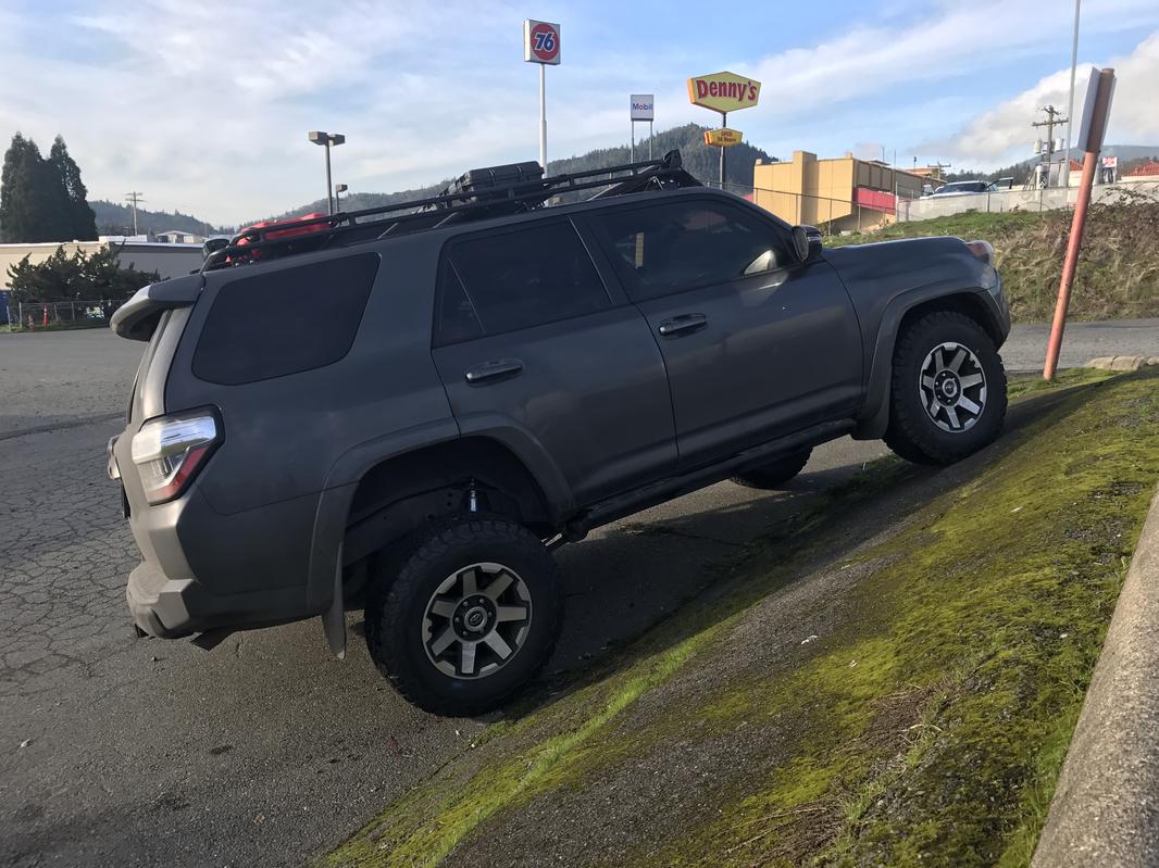

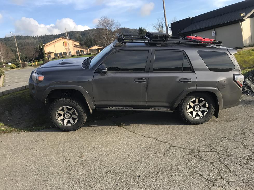

Powdercoated Trail Wheels
Then got the Trail Wheels Powdercoated

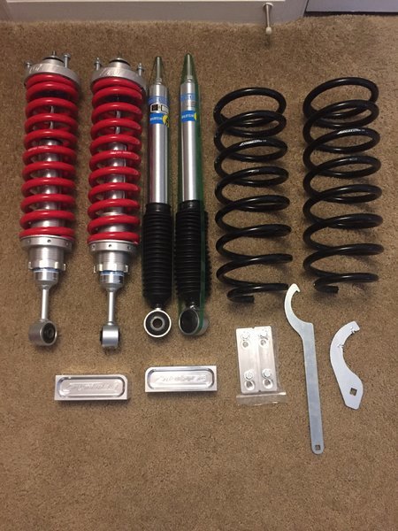

Not a fan of SPC at all. I don't like their ball joint design and see a lot of ball joint failure with low mileage. So far I'm sold on JBA Simple, 4+ degrees of caster, over the counter ball joint with more than enough flex for anything i'll ever do. Only thing I don't like about them is the red paint but that's an easy problem to solve.
I just ordered these, I got the red, but you have the option of black as well. They are super nice quality!!! Will update with pics in a couple weeks when I put everything on!!

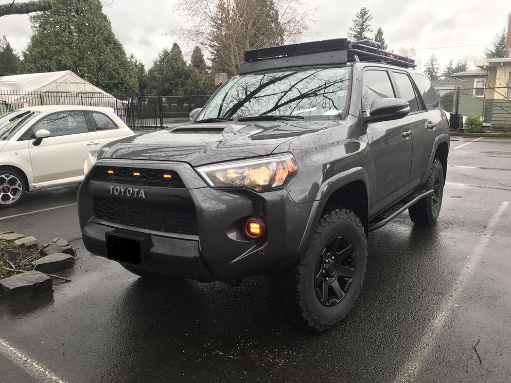

3"/2" Toytec/Bilstein with TC UCAs. Turned out to be a little more work than I hoped. The rear was the real pain. I'm sore af. After I finished I discovered the infamous lean, so just ordered a 1/4" front spacer. Will have to wait on the alignment a few days. It feels and drives great though.
Yes it's still on 265s. Will go up to 275 or 285s and new wheels once these wear out.

You didn't get the adjustable front coilovers from ToyTec so you can just adjust them for the lean?

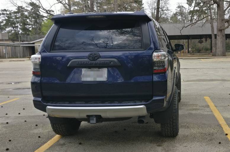

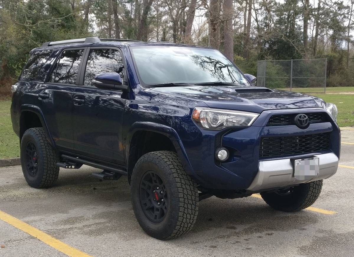

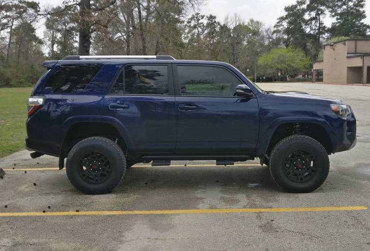

2014 TEP in GA
3" procomp lift/level kit, stock TRD Pro wheels, 265 KO2s, TRD Pro valences, nfab side bars, HID headlights, dynamat xtreme in all doors, front window tint, blackout emblems
