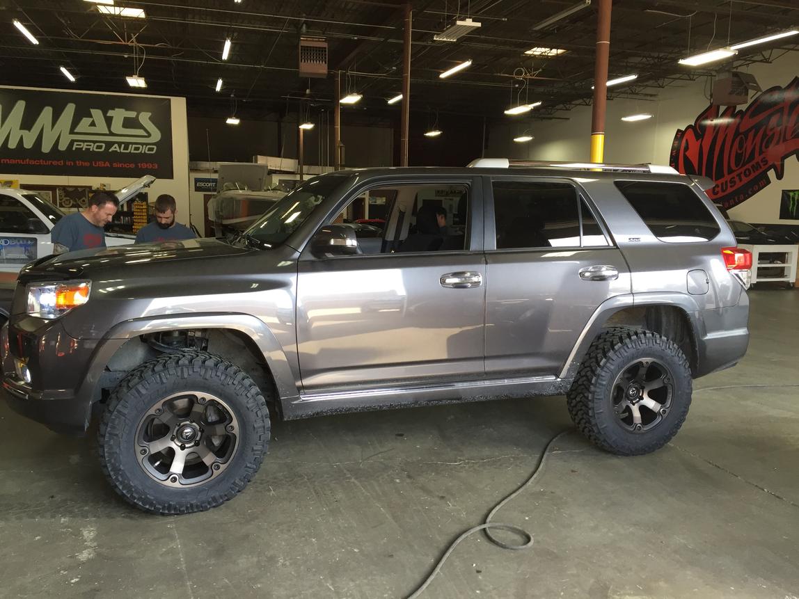

After about 8 months with my first 4Runner I finally got around to some mods. 3" lift with new Fuel Beast 18's with Nitto Trail Grapplers. In the process of blacking out all the chrome. Next will be N-Fab nerf bars then Gobi Stealth Rack.
2010 SR5 | 3" Daystar | Fuel Beast 18x9 | 285/65/18 Nitto Trail Grappler
Any issues since you put these wheels on? I just ordered the same wheels, but 17x9. Do you have any pics from the front or back of the Runner?

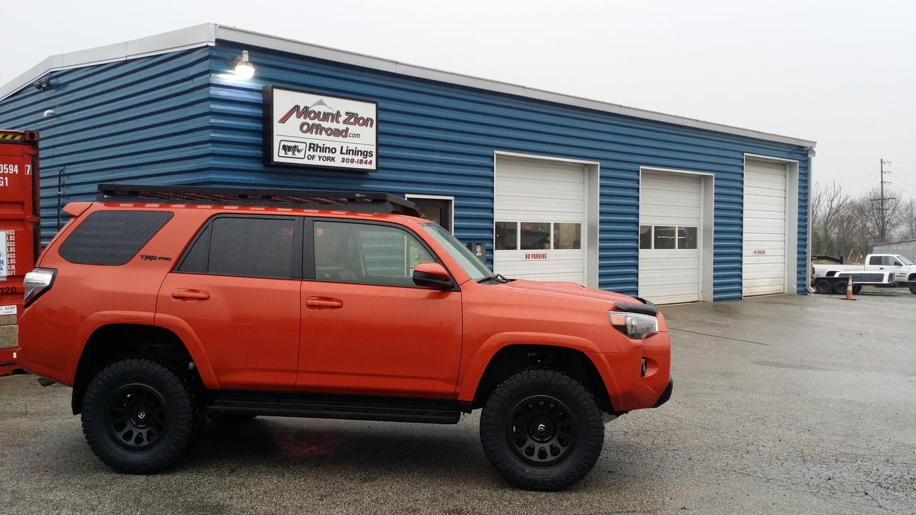

3" procomp lift/level kit, stock TRD Pro wheels, 265 KO2s, TRD Pro valences, nfab side bars, HID headlights, dynamat xtreme in all doors, front window tint, blackout emblems
Looks great! do you happen to have any straight front/back stance pictures?

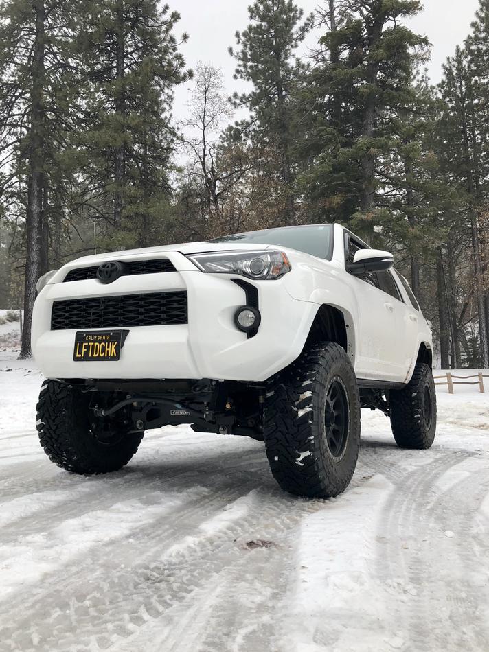

Just got my Pro Done last week. Toytec TRD Pro Lift 33x12.5 Ridge Grapplers.

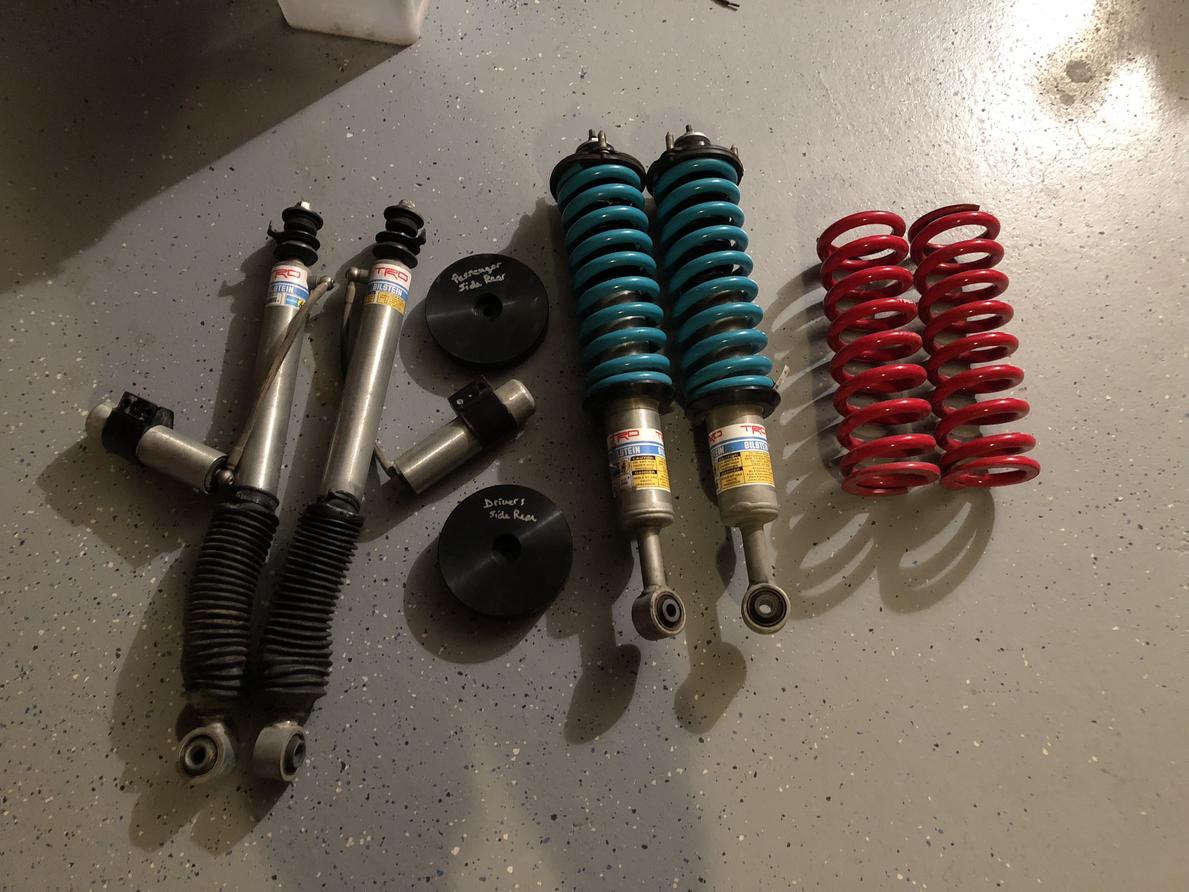

Level kit
2 inch spacer in front with 2016 Trd struts on my 2012 sr5 with 1 inch cornfed
rear spacer with trd Bilstein with resivour

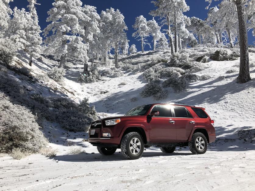

Toytec 3” with Bilstein 5100’s, SPC Arms and 285/70 Ridge Grapplers on factory TRD Pro wheels.
Loving it so far.
Hey can you add the link to the 3" kit you got? And how do you like the daily driver aspect of it so far? Have you done any off reading with this setup either?
Thanks!
Sent from my SM-G955U using Tapatalk
Thanks!
It is this lift here 3" Lift W/ Bilstein 5100 Front Coilovers FJ/4Runner/GX
On my previous 4Runner I had just the 5100's on stock springs. This lift is a little stiffer but in a good way. The bilsteins take most of the nose dive on braking away and the Toytec springs make it a little less wallowy (is this a word?) than just 5100's alone.
Also with the lift coils in the rear vs. a spacer it seems to squat less when loaded, but I don't have any measurements from my previous ride to confirm this. These are the standard rear coils not the HD.
I haven't taken it off road yet. Just got the truck a few weeks ago and have been adding parts. I did crawl some curbs to check clearance and ended up removing the mud flaps due to rubbing.
