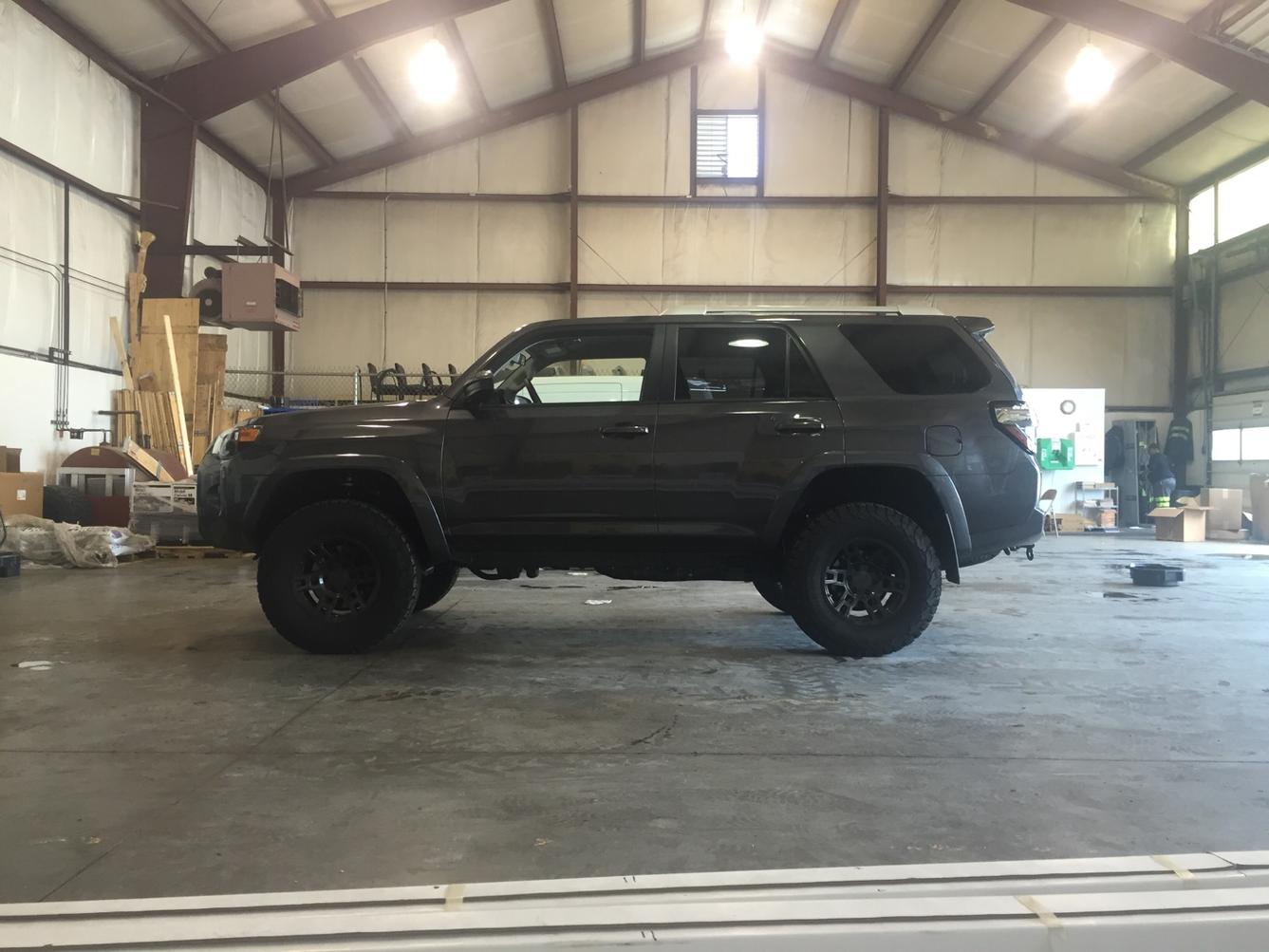

2" Icon Stage 3 Lift

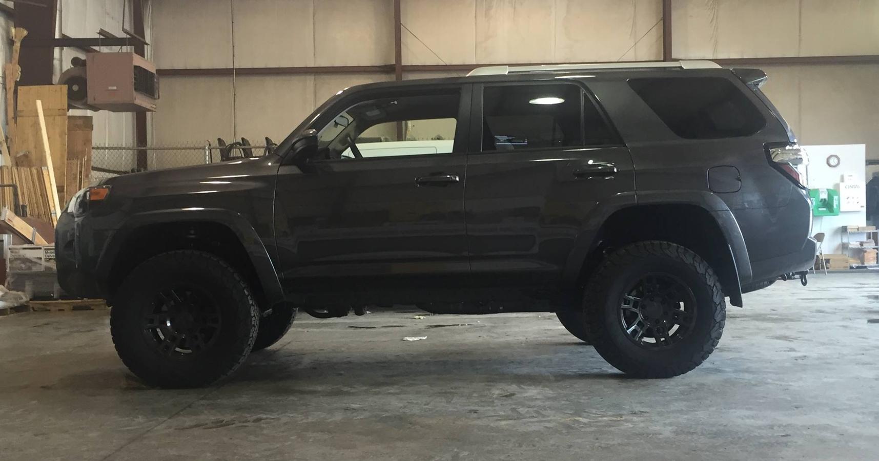

Yes, have had it for about 10 months and 7500 miles, no complaints at all. Just add a 3/4" spacer to the back if you plan on going 3" up front to avoid negative rake. Below are pictures without the rear spacer and with. The rear end squat drove me crazy.

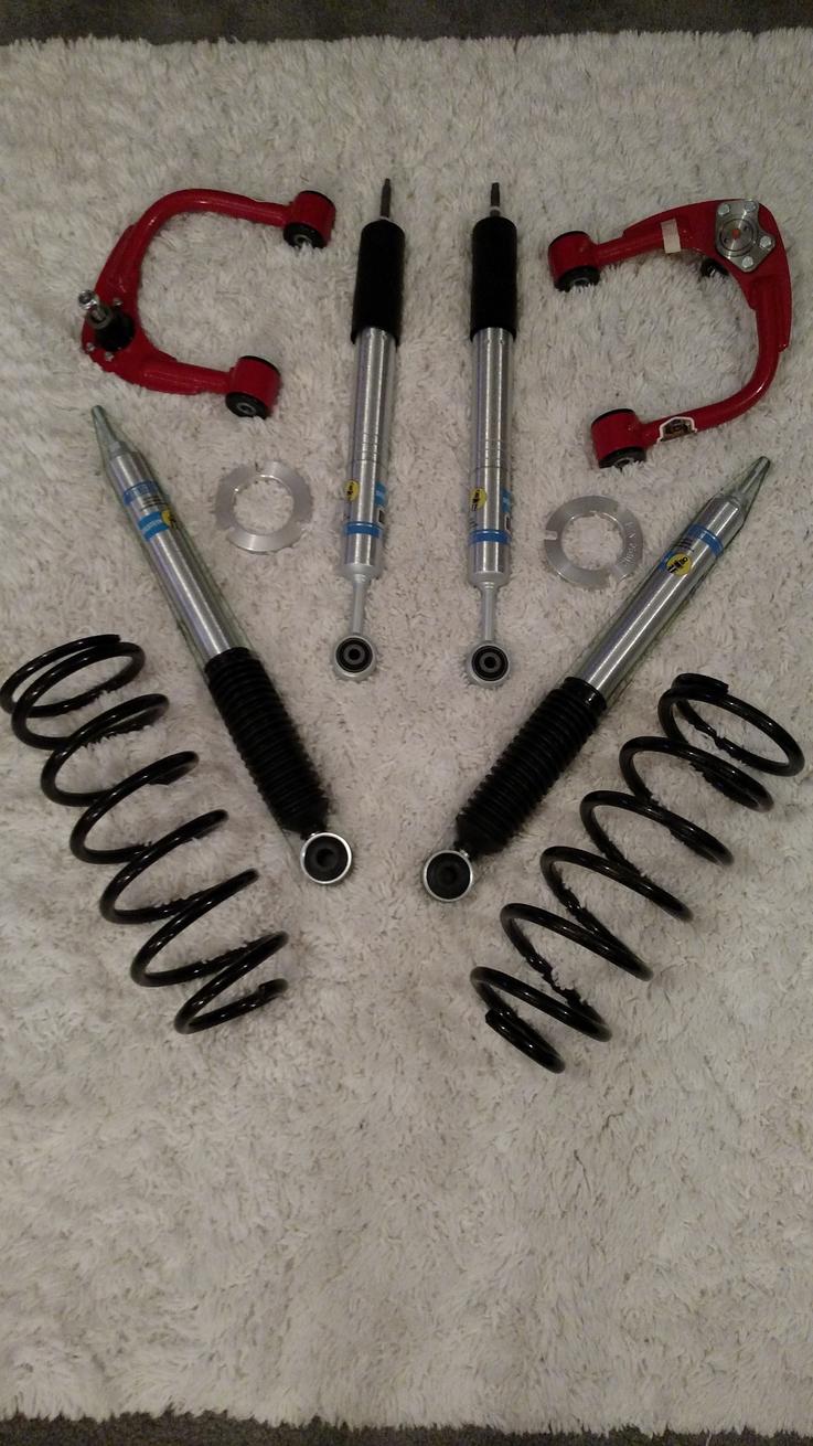

Front Bilstein 5100 Shocks
Toytec Ultimate fully adjustable coilover
SPC UCA
Diff drop
Rear Bilstein 5100 shocks
2" OEM medium load rear coil
Toytec bumpstops
Pro Comp Predator 17" wheels
Duratrac 285/70R/17 tires
Did the install myself this past weekend. Front 100% alone and the rear I had some help for most of it!
