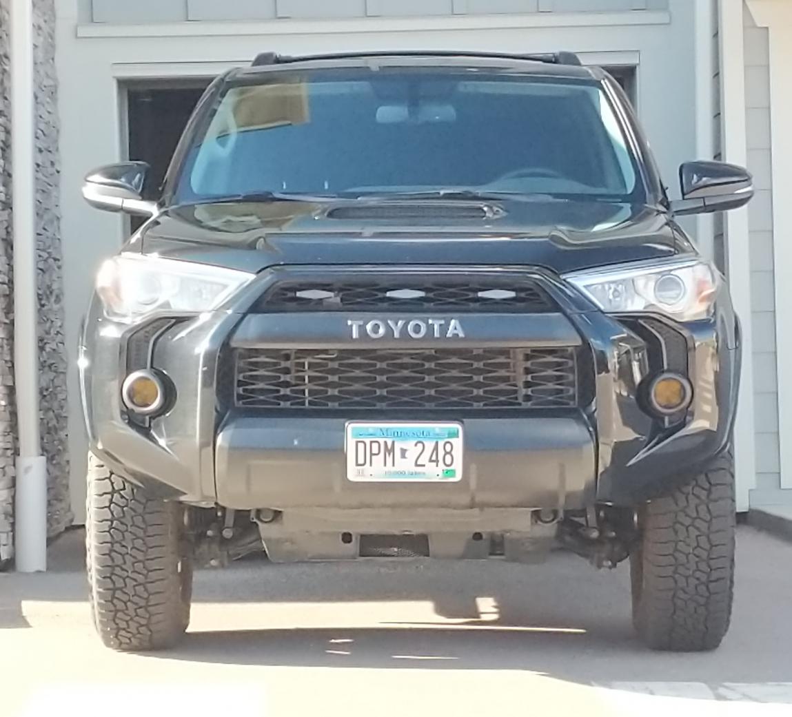

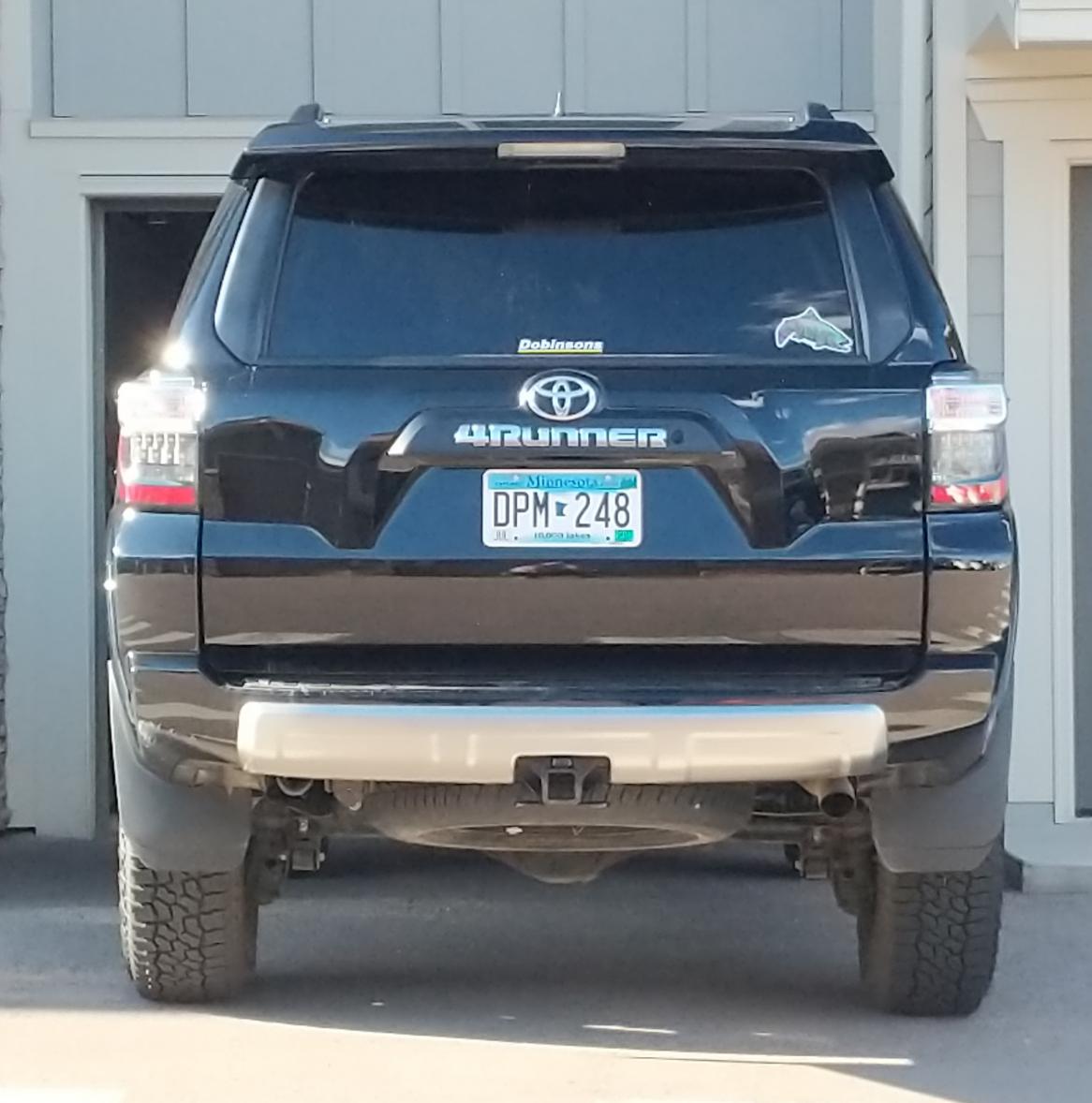

Just got the tires installed today! Dobinsons IMS 2.5" front/2.0" rear, with Freedom Offroad UCA's. Falken Wildpeak AT3W in 255/80R17
Looks great and that's the same set-up I'm looking to add to my 2020 TRD OF. Do you have any pictures from the front or back so I can see how the tires look? Concerned about the width.

I'll get some in the next few days. Overall it looks quite factory from the front and rear!

Here is a front and back photo, no spacers installed.

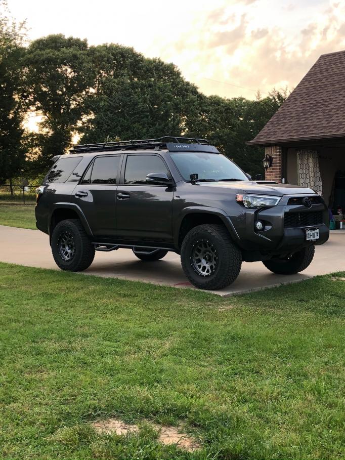

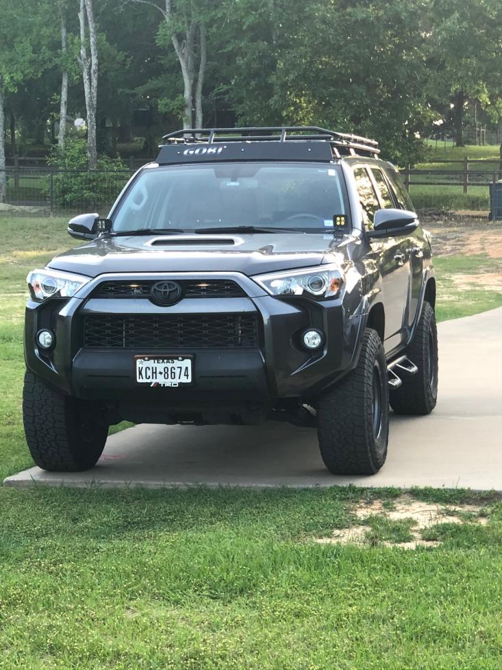

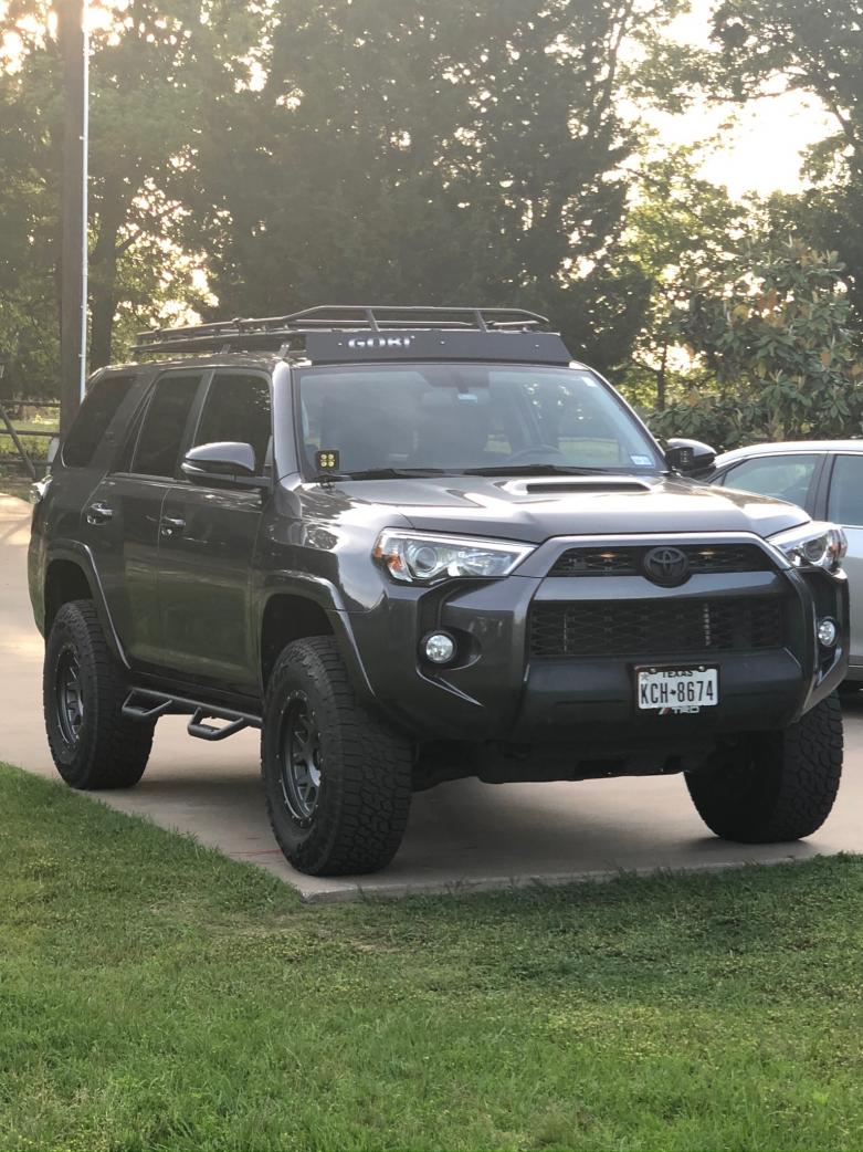

Here’s mine:
Eibach Pro Truck 2.75"/1" Lift
Pro Comp 17x9 -6 offset Vertigo wheels
285/70/17 Wildpeaks
No rub issues

Any fender liner/body chop mods needed with this set up? And did you also get UCA?
Yes, there was a slight cut that they had to do just in front of the front wheels. It was maybe an inch or two cut off the bottom front of the fender. It is almost unnoticeable. I have no rubbing whatsoever. They also installed SPC Adjustable UCAs.
