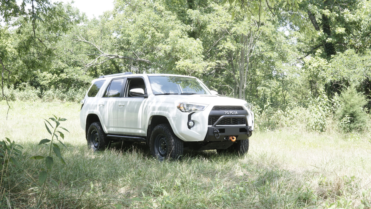

Beefy
Top = Stock
Middle = Lift w/ stock tires
Bottom = Lift w/ new tires
6112 set to 1.6", Rear Dobinson 1.5" coil. Full setup is in signature
<a href="https://ibb.co/f4bGzhj"><img src="https://i.ibb.co/xJy8tpx/Runner2.jpg" alt="Runner2" border="0"></a>
<a href="https://ibb.co/PZ9Yt1x"><img src="https://i.ibb.co/0jFXQYq/After-no-tires-side.jpg" alt="After-no-tires-side" border="0"></a>
<a href="https://ibb.co/b1hmDHs"><img src="https://i.ibb.co/ZdsX7HB/Complete-Side.jpg" alt="Complete-Side" border="0"></a>
Im about to install the same set up. How many threads of preload do you have on Kings up front and what center hub to fender measurements do you have for both front and back in this Photo? Do you like those Icon springs...any lean? Rig looks great. Thanks.
Hey thanks man! My apologies for the late response, but I have 7 threads on the FRONT LEFT and 8 threads on the FRONT RIGHT. Center hub to fender measurements are 22.5" Front and 23.25" Rear. No complaints with the Icon springs. They feel great and I think you'll like them. Also, no lean on my rig. Hope this helps!

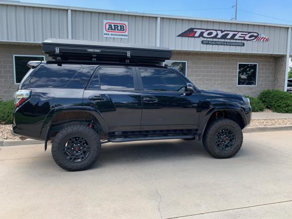

Finally able to post in this thread. Got the Bilstein 5100's on all 4 corners with Wheeler's T1 & T13 coils. Also used the top hat spacer and rear trim packer to level out d/s lean. Tires are 285 Falken Wildpeak. Rides and looks better than expected.
How's the ride with this setup? I'm thinking about going this route

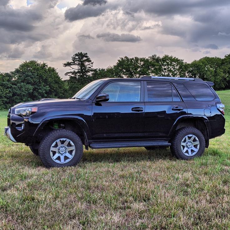

Added 285\70\17 tires today. Gained about ¾ of an inch on the rear, and ⅝ inch on the front on the 2F\1R lift. Funny because now it looks stock in pictures, but can easily tell it isn't in person
