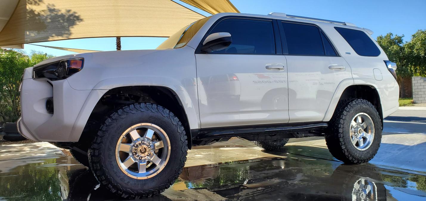

Added 285\70\17 tires today. Gained about ¾ of an inch on the rear, and ⅝ inch on the front on the 2F\1R lift. Funny because now it looks stock in pictures, but can easily tell it isn't in person
Those tires look awesome. How's the ride? I feel the same way about my truck in pics. Looks just ok at times, but definitely not stock in person.
Thanks ! Compared to the Nitto Terra Grappler SL load in 265/70/17 I had on before it is now a much rougher/stiffer ride. Can feel the more aggressive treads in the steering wheel, and it's also quite a bit louder, but expected being that these are E load and much more aggressive. I do feel more sluggish because of the weight, but can still get up and go when needed thanks to the SC. Also because the tires are much stiffer, it's kind of cool to feel more of the suspension working rather than a mix of the suspension and tire flexing. I like knowing I have much stronger tires now, overall pretty happy with it. Need to go test them out off-road soon

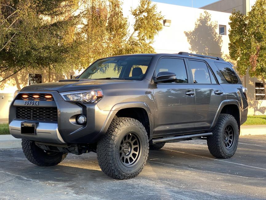

I posted this yesterday in the Method 703 thread (Icon Stage 2+ for suspension; Method 703's with 285/70/17 KO'2s):
researching mods for my new 2021 SR5, with the Icon stage 2 and 285s did/do you have any rubbing?
Yes. Full lock in reverse only. Very minor, but it's the thump-thump-thump of tread blocks hitting the body mount area. Easy to daily drive still, which I'm currently doing.
I have front mud flaps removed.
Front Icon ET 2.5's are not at highest setting.
And I have alignment on the Icon's set to stock tolerances.
So I suspect that EITHER raising the front Icon's to full height, OR going with Caster changes in alignment (4.0+), will resolve the issue. I'm going with the alignment change first (and not trying to "lift" myself out of the rub). Might be a few weeks before this happens (work schedule ya know).

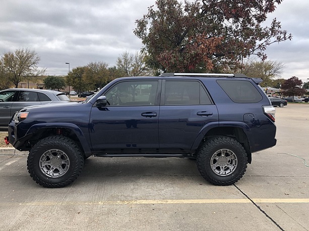

Finally got my upgrades complete. Lift/UCA, front bumper, wheels/tires and sliders. Only took me 4 years...

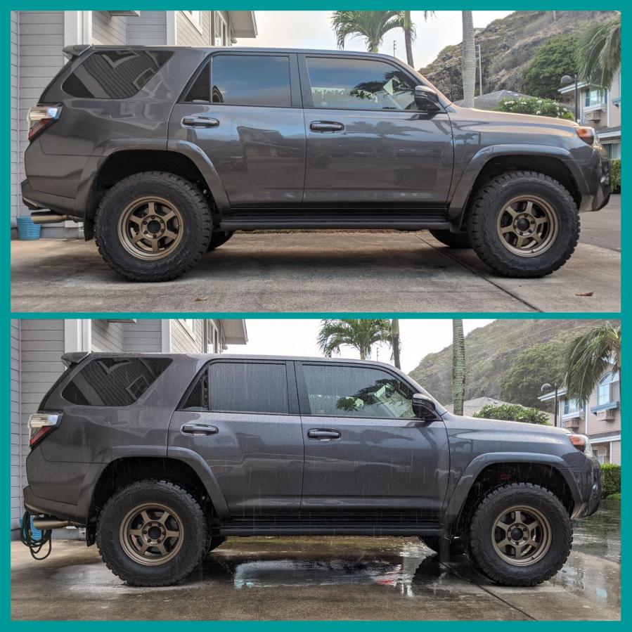

Swapped out the 4Runner TRD Pro springs and ToyTec 1inch perch for TTUE TRD FJ springs. After talking with some members here, and researching stock non-Pro measurements, it seems the old setup wasn't giving me the 2inch front lift I was going for, it was more like 1.5inch. Now with just the TRD FJ spring it's sitting right around 2.25inch up front.
Before measurements with TRD 4Runner springs + ToyTec 1inch perch:
Front Driver From Center Of Wheel 21.125
Front Passenger From Center Of Wheel 21.25
Rear Driver From Center Of Wheel 22.625
Rear Passenger From Center Of Wheel 22.75
Now with TRD FJ springs + stock perch
Front Driver From Center Of Wheel 22
Front Passenger From Center Of Wheel 22.125
Top picture is old setup. Bottom picture is new. Both in same tires, Toyo Tires RT 285\70\17
