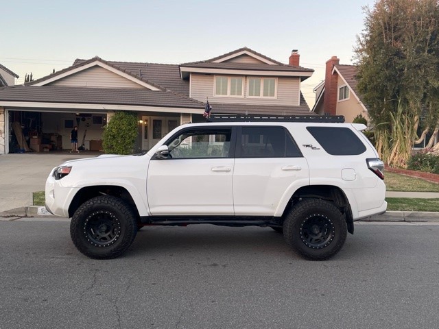

Here i my 2016 lifted.
OME BP51 lift, Falken wild peak 265 70 17 tires, RRW RR5-S wheels with -12 offset in gunmetal grey.

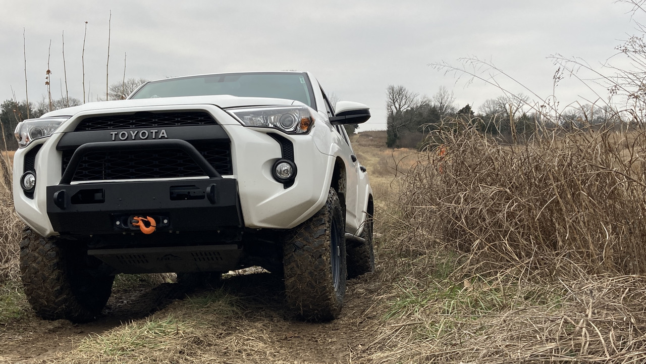

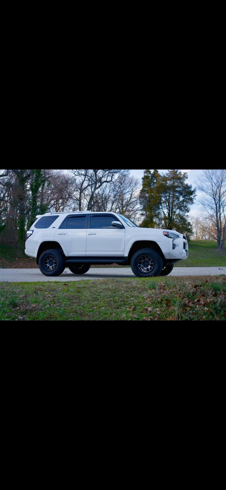

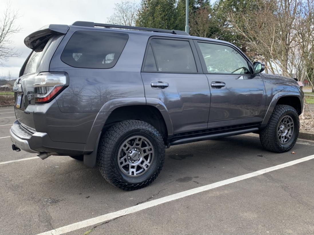

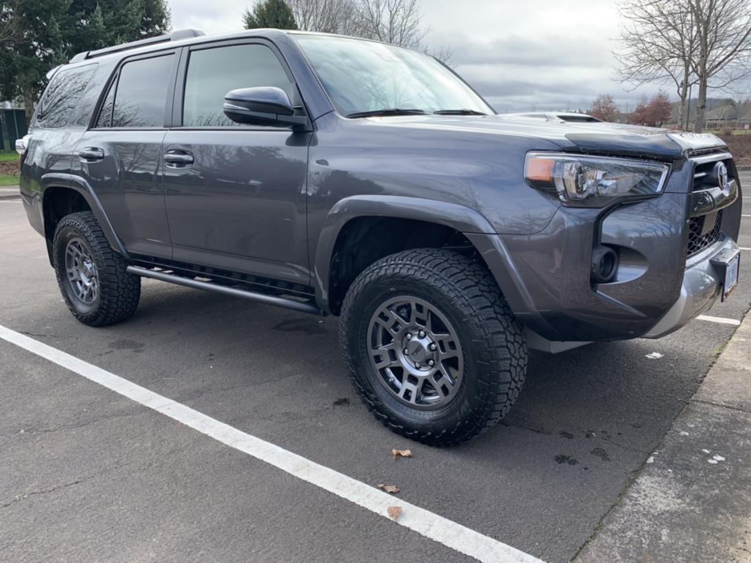

OEM TRD Pro suspension with 1.5/1” Cornfed spacers with 285/70-17’s on factory Pro wheels. No other modifications required.

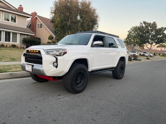

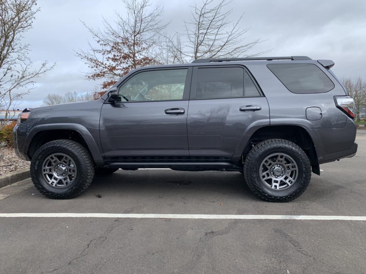

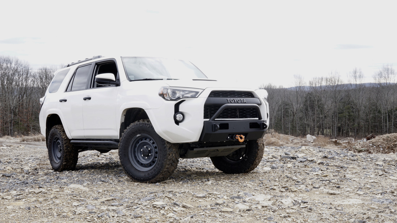

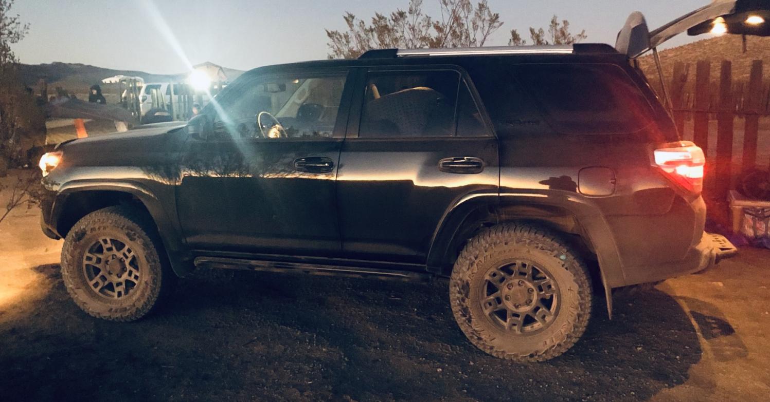

Here’s my Bilstein 6112/5100 setup. Gained 2” Front & 1” Rear w/ coil. OE UCA’s aligned within spec w/ 2.9 caster on both sides. No squeaks, improved ride and happy CV’s. Added 265/70/17 Falken AT3W in SL and have not noticed any drop in mpg. Very happy with this result for a DD.

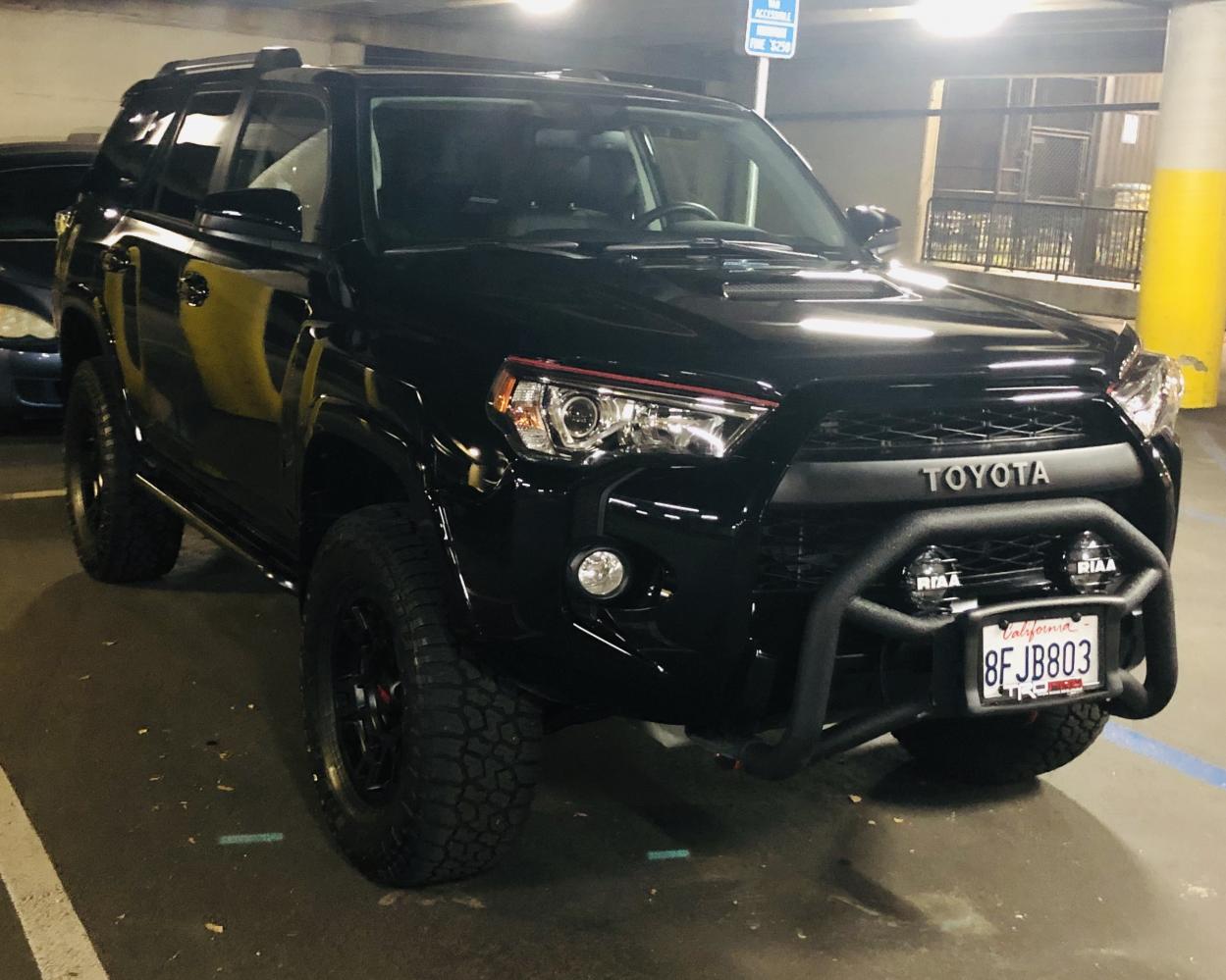

Dobinsons MRA 3"/2", Dobinsons UCAs, Falken LT 285/8.5/0
