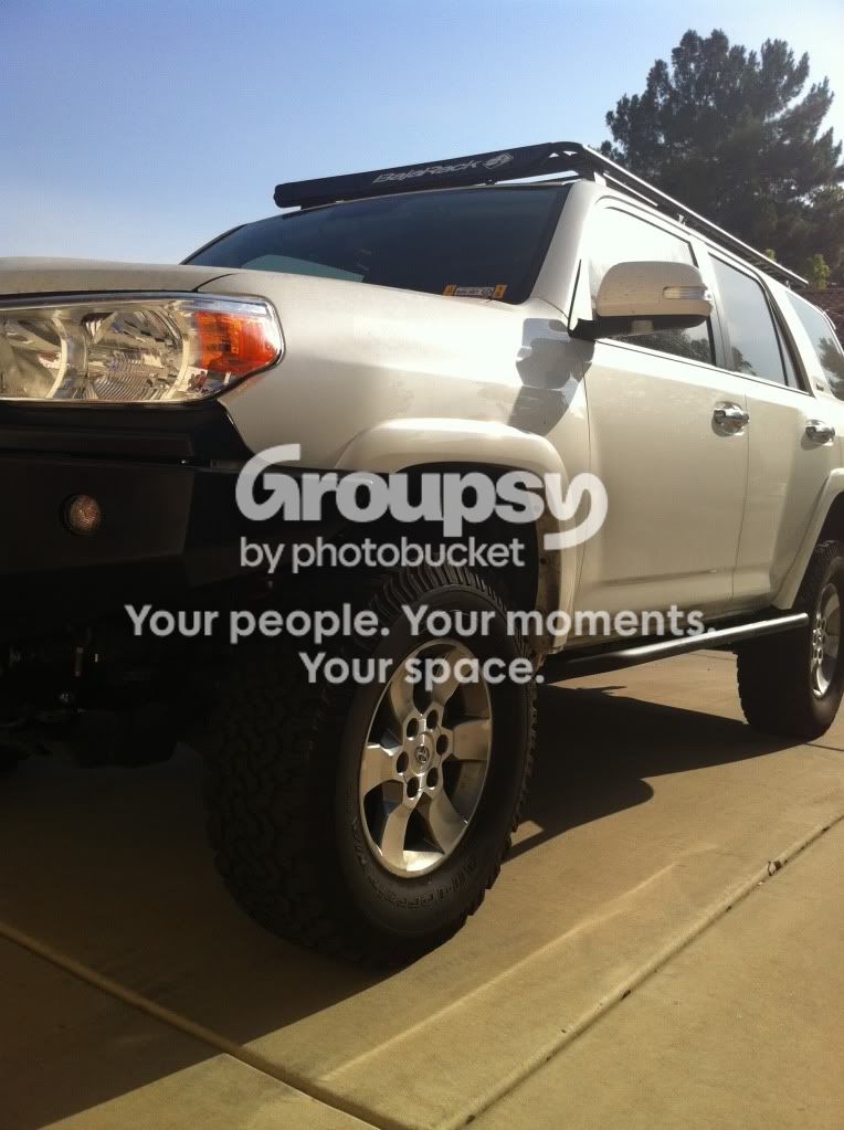

Can u explain what's going on with the slider install. It looks like the rocker panel trim piece has been removed - what is that trim piece on the front fender just in front of the slider?
I've got a set of BAMF sliders on order for my wife's new '13T4R and trying to figure out if that's a trim piece I need to buy...
Thanks,
David
The rocker has been removed and replaced with the shrockworks trail edition rocker. No cutting or hacking to get these to fit into place and gives a clean finished look.

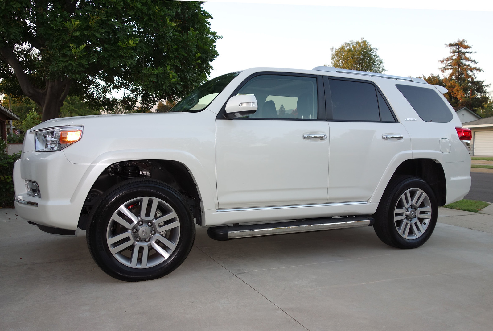

Just put my lift on and hope this before and after picture helps people interested in the same setup.
2012 TE w/ KDSS
Front - Bilstein 5100 set at 2.5" w/ stock springs
Rear - 1.5" spacer w/ 5100 shocks & stock springs

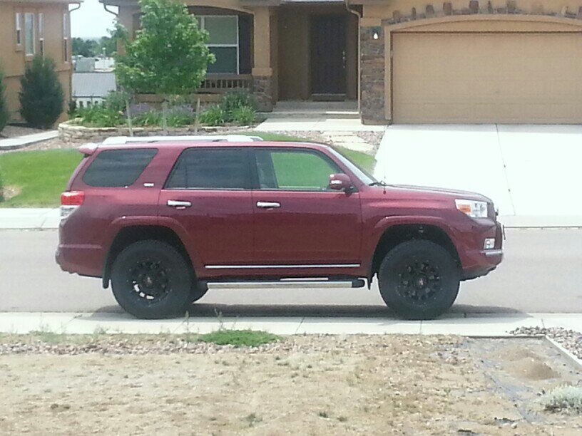

Finally had some time to complete the lift this weekend. Front lift is a combination of daystar 1" budget boost + 1/4" polyurethane spacer. The rear lift was Sway Away coils.
In the end, I got about + 2.6" up front and + 2" in the rear.

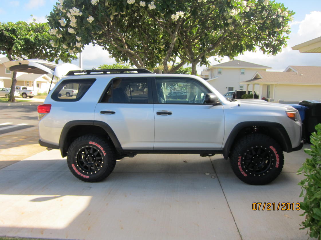

New to this forum, but it has helped me out tremendously. Here is my T4R Trail with a brand new lift and tires. The story behind the tires is that when I purchased them I did so without reading this forum, if I had I would have ended up with 285/ 70 R17's and not the 275 70 R18's that the salesman recommended. In the end I'm pretty happy with it, but we'll see after I take it off the pavement. Hopefully pics of this size tire will help somebody else decide. Had to remove the lower portion mud flap for now due to rubbing.
