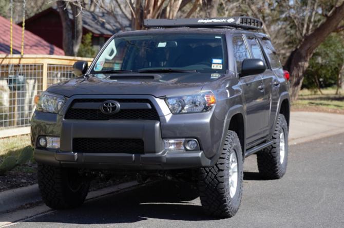

Need some help choosing the right tire size so that I don't have to cut mudguards because or rubbing. Thanks

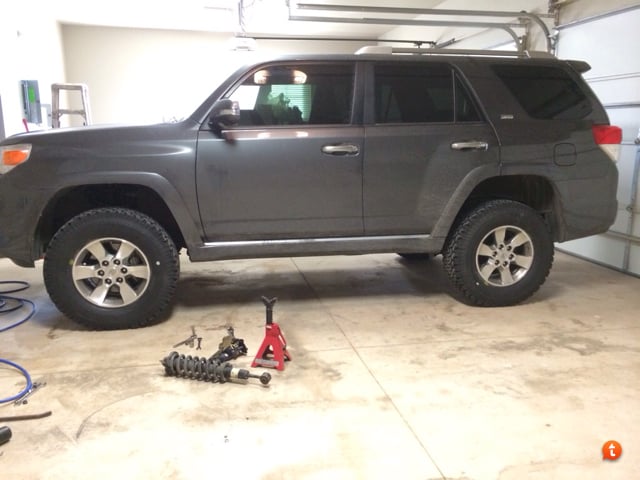

Another Icon Stage II
here's another Icon Stage II with Duratrac 285/70/17s, Shrockworks sliders and a Shrockworks skid in the garage going on next.

Icon Stage II was installed last week. Budbuilt sliders are en route and a 20" Rigid E-Series is going in behind the grill Thursday.:reddance:
Sorry., off topic, but is that the same mark miller license frame from slc, Utah? Just wondering, that's where I bought my 1997 SR5 a long time ago.

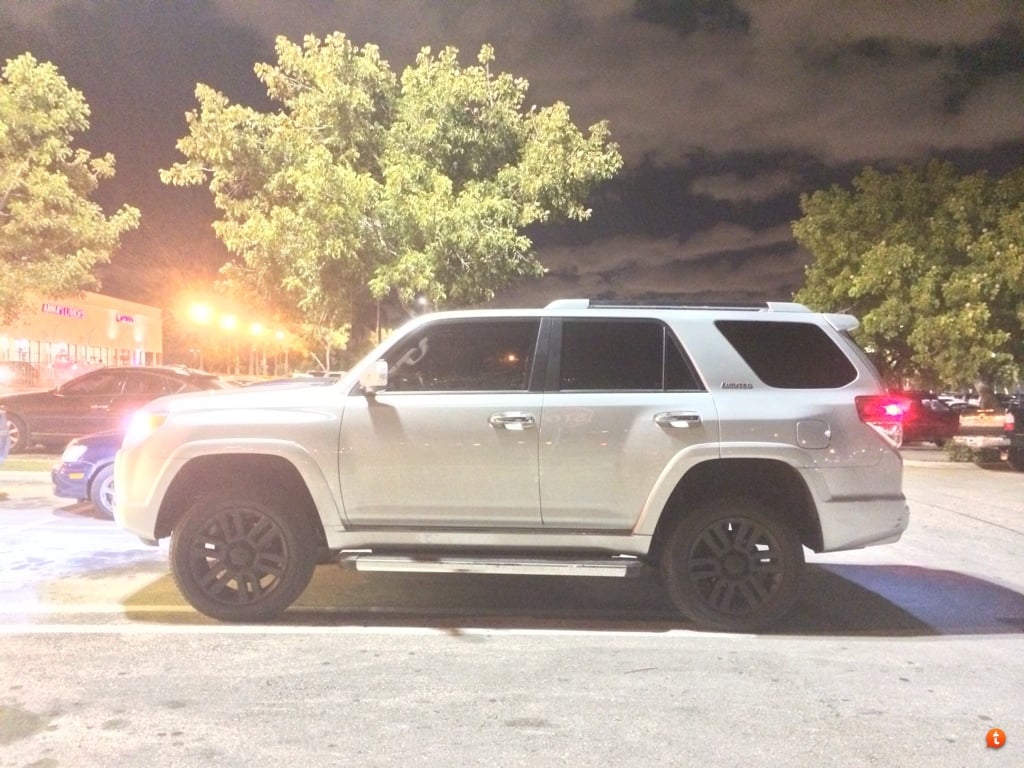

38" front 38 1/2" rear, 5100's at top notch, rear 1" spacer driver side only with radflo 2.0 shocks. opor sr5 sliders, 275/60/20 Cooper ATP, 20X9 xd hoss -12 offset, rigid grill w/sr20, air dam removed, that's all for now.
HEY! I've seen this thing running around west Norman. I'm off of 36th and Rock Creek. It looks killer in person!! I'm in a pewter 3rd gen lifted with black wheels and 33s, and a steel whip antenna on the roof. I'll flash you next time I see you. Cool truck man!
Yep, that's where I bought it. NJ dealers wouldn't bring in a TE with KDSS, so I shopped around and made a trip out of it.

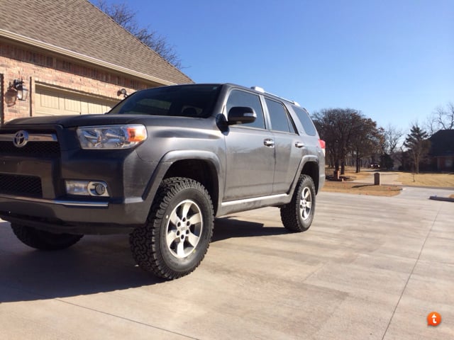

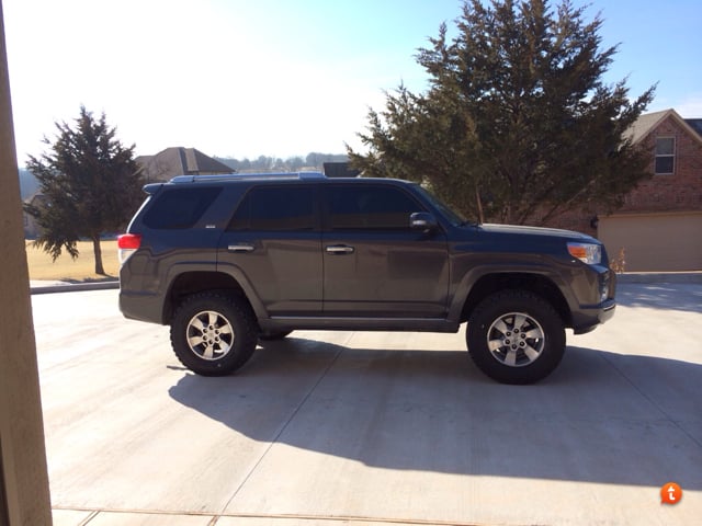

Started mine last night and finished up this morning took me 5hrs to do 100% by myself. Specs are in my signature. Getting it aligned as I type this.
It lost 75% of the body roll and nose dive. Drives really good without the alignment so hoping it gets even better.
Update: NEED UCA's - could only get 2* on passenger side and 2.4* on drivers side. Honestly feels pretty stock at highway speeds probably due to the stiffer springs, but I'll be doing the UCA's after March.

Looking good! I'm going out to Camp Gruber ORV park on Sunday if you want to break her in, we can meet-up.
Looks Great! How hard was the install? I am still trying to make up my mind if I want to attempt my own. Would have to be done at night while all the kiddos are asleep.

For me pretty easy, but... all depends on your mechanical ability and what tools your have. All in all not terribly hard, but my first time to do it. I could cut a good 2 hours out next time and more if I had someones help to help with grabbing tools and disassembly.
Here is my schedule that it took me to do
6:30PM - make dinner for kiddos
7:00PM - Start rear end
7:30PM - Bath kiddos
8:00PM - Finish Up rear
9:00PM - Start Front Passenger - bit of a learning curve here cause i've never done one before, but its not hard - just had to learn as a I went.
12:00PM - Finish front Passenger - Should have only taken 1.5hrs not 3.
8:00AM - Start Driver Front
9:15AM - Finish Driver Front
9:45AM - head for alignment shop
