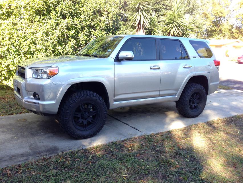

Has anyone used the RevTek Kit 432
Revtek Suspension | Toyota Suspensions
Yes, I currently have this setup.
I remember reading a post by [MENTION=98089]c2one[/MENTION], when I was looking at this setup last year. I think he did not recommend them (don't quote me), or maybe he was happy with them for what they were. I do remember him suggesting to just go Bilsteins.
You are right, I do not recommend putting on a 3" spacer on the front. Going over speed-bumps feels like my shocks are fully extended and makes a loud 'bottoming-out' noise. Plus no help at all with the nose dive.
Save up a little more and get Bilsteins.
Nothing wrong or bad to say about Revtek... just having a 3" spacer on the front, in my opinion, isn't good.
So now I am saving up for a different lift and new UCAs.
and since this is a picture thread. Here's mine w/o my roof rack... :nerd:
Thanks for the heads up. Where about in Texas u from?

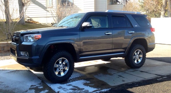

One month into ownership and got the truck lifted. Just goes to show you what a few beers with a friend and a LOT of dirt in my ears and eyes can accomplish!
How do you like the Boss suspension overall? Any feedback would help since this is first on my lift list. Seems like a great value and performer.
