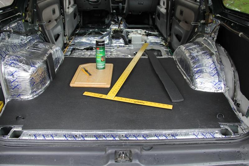

Just about finished with my acoustic installation, spray dead, and carpet upgrade. Ready to begin building my wiring schematics for a pure sine wave inverter and begin running the wires before I close up the panels.

Closed Cell Foam
Sorry for the off topic question
What's the black may you're using in there?
No problem. It's 1/2" closed cell foam. You can see a few other pics here:
http://www.toyota-4runner.org/3rd-g...ou-do-your-3rd-gen-today-683.html#post1979663
Used Spray Dead, 80mil Rattle Trap, 1/2" closed cell foam, jute with carpet. Not entirely but mostly in the cargo area and the back seat area. I'll get a thread going on that when I get a bit of time. Trying to get the schematics down for a solid inverter before I close everything up. Want to do it right the first time with no regrets.
