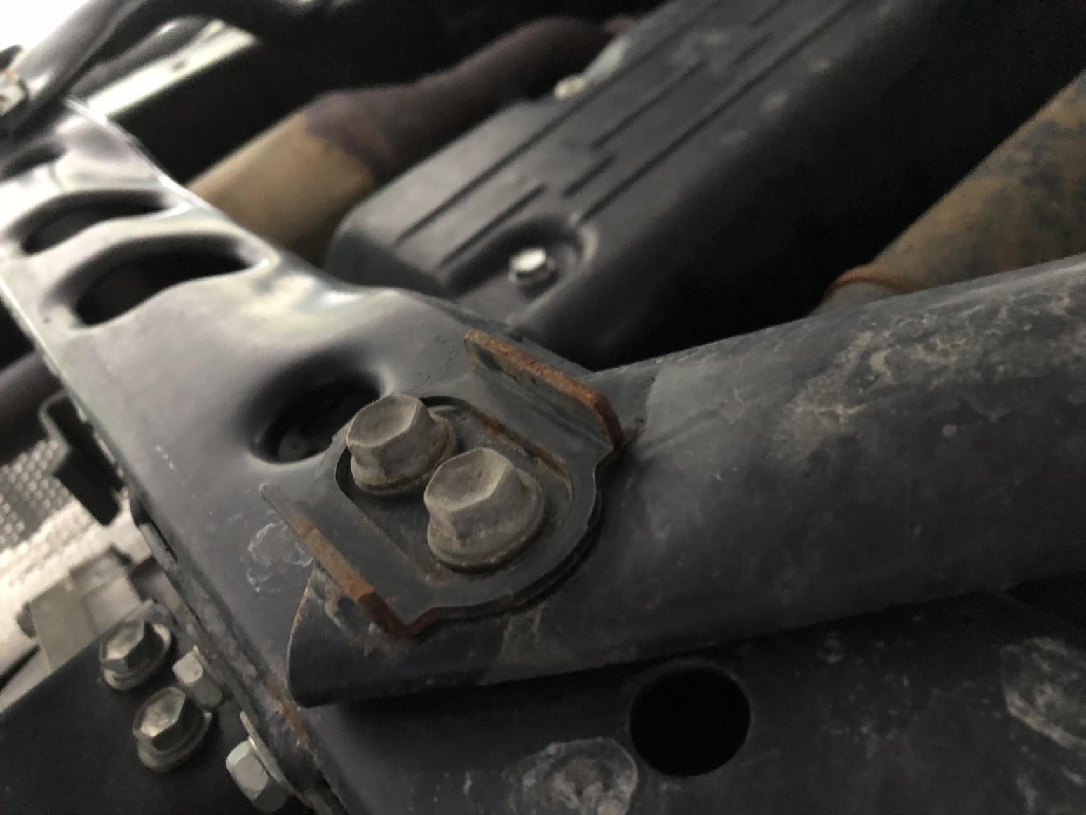

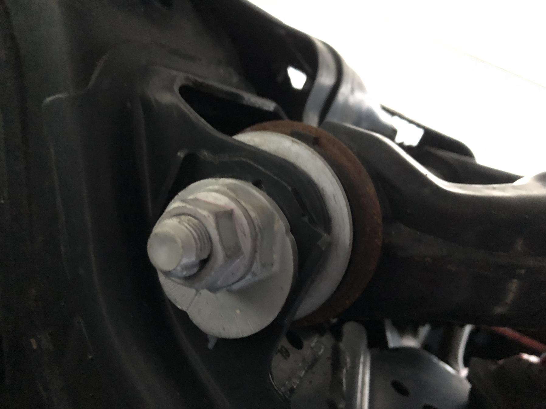

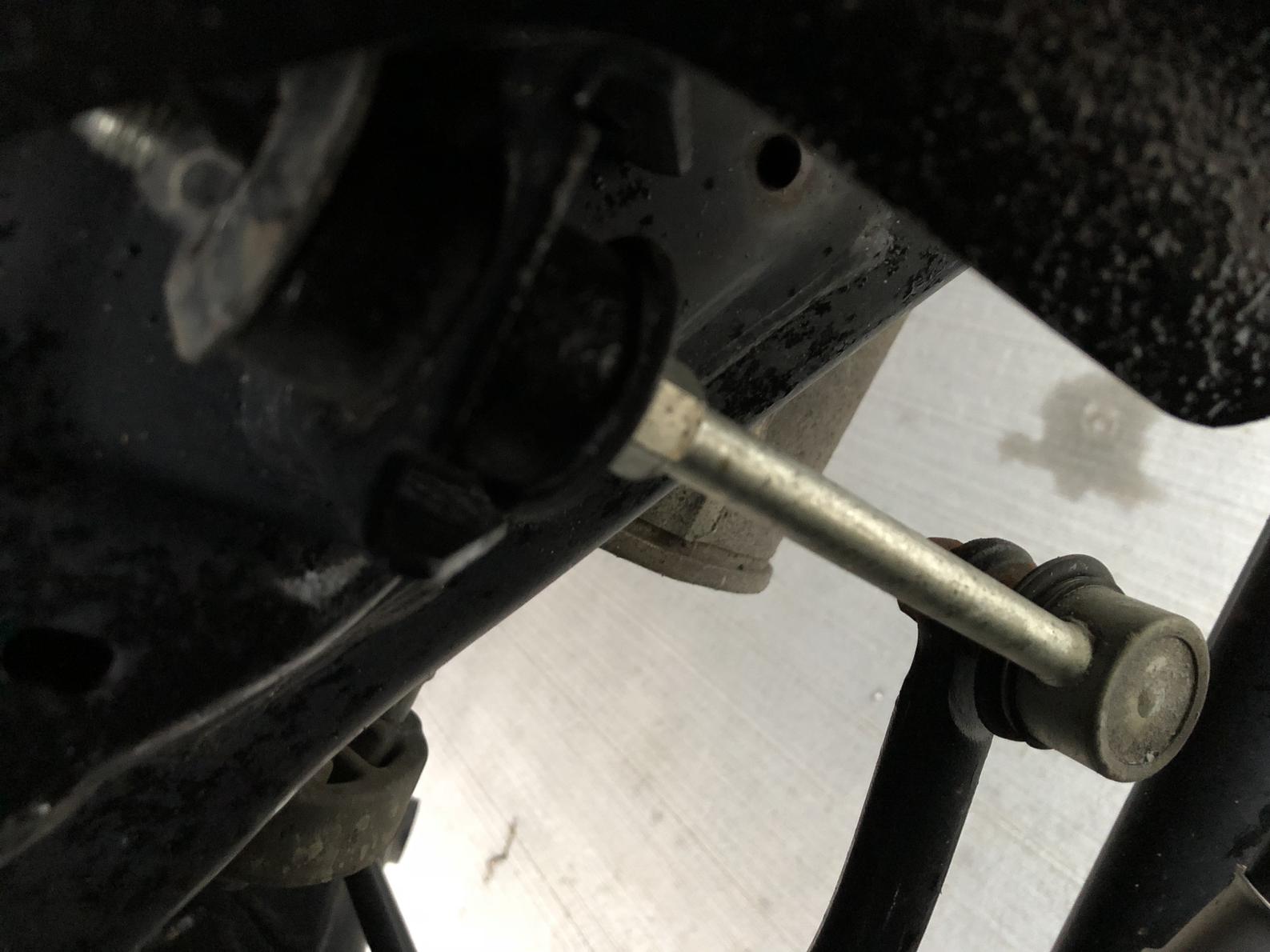

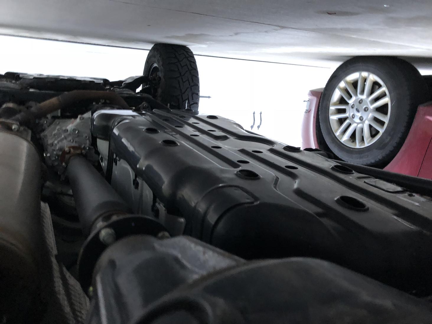

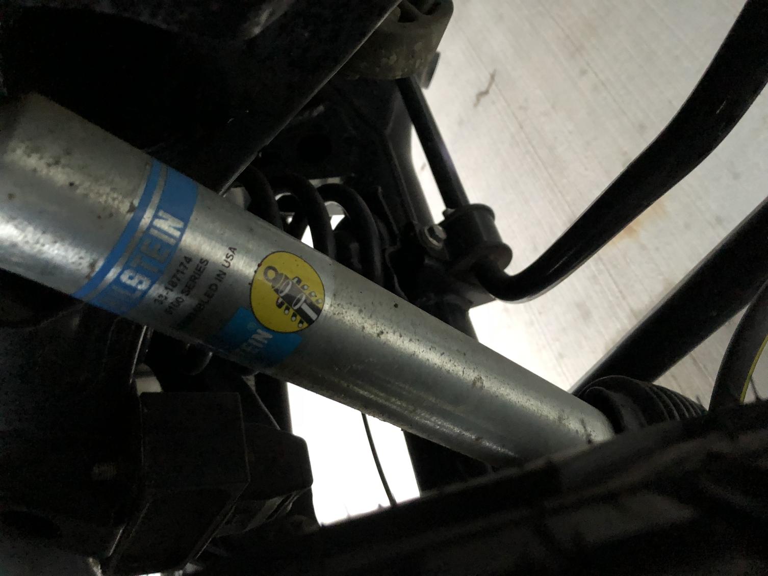

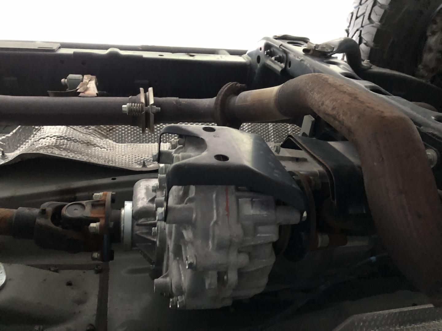

So - with all this talk about maintaining, I decided to crawl under the 4Runner for an inspection, you know, expecting to see endless rust because I “didn’t maintain it.”
Bilsteins look 1000x better. Little bit of surface rust but nothing remotely close, a lot is dirt and needing to be wiped down. Lots of oem nuts and bolts look perfect, as do the skid plates. Rust on exhaust which is pretty standard. Overall, the underside and bilsteins basically look exactly like I’d expect. Toytecs are the only thing I found that look like shit.
Uniballs have some very very light surface rust in a few spots but doesn’t really concern me at all. Washers at the thru bolt are a bit rusted. The fact that Toytec said the uniballs were “pitting” is hilarious though. Sounds like the people at work that can’t fabricate worth a shit. Instead of acknowledging that they messed up, they instead start pointing out others issues, as if it somehow makes their shotty workmanship ok.

If anyone thinks my underside looks like it was in “excessive” conditions, please let me know...

Im not sure why the nuts on top of the coilovers would be so rusted, and the washers for the UCA’s look to have similar rust as well. OP, you mention rinsing with just water, here in CO if we get mag chloride on stuff we can’t just use water as it never completely removes the “salt”, you might have been in better shape using a mild chemical to remove the salt.
I have had my Toytec CO’s for now my 4th CO winter and they look just fine, but then I don’t have the remote resi’s, CO is also not like the northeast where I have seen bad corrosion on every brand, including Toytec.
