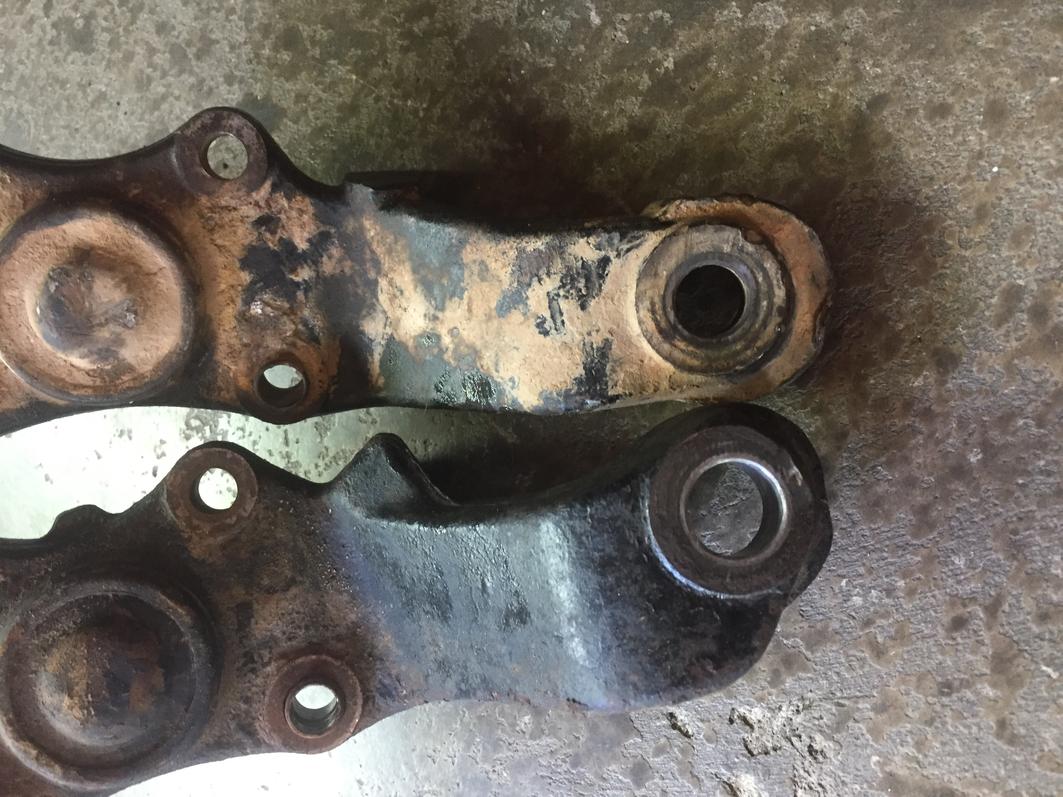

I know this is old but I'm having the same issues with the LBJ. Both LBJs I have are OEM. However when I just replaced my LCA bushing with white line I busted a lbj boot removing it. I don't want to reuse the ball joint with a ripped boot so I put the old one back on temporarily till could get another one. As I put everything back together I noticed the tie rod is loose as hell in that bore causing the wheel to be VERY sloppy. Why would the bore be larger?
manufacturing defect. take the parts back to where you bought them from as this is a safety hazard and they will have something fail.
Did you disconnect the tie rod when removing the ball joint to replace the arm bushings?
I actually just figured out the issue! I raised the left front tire off the ground and wiggled it back and forth. Lots of side to side play. The LBJ bore is fine, it's the damn OTR stud. The castle nut wasn't able to torque down which couldn't even press the tie rod in to place. The stud is completely obliterated some how. I'm shocked I didn't notice this when I put everything back together. I think it went on at first because the car drove fine before the alignment. But after the alignment the tech probably adjusted the toe causing movement in the tie road which led to it coming loose.

I know how to to replace ball joints and tie rods haha. The problem was I was getting an alignment after my LCA install something was effed up on the tie rod. It was pretty dangerous to drive home. You think they let me work on the truck in the shop? No.. I didn't want to drive it home but I did
I had the same problem as OP. The bore is larger

Is this on an toyota oem ball joint?

I also get a snap noise when making a left turn at low speeds. I know I squashed the tie rod boot, when I replaced the LBJ. Now I'm concerned about this bore issue.
I looked at the part number on the boot and it appears to be an OEM LBJ for the tacomas.. I think I've read somewhere where I'm thread about converting to those and they said the tie rod hole is indeed larger..
