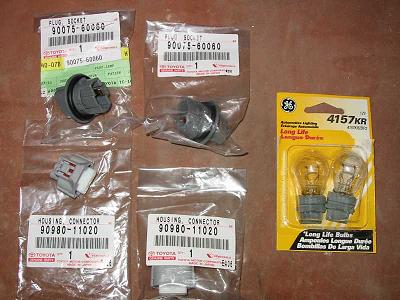

Kmvreter said:
Connectors, sockets and bulbs:
Where did you find these plugs and housing connectors?
I have some 7443 LED bulbs and trying to find connectors for those ones. I tried with the one you used for 4157/3157, but they doesn't fix properly. So any ideas how to use 7443 LED and where can I find connectors like yours for my bulbs?
No idea about making the 7443 bulb fit but I ordered my toyota connectors and sockets from the local stealer.
Do you remember from which part was those connectors? Dealer is asking for model and where in the wiring these connectors should be.
The 90080-11020 number is the connector(you have to wire it)
The 90075-60060 number is the bulb socket.
They are parts for the DRL's.
I purchased 2 of each from the stealer and it was about $45.
After I got them I checked Partznet and found I could've got them for about half that price.
DRL is 3157. Is those part numbers for 3157?
I know for the tail/stop mod fo'runner used 4157's in those sockets. That's what I am going to use too. 4157's fit no problem, not sure what the diff is between the 4157's and the 3157's.
Maybe the only diff is the 4157's have a dual filament, which is what you will need for doing this mod, but I'm not positive.
3157 and 4157 are exchangeable.

A couple weeks ago, I completed this mod for brake and tail lights. I used the 4157 dual filament bulbs in the sockets that are used in the fronts for the DRLs. No cutting of the "tube" is necessary as the bulbs go in these sockets pretty far and so far I see no heat issues at all. They very closely match the regular tail lights, basically exactly.
See the post by fo'runner a couple pages back. He explains the exact procedure. This is how I did mine. I love'em.
