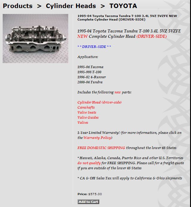

These are the heads that my non-dealer (but Toyota certified) Toyota mechanic installed.
$575 Each | Complete Aftermarket Japanese Heads for 96-02 4Runner by J.E.
Link -----> Japan Engines
Mechanics will want to charge you for a rebuild. $2500-$4000 depending on what they say. Don't do this. ---> Don't do this.
If you must spend $2000 then either go with complete aftermarket heads like these or just do an engine swap for a low mileage engine from a rear end collision salvage.
Also be sure to use the Toyota gasket kit. Yes it is expensive but you can order it online yourself from "Camelback Toyota Online Parts" <--- gooogle it :)

It was $$$ but if you can find someone to do the work then it really wouldn't be that expensive. As I already mentioned I have JE heads, one of the only people here to go down that route.
At $575 each for a complete head it is often a much better solution (and longer lasting) than "rebuilding" the factory head with non-Toyota parts.
The shop that installed mine builds a lot of trucks for the Baja scene down here. He says that he puts these heads on 4-6 Toyotas a month. And that he has not had any failures (I assume within a reasonable period of time)
