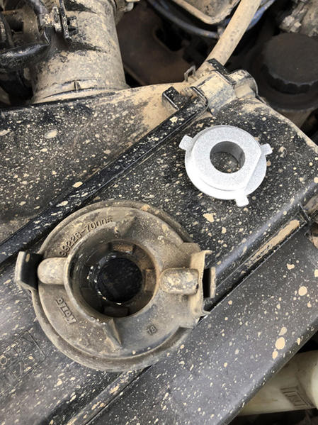

Mine showed up minute ago. Figured out where o-rings go, if not figured out already? They are spares, the silver keyed piece is removable o-ring is in groove on blue part provides the friction to keep from rotating.

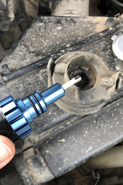

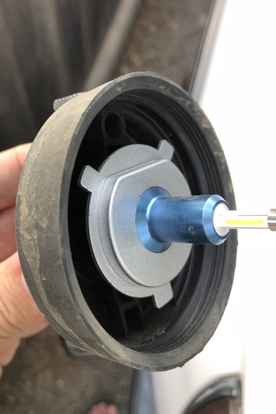

Ay guy's, won't get mine in tonight. About dust boot try this, separate silver keyed flange from blue bulb section, install in housing install boot slide blue assembly through boot.

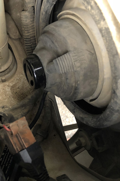

[MENTION=142122]96RedRunner[/MENTION] beat me to it. I tried installing these yesterday, and wasn't going to settle for not having the rubber boot on, as without them, there's plenty of room for dust/moisture to get into the light housing.
I too discovered that the silver plate separates from the blue section. Slid the rubber boot over the blue section, and then the silver plate back into place. Had to wrestle the rubber boot half inside out to get the bulb holder clip into place, but was then able to flip the boot into place. Since the bulb plug is on a longer wire, the plug is no longer semi-protected by the boot. I think I'll wrap some electrical tape over the plug to help reduce the chances of water/mud getting in there.

[MENTION=142122]96RedRunner[/MENTION] beat me to it. I tried installing these yesterday, and wasn't going to settle for not having the rubber boot on, as without them, etc.
The way you have the boot is not letting fan push heat away from unit, it is trapping the heat inside boot. Heat kills these things, might want to consider uncovering the heat sink.
I haven't been using/didn't use the rubber boot (forgot where I stored it about 2 yrs ago when I switched to using LEDs). Doesn't seem like it affected any of my previous pairs btw. Do you guys thing its necessary to really use the rubber boot?
I just put them in min ago. I left the boot off, I think it covers too much of the heat sink. Only reason for them is to keep moisture n dust out, you been running without for two yrs no problems wouldn't worry about it. I run dusty roads a lot probably a problem for me. Will come up with something.

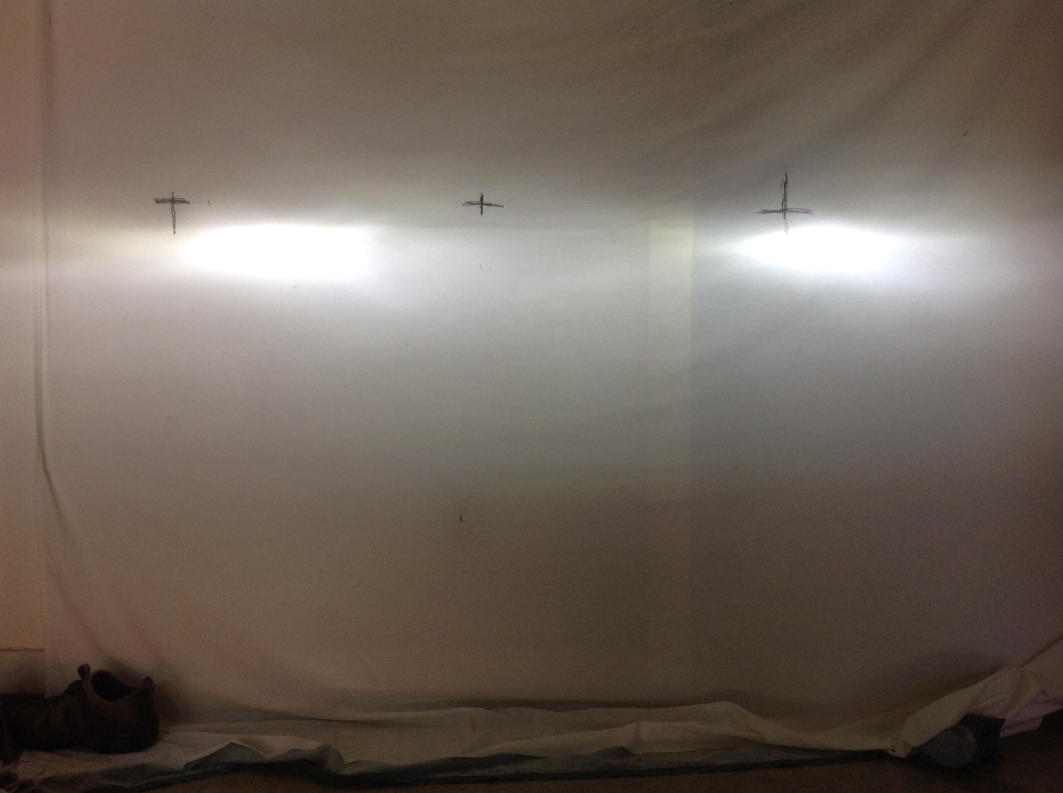

This is what I came up with. Followed FSM alignment procedure.
10' from wall, Cross hairs at 38" from floor which is center of HL. OEM housings.
things I found out, HL's on 30 min or so mostly low beam, the transformer gets warm+ Closer to hot in that amount of time. I started with power lead at 6:O'clock the beam pattern was lacking so I rotated Blue part which got what you see both are 4-5 O'clock now. I did no adjusting on HL's, LHL is somewhat aimed inboard, RHL about centered, both are about 2-3" low. Take it out on road tonight see how it plays out. They are better than what I had, drove it last night in city light no one flashed me, was also before I focused/rotated bulb, sorry for big azz pic.
