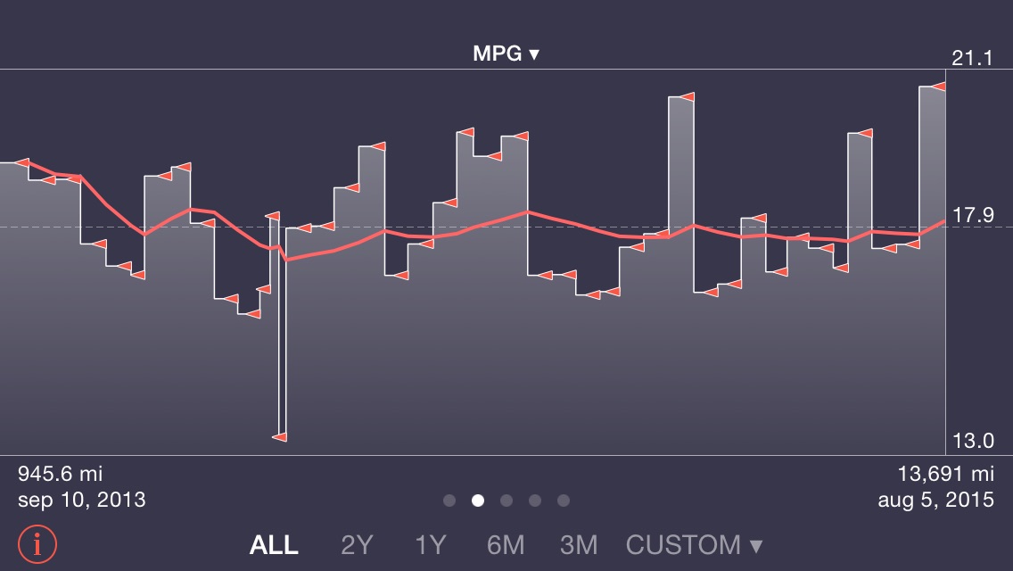

17.9 MPG over the first ~13.5k miles. I live in a hilly section of the PNW and spend the majority of my time in town averaging 16.5 - 17.5 mpg. On longer road trips I have average >21mpg. My rig is a stock 2013 TE that has been fed a steady diet of 87 and 92 octane fuel.
