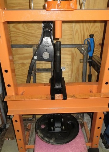

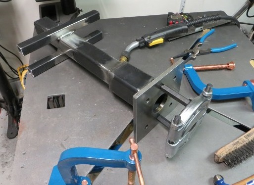

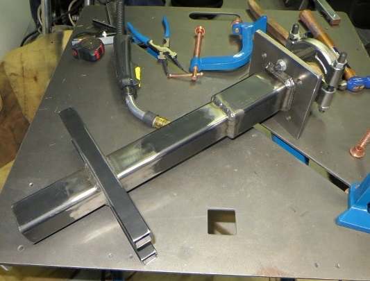

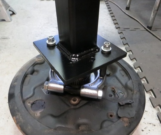

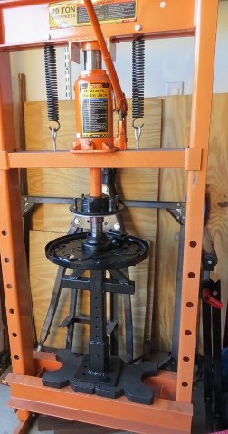

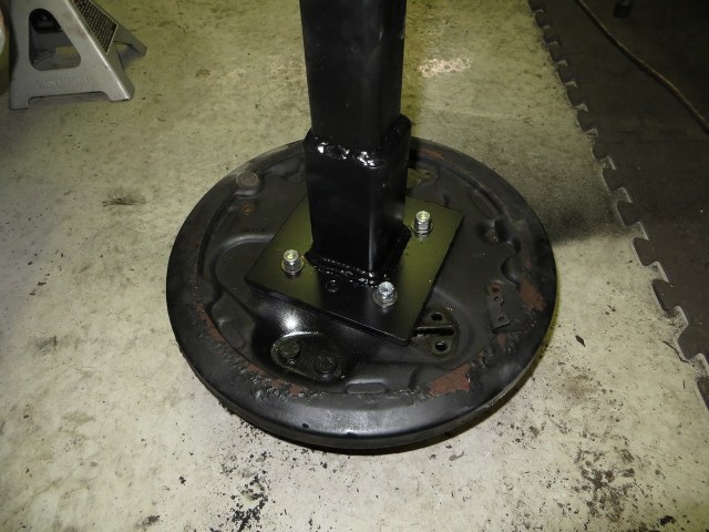

Thought I'd share my version of the special service tool. If you can weld, save yourself some $$ and build it yourself. If you do it right, one tool can disassemble and re-assemble everything and even save the collars and ABS reluctor rings. I cant take credit for the bearing splitter idea - saw it somewhere else. I also ended up beefing up the cross-bars (not shown in the pics), but otherwise this design works perfect with a 20T HF press and a set of HF bearing splitters.

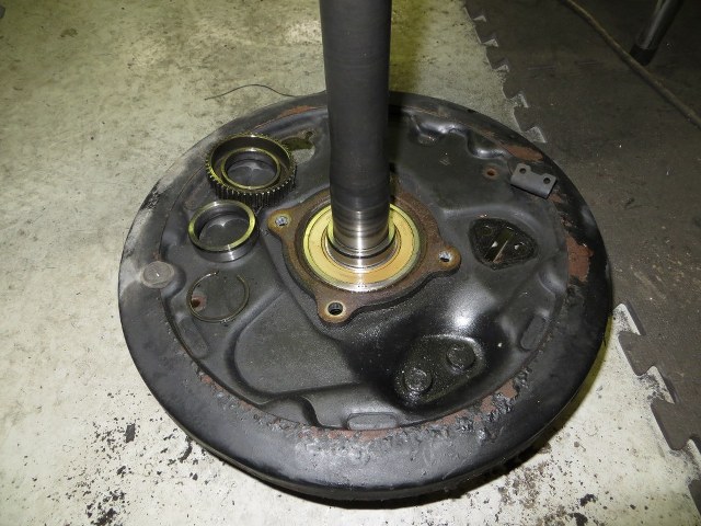

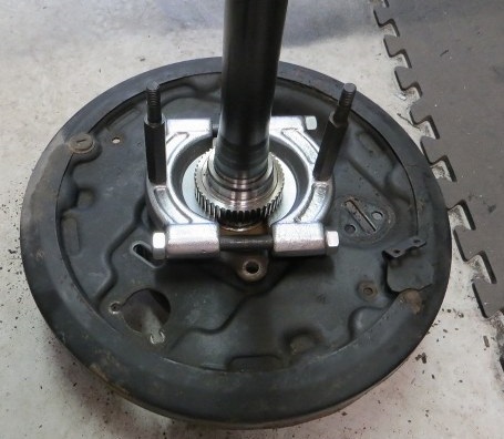

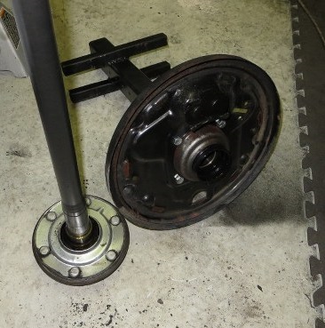

Here's the disassembly process.
Not shown: The seal on the backing plate can be removed by hand or with a seal puller. The bearing itself can be gently tapped out of the backing plate fairly easily.

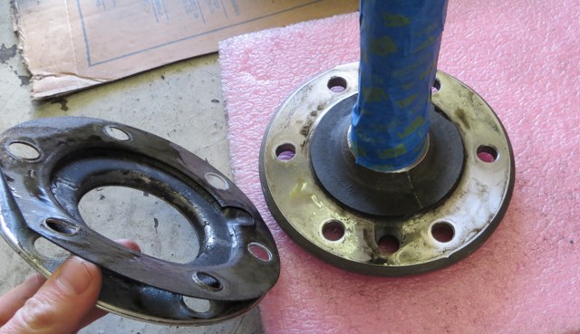

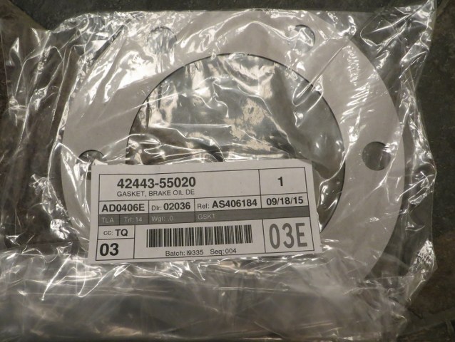

Also: If you are doing the bearings/seals, now is the time to replace the "brake drum oil deflector gasket." PN 42443-55020. They are cheap, and mine were saturated in gear oil. You will have to yank the studs, but that is NBD. Think of the gasket like an oil slinger in an engine - except its a cardboard material that helps retain (small amounts) of oil that gets past the seal from getting into the brakes.

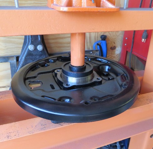

Here's the re-assembly process:
I forgot to take a pic of the rear axle seal itself, but they are easy to install. I just used a HF seal driver set, and drove them into the axle (don't forget to grease/lube it).
The bearing presses into the backing plate easily. The outer seal can be installed by hand. You will see a few bearing/axle press adapters used in my pics - these are just out of my HF wheel bearing adapter set.

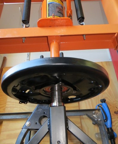

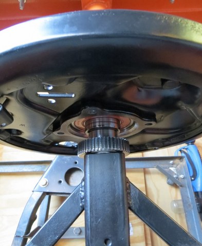

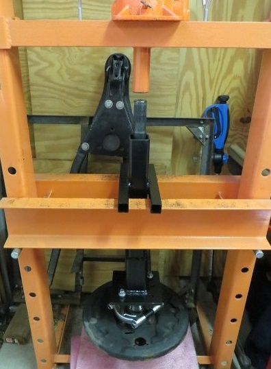

Then the axle shaft gets pressed into the bearing. I supported the assembly from my special axle tool (updated design pictured). Basically the square tube is the right size to interface and support the inner race on the bearing, but still allow the axle shaft to pass thru. I opted to lube the steel press fit surfaces lightly with WD40 to make everything go easier. Obviously you want to grease/oil the seals. Also keep an eye on the splined end of the axle shaft - mine got pretty close to the press/floor while pressing parts together.
Then a collar can be pressed on in the same fashion (I reused my old collars, since I was able to remove them intact). The outer collar retains the bearing and the inner collar is the sealing surface - therefore I used the old inner collar at the outer location, and vice versa for the inner collar. This way the fresh collar (no seal wear grooves) is now used for sealing. A new retaining clip is used to retain the outer collar against the bearing.

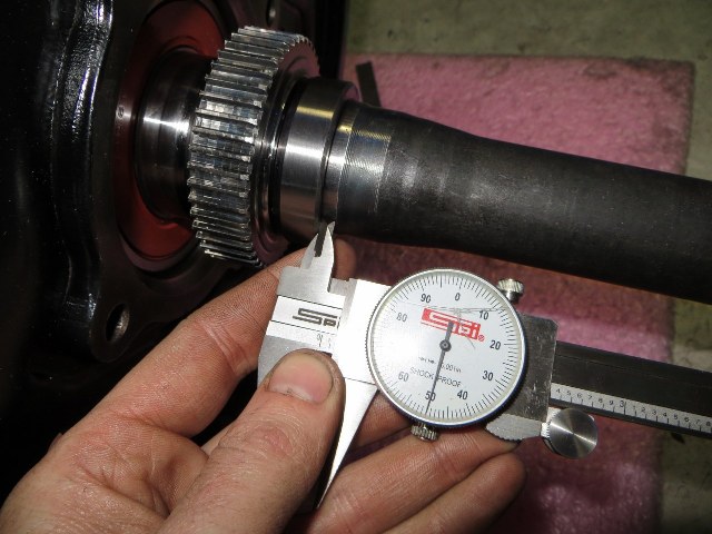

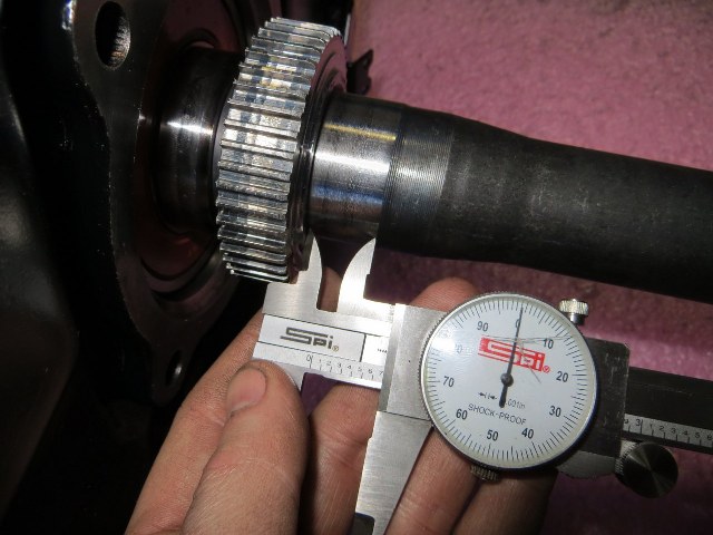

Now the ABS reluctor ring can go back on. I re-used the old ones, since I was able to remove it intact. On my rig, it was located .700" from the inner edge of the machined surface on the axle (see pic).

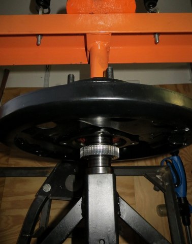

Now the inner collar can be pressed on. Note that it does not get pressed flush to the ABS reluctor ring. The tapered edge NORMALLY faces inboard, however after I took a few measurements it was clear to me that it would be very difficult to ensure the seal lip rides in the appropriate area on the collar. I took the advice of [MENTION=78997]Drcoffee[/MENTION] and flipped the inner collar around backwards (tapered edge facing outboard). On my rig, the collars ended up at .150" from the from the inner edge of the machined surface on the axle (see pic).

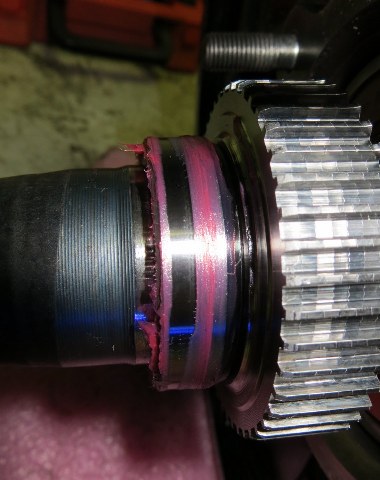

I re-installed the studs, generously applied grease to the collar and installed the assembly to the rear axle and spun it a few times. This gave me a good pattern that shows where the seal lip is riding on the collar (see pic showing the seal lip is positioned near the center of the collar via the grease marks).
