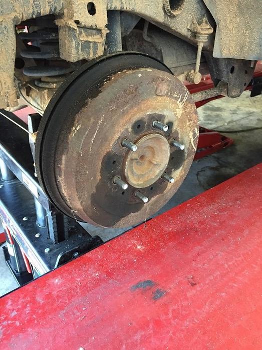

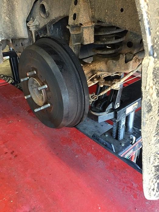

Hi all, happy new owner of a 99 T4R SR5 4x4 with 147k miles (bought it 2 days ago). Went to replace the tires and realized the drums were "wet" looking (wish I had found these when negotiating the price!). I'm guessing it's the problem the OP described. Driver side much wetter than the passenger.
Do you guys think I can get away with JUST changing the INNER seal? I'm guessing if there's not much play in the wheel bearing, I should be OK?

ooh idk that looks like mine. It's been leaking for a while. The preventative maintenance person in me says to replace all of it, which I'm planning for mine.
