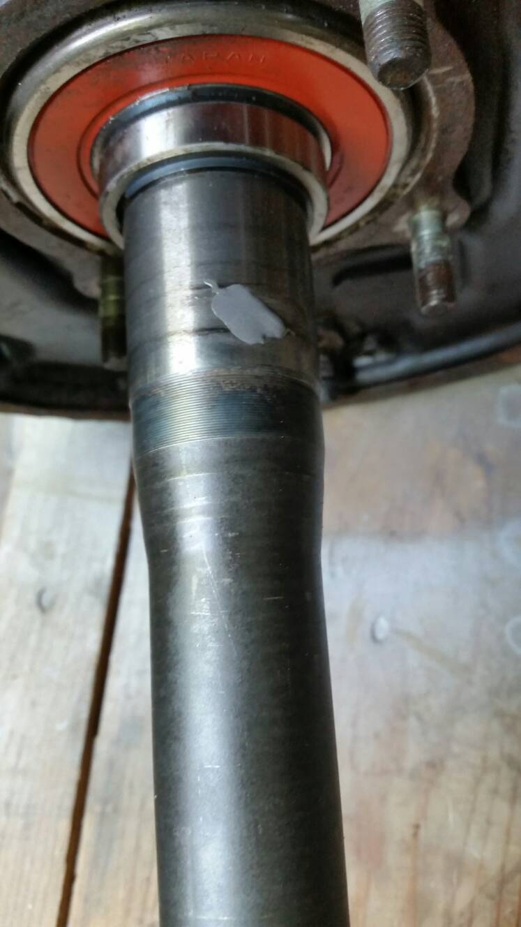

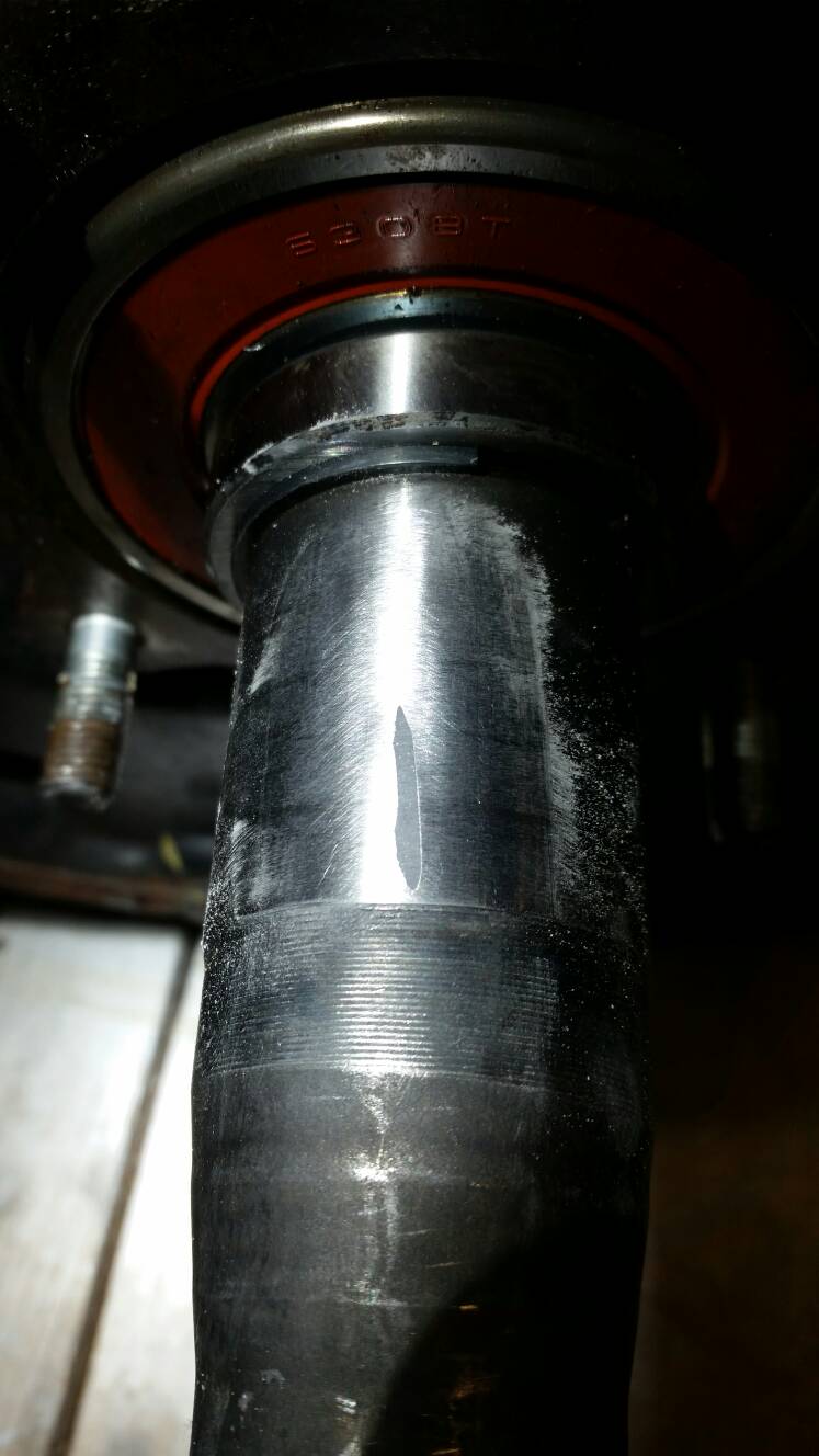

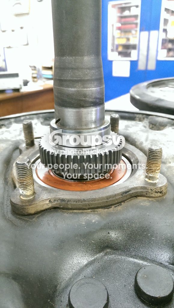

Guess what happens when the shop doesn't measure the position of the ABS ring before they reassemble?
IMAG0719_zpslw2xiobb.jpg~original
IMAG0718_zpssdrtqtoa.jpg~original
At least it let me discover big gouges on the shafts from a previous replacement. Hopefully they'll fix it on Tuesday.

Man, what an absolute cluster F^%k. Are the gouges under the retainer ring, which is why they put the RTV around the retainer? If they are deep the only right way to fix it is to replace the axle. But if you can't do that, use some hardening sealant. Put it in the groove(s) right before pressing the retainer into position.
Wow what a mess! Shop should definitely replace that axle. A gouge like that on the axle is a weak spot that might fail at the worst possible time.
The axle assembly can be disassembled using a bearing splitter attached to the axle tool such that the two retainers and ABS ring can be reused. IMO, it's bad advice in the FSM recommending the retainer to be cut off. The cost of the bearing splitter is cheaper than that of new ABS rings, and you minimize the risk of damaging the axle from the cutter.

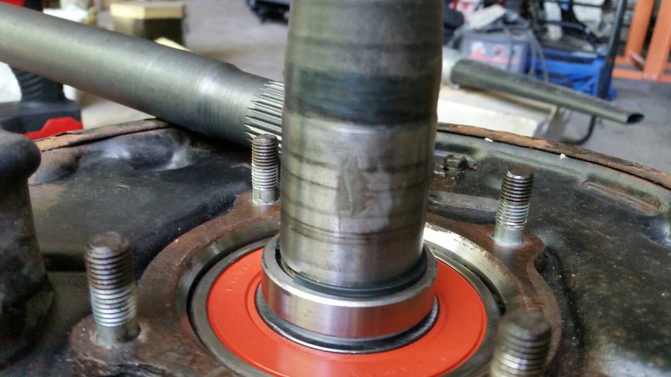

The bearing retainer that goes after the bearing and before the ABS ring is missing!

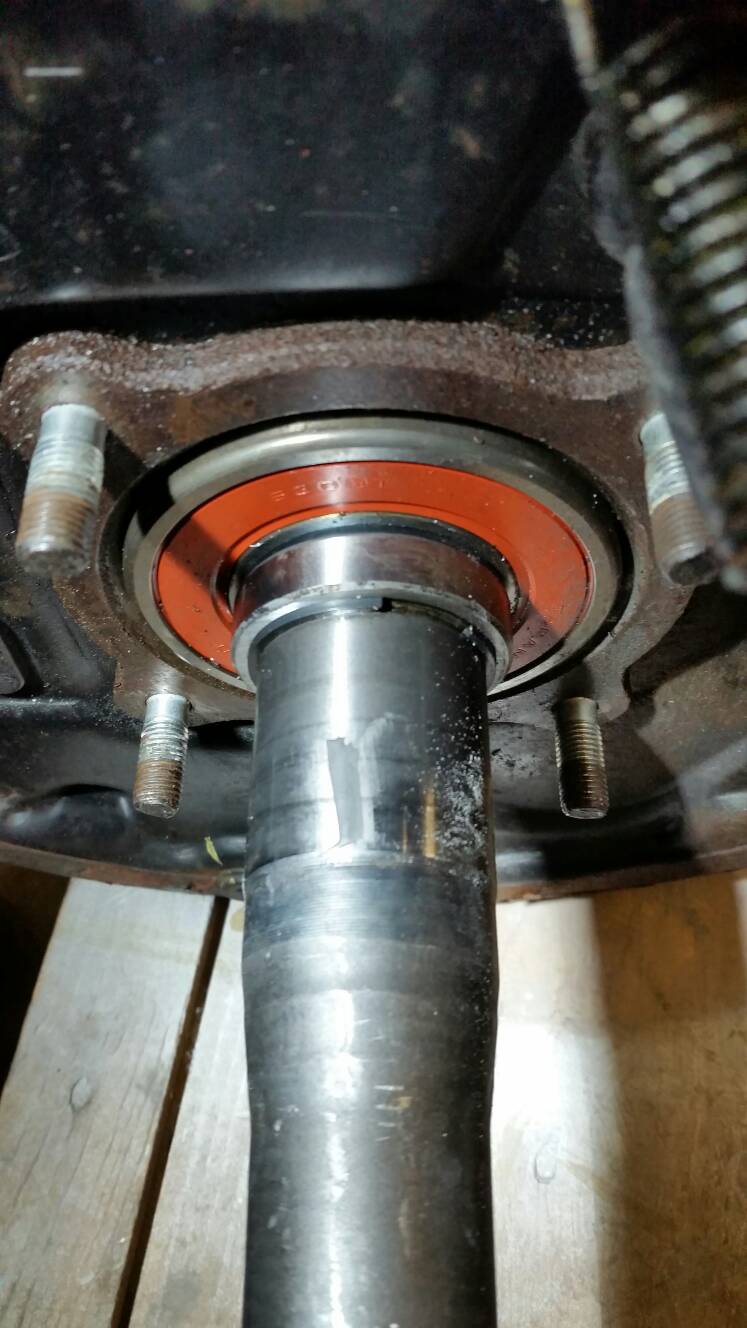

Wish i could borrow that tool that people make, or the time to fab it, and source the metal. I have a hf 20t press, welder, experience and confidence, just no time for mistakes!!

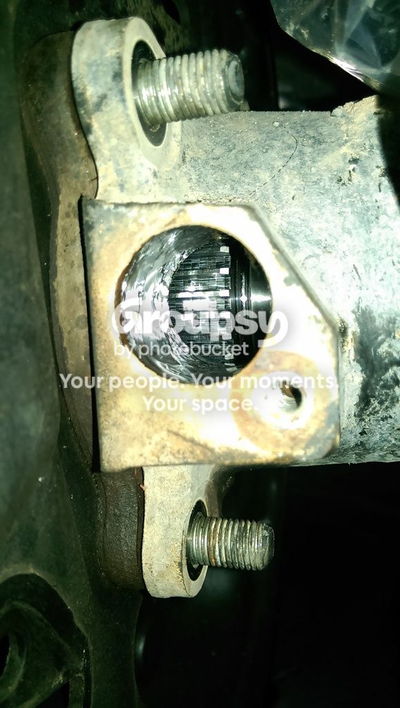

Update:went back to machine shop after i brought home a terribly gouged axle shaft with everything messed up. Must have used a cut off wheel then kept going into my axle. Not sure how it could seal....
One on the bearings wasnt pressed in all the way to the housing, no biggy, but the retainers and tone ring were smashed right up against everything. He says only way is to cut off tone rings with cutoff wheel....
So f---ed. Axles are only 572 a piece. Paid the shop 205 in labor to f me.

Yikes that sucks on the last 2 attempts posted on here. I ended up bringing a printed out photo to my machine shop to do my install. They take it as an insult but as we know, very precise. I even drew out the measurements... Oh well.
Luckily for me I had a spare rear axle housing I was building so I loaded in into the truck and tested fitted at machine shop w grease. They appreciate tthe owners pain now when it goes wrong on parts install.
I should have taken a few minutes and drew a picture, or even taken a picture of the shafts the oem setup.
Tonight i cleaned up the epoxy or jb weld whatever they used in the gouges on the shafts.
Replaced diff. vent w oem, old was not clogged but likely original.
Remove old seals (ending in "01") from housing. Reinstall pass axle seal "06" utilizing electrical tape rolls and hammer.
Note: the one bearing not even pressed into housing. Good grief.
