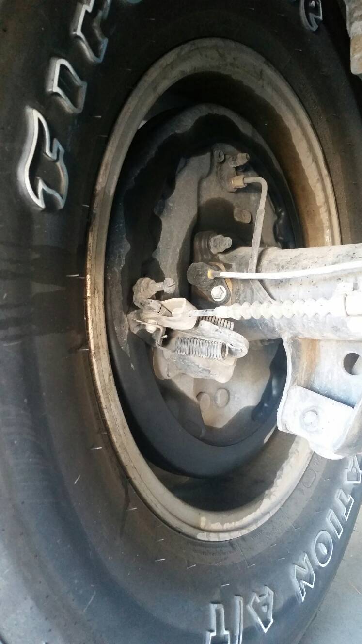

Just saw this today under the rig. How soon do I need to fix this? What bad things can happen while driving on something like this? Just wondering how little time I have to save up some cash

I had same issue. As long as there's enough fluid in the diff, you could go years with a small leak like that. Mine leaked, and I think diff breather cap was clogged and I cleaned it and jiggled any dirt out of it, filled the fluid back up and no more leaks.

Ok cool. Is it going to affect the rear brake at all or is there no way for it to get in there?
That looks like it went through the bearing and boot. I would pull the wheel and drum to check brakes. Those brake shoes sucks diff fluid and may compromise breaking. Check your diff breather if clog. Think about doing breather mod. Worse case is axle rebuild if bearing is compromised. You may get away with just changing the seal and o-ring. Just 2 cents.

Thank you for the info. Going to do the breather mod atleast. It will help the other side if anything.
The other thing to worry about is the gear oil washing out the grease from the wheel bearing. However that may take a long time with a slow leak and it will likely squeal long before it seizes. Plus most people replace the bearings when they do the axle seals too.
