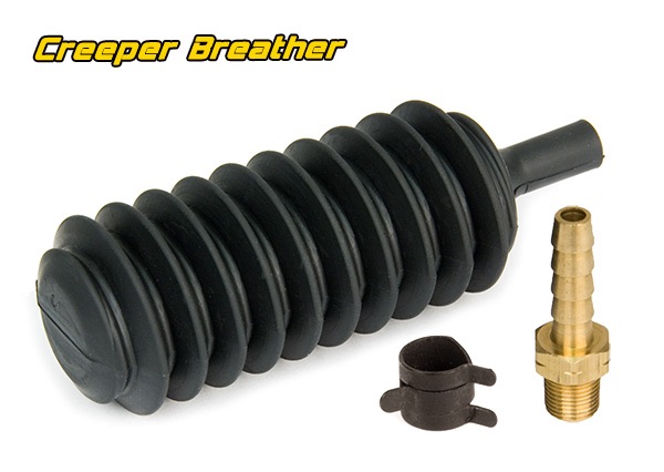

Has anyone used something like this? Thoughts?

that manifold with the polyethylene filter is pretty trick for the jack compartment. to date, i don't think i've ever seen anyone use the ARB 4-port manifold. i think it uses a sintered filter: ARB Differential Breather Kit (170112)
there's also this kit from Air-on-Board: 4 Port Diff Breather -Air On Board

I don't get the scuba manifold and what that does?
As Saker said previously, "It is a manifold with a filter that will allow pressure to equalize within the differential. It has multiple ports for installing more than one hose." It is just a way to connect multiple hoses to one valve.
