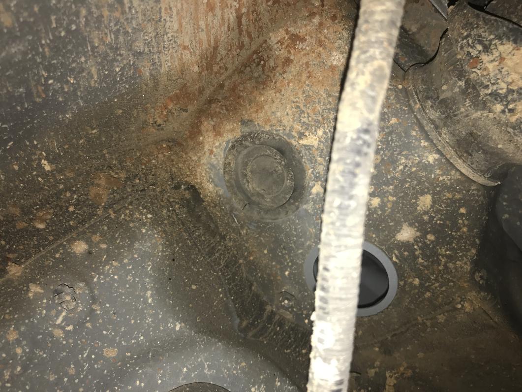

Thanks Saker, do you think there is enough meat on that plug to punch two holes? I have a TRD OffRoad so I want to run a dedicated line for the E-locker.
You are welcome.
write the part # down before you punch any holes in case you need to purchase a replacement.
There may be enough room for 2 holes, but is not necessary.
You can put a T in the line, join them together and run 1 hose to your desired location of preference.

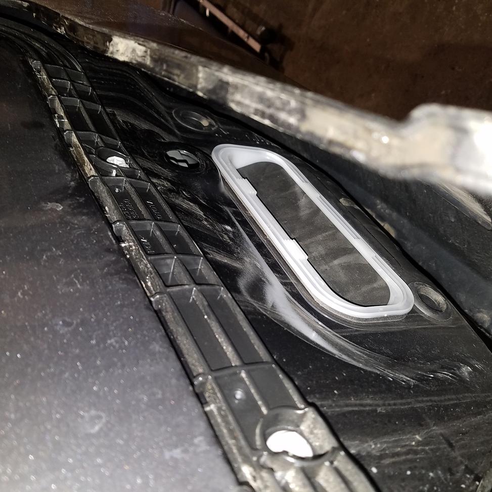

Has anyone just simply routed their breather right inside one of these grommets? This looks to basically go to an empty compartment right below the jack compartment. It would be closed off from dirt or dust and save on the hose length needed to get into the fuel door or other areas. It is partially sealed from the interior, so hopefully no fumes. My only question would be how much "fresh air" the breather would need? (I have the two way breather). Should this litttle compartment be ok ?

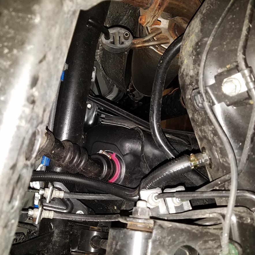

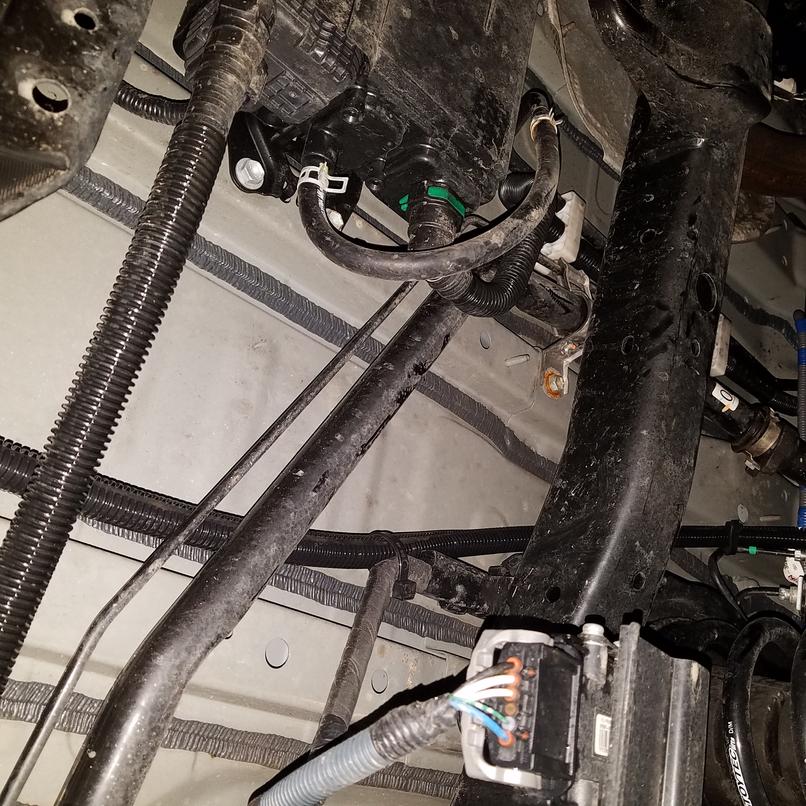

Installed my rear diff breather over the weekend. Thanks to many of you for posting your DIY experiences in this thread and others. I especially found a couple posts by [MENTION=55815]Okki[/MENTION] helpful:
Various axle unions: http://www.toyota-4runner.org/5th-gen-t4rs/114057-breather-mod-all-tied-into-one.html#post1053777
Looks like that was originally from Sonoran Steel’s site:
And his DIY rear diff breather job w/ BOM… http://www.toyota-4runner.org/5th-gen-t4rs/94578-okkis-build-thread-4.html#post1073310

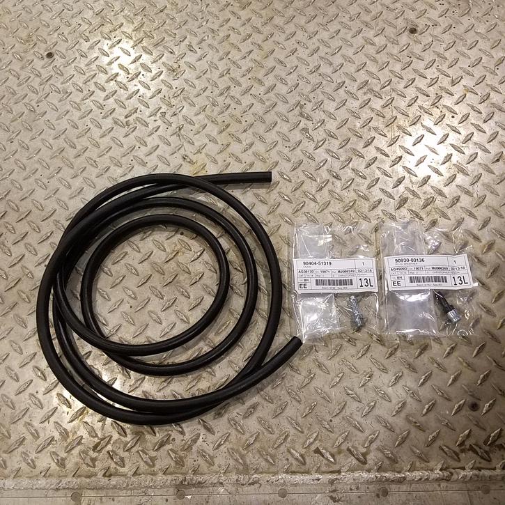

Here is my Bill of Materials (BOM):
90404-51026 Union: $6 at local Toyota dealer
100561 5/8” Hose clamp: Everbilt 5/8 in. Stainless-Steel Clamp-6260294 - The Home Depot
3JT63 25 ft pneumatic air hose: https://www.grainger.com/product/SPEEDAIRE-25-ft-Air-Hose-3JT63?searchBar=true&searchQuery=3jt63
1EJW7 Pneumatic silencer muffler: https://www.grainger.com/product/SP...uffler-1EJW7?searchBar=true&searchQuery=1ejw7
Other misc pieces: Alum angle bracket, a couple M8 screws, zip ties
Total cost, about $40
The air hose is basically equivalent construction and cost of fuel line but with the benefit of the end fittings.
Basically followed the fuel and brakelines to the engine bay. 12’ was JUST enough length.
Forgot to snap a shot while I had the fender liner out of the way…
Used a piece of 16ga aluminum angle to make a quick mounting bracket. I thought the silencer muffler made for a perfect breather cap.
If I were to do it again I’d probably just buy the ARB kit for $70 online and spared a couple days of researching and running to three different stores for parts to “save” $20-$30, but in the end I think I ended up with a bit more durable kit anyway.

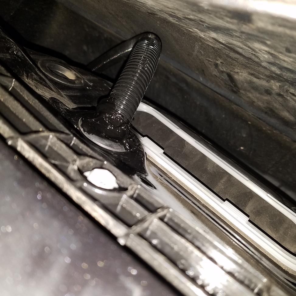

Does anyone have updated images from the install into gas cap compartment and how to access it? The pictures form the third party host are no longer showing up... I will attempt go in blind just by write up if not no worries.

Here is my thread with good photos of where to run the line. I found a better, higher place to run the air line into the jack compartment.

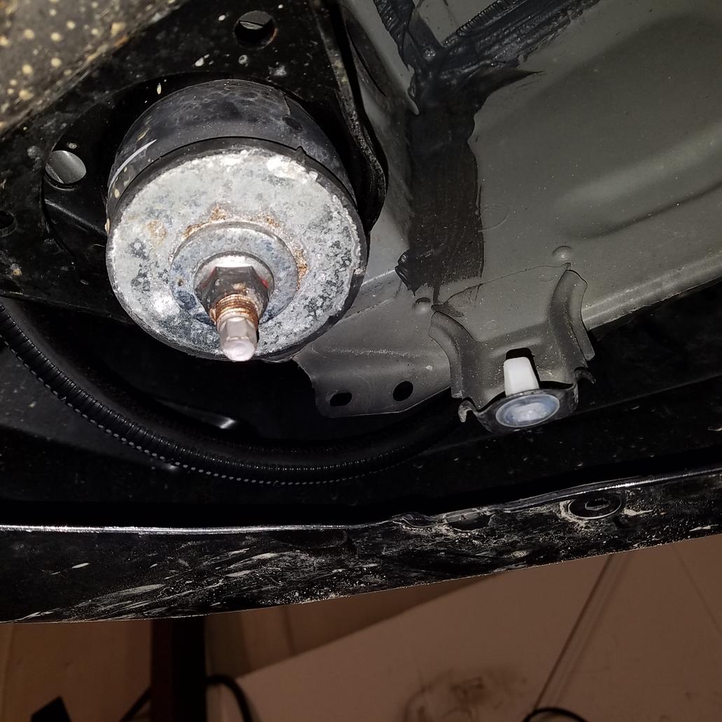

My turn. I have more pictures but the forum only allows 8 at a time so

Has anyone caught a wiff of the diff fluid inside the vehicle as a result of running the breather up into the jack compartment?
No one that I have seen that's why I did it. I had the same fear and this fear has been brought up many times but everyone says no. Easy to move if you decide you don't want it there.
I did, only when I had the recirculating air on though. It seemed to go away after I replaced my cabin filter

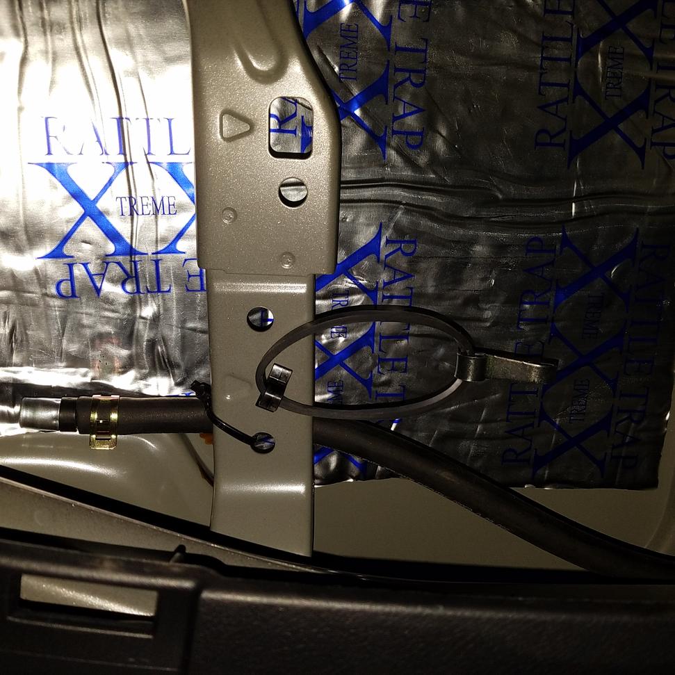

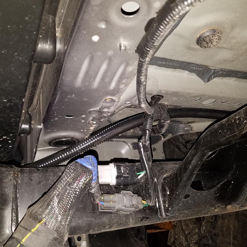

I actually did a slight variation on what other folks did. I routed the diff and e-locker breathers up on top of the fuel filler pipe all the way to the area just behind the fuel filler chamber, up at the top of the left rear wheel well. I didn't feel comfortable cutting up the rubber and plastic that is supposed to keep the "outside water" from becoming the "inside water", but I wanted it to be as high as possible. This part of the wheel well is covered by a plastic splash shield, and the area actually seems to be a lot cleaner than under the fuel filler door. It did take some fanagling with a small 12-point socket (I think it was around 10mm) to release the plastic panel clips from behind.
adventureman-albums-%26quot%3Bthe+rhino%26quot%3B-picture50870-relocated-rear-diff-elocker-breathers.jpg
You unclip the splash shield, run the breather tubes up along the filler pipe as high as they will go, secure with zip-ties, then button the splash shield back on.
