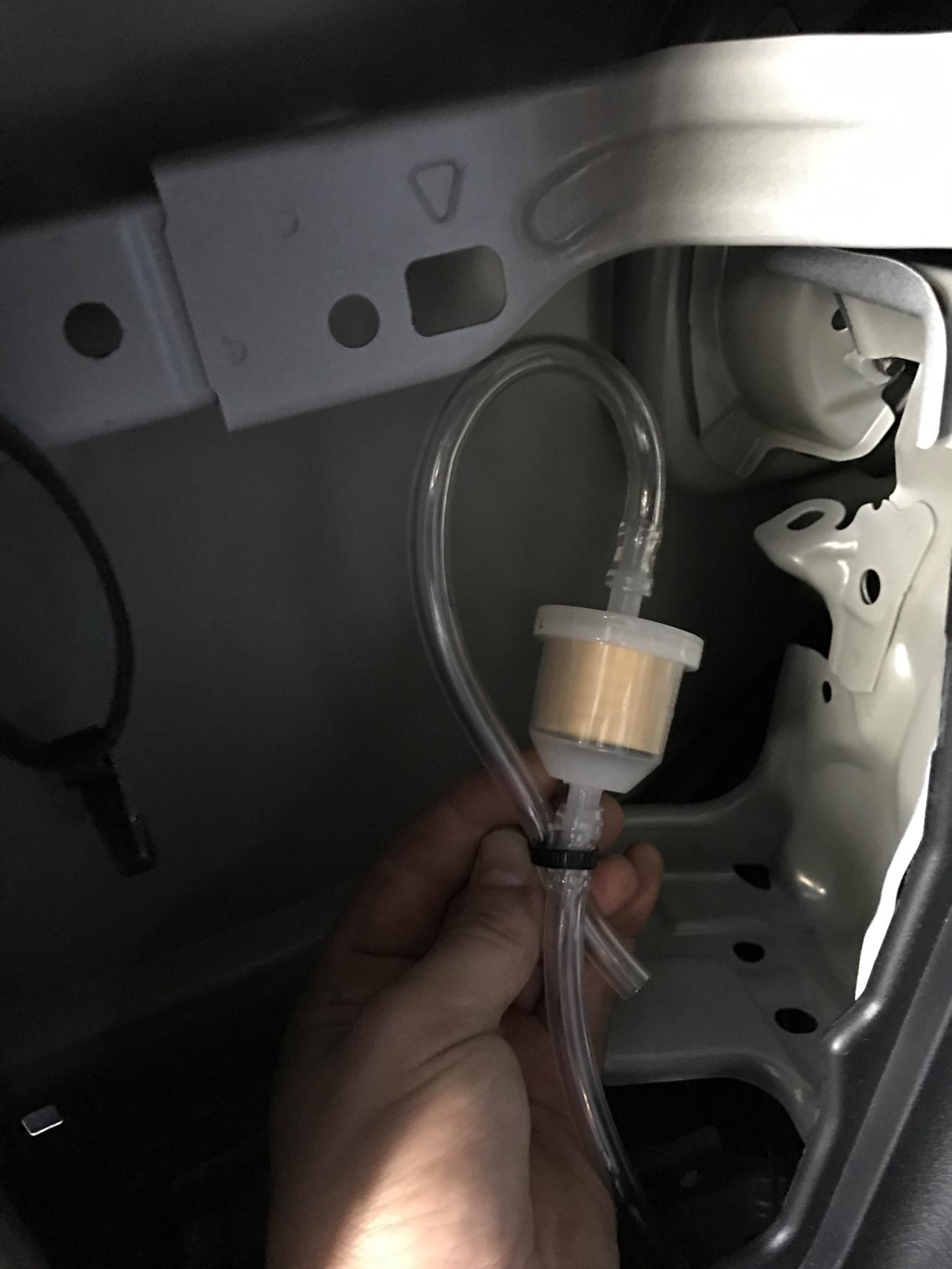

Just did the rear, fed some tubing out from where the factory jack is, behind the plastic in the inner wheel-well, and then along the fuel tank filler pipe. Used a K&N in-line fuel filter, it's a paper media material and lets air pass both directions. Should stay clean in this location regardless but it's an extra level of protection and was super inexpensive.

I have the ARB kit to install on the rear breathers. Has anyone had any problems with gear oil fumes when locating the manifold/filter inside the jack compartment..?
nope, you will be good to go with the arb kit.
I had fumes when installing the kit, but once I connected it to the arb filter block, the fumes disappeared.
Ok, so I did this today, running both to the tool/jack compartment.
Very easy but I'm not satisfied with the rubber body seal. Ill need a better solution than just cutting it. It may be that trying to pass two lines thought it at an angle and still maintain a seal is too much and/or some kind of right angle fitting is needed...
