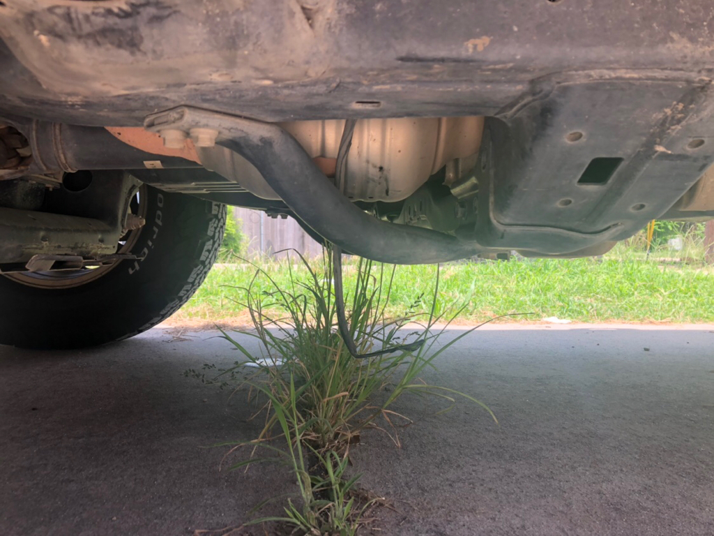

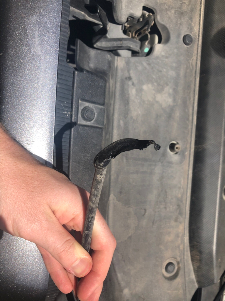

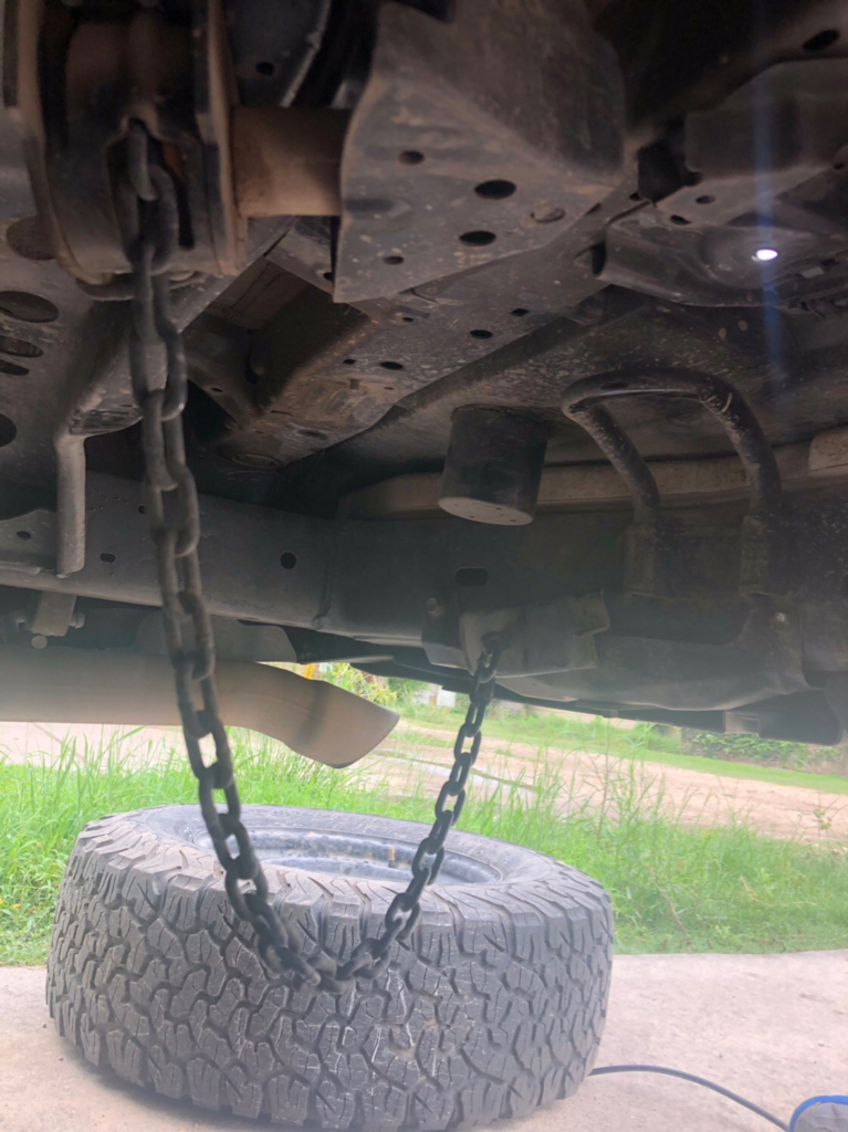

Not sure what changed from my initial install, but I got home today and noticed I had something hanging under my truck:
See the black tube? Yeah...my rear differential breather line had contacted something and melted:
Given where it is hanging, I figure it contacted the exhaust line. Now I get the pleasure of reinstalling, but will be more thoughtful to keep it running under my driver’s seat back to the valve, and away from the hot elements.

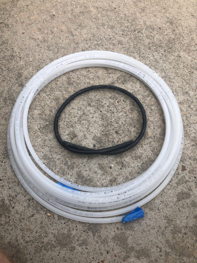

1) I didn’t order new ARB tubing because I looked into its tolerances, and it’s actually kind of weak...or so it appears
- found this 5/16” OD polyethylene tubing at a local hardware store:
Max PSI in this is 125 (not that I’ll need it, it better compared to the ARB tubing’s 85 PSI), interior dimension is 3/16” and a tad thicker than the ARB stock tubing, and if I recall correctly the max operating temp is ~225° (vs. ARB’s 150°, but new route will keep it away from heated vehicular elements).
OH - and the best part is that is was $0.21/ft. I got 25 feet and it cost me $5.68 including tax (beats the ARB $36 cost plus tax and shipping).

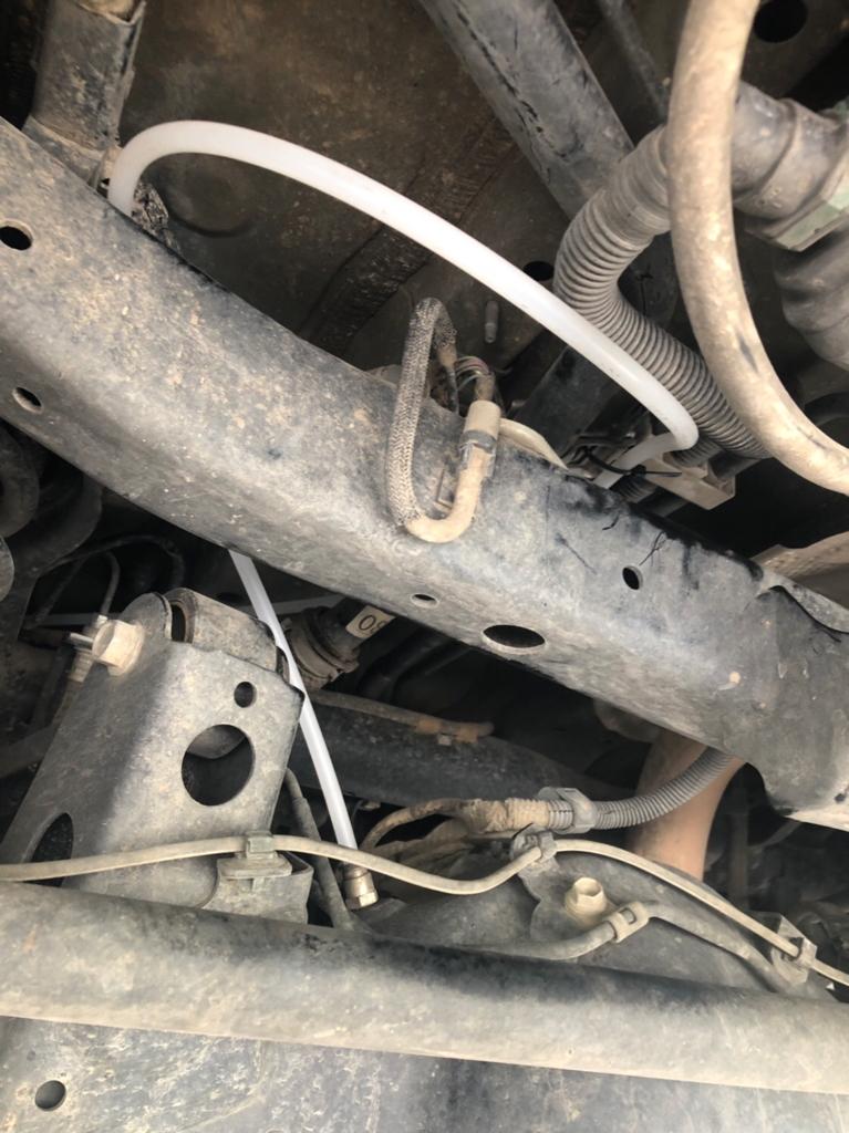

RE-INSTALL:
Step 1: drop and remove tire, and hang the tire hanger out of the way

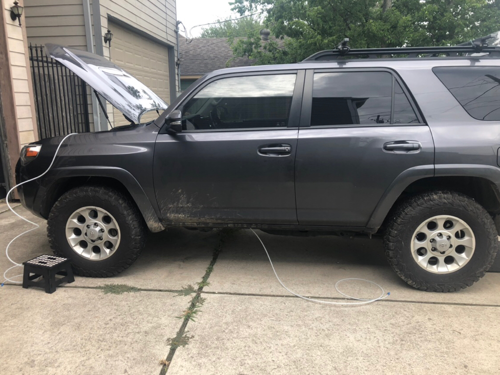

Step 2: Intubating my baby (stool because it was easier to lean over the engine bay and get the tube down right where I wanted it)

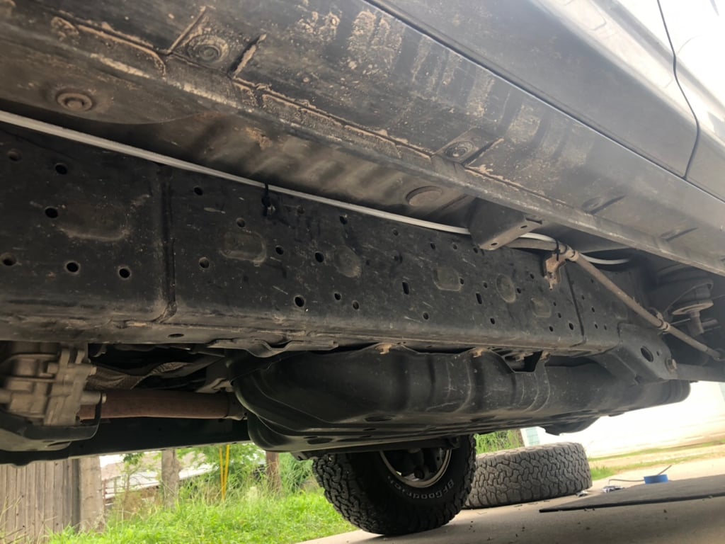

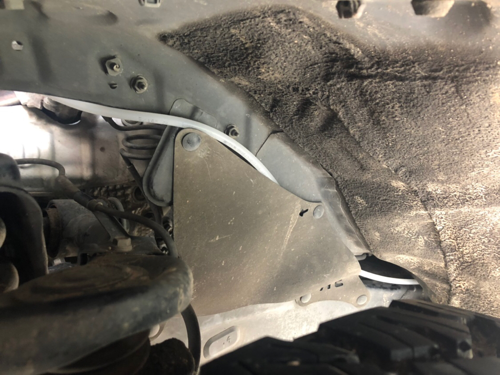

Step 3: Where I ran it this time, and added more zip ties to keep it there:
Step 4: no pic of this, but the sharkbite valves are easy to remove the tubing from. Just press down on the black ring leading into the ARB connector (came with the original kit), then pull away. Comes right out. I suggest taping off the connector if you aren’t replacing the tubing immediately.
Did all the above, and that was it. Took max 45 minutes and most of that was measuring/cutting while making sure it was tight to the body without being stretched.
Hope this helps because tracking down a local ARB replacement tube was impossible, and Home Depot and Lowe’s have this tubing, but only in 10’ sections. Definitely try your local hardware store (mine was Southland Do It Best) first to be able to cut however much you want.

You're 1000% correct - it is all about routing away from heat/spinning parts. Aside from the exhaust manifold contact this thing would've lasted 60k+ just like yours. Operator error :)

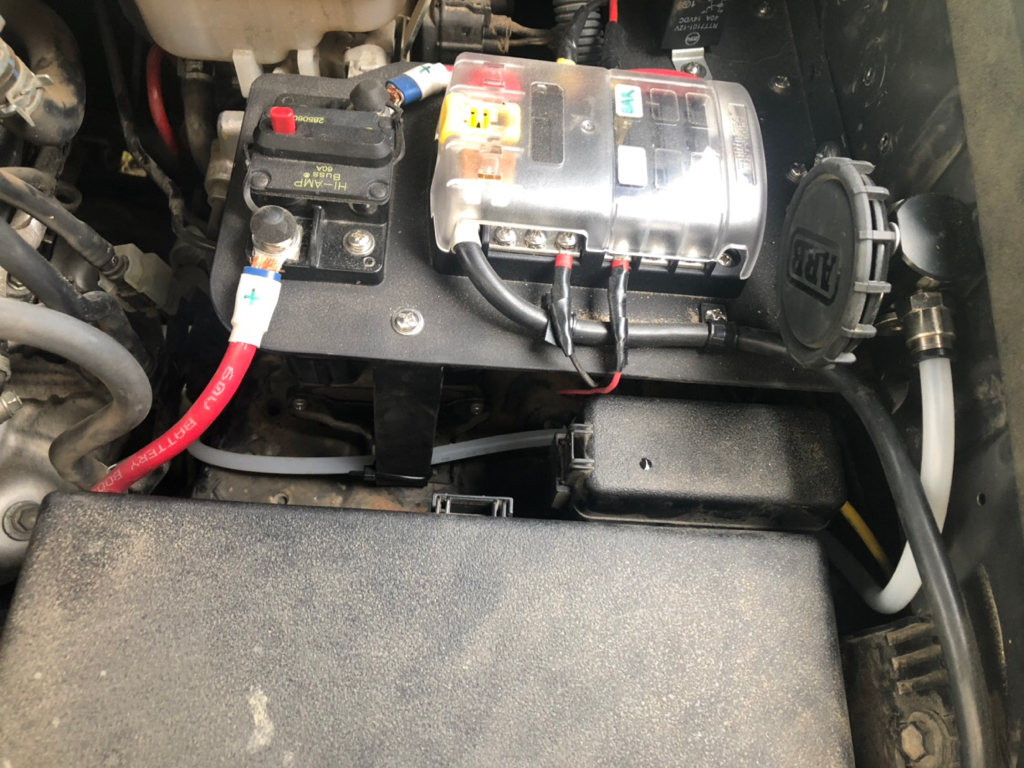

Really like your tube routing. I went (like probably 98% of the 4runner owners) on the inside route and keeping it away from exhaust was.... exhausting :Cry: . If/when it fails I will follow your example.
The only reason I'm going this route is because I went the "traditional" route as well haha! One caveat to that though - When I installed my underhood fuse block I had to move the tube's initial placement, and I think THAT was what led to it getting melted. That exhaust manifold is tricky to get away from.
