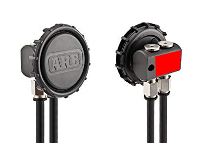

I've seen installations where the ARB snorkel is installed INSIDE the cabin, in the jack compartment; and obviously mounted in the engine bay. But I really liked the installations where the hoses came through the Fuel Cap compartment, but they could not use the snorkel.
I really did not want to run the hose all the to the engine compartment as I knew I would have it close to something that would melt the crap out of it. I also wanted to have the Air Locker hose to have the same connection/routing as the Diff...
So here is how I did it.
You can buy little vacuum hose adapters from AutoZone... $4. They connect the Air Locker Hose and the ARB hose PERFECTLY, but I used a couple of ZIP ties to secure them anyway.
Removed the mud flap and the wheel-well liner. I think there were 8 clips and 4 screws. Ran the two ARB hoses right alongside the metal fuel line.
You can see in this picture how the hoses/zip-ties actually "hold up" the snorkel. I used some 3M double sided to hold the snorkel in place while the JB Weld cured. Couple more ZIP-ties, and done!
Only other thing needed besides the ARB kit was the vacuum hose adapters and the JB weld. There is PLENTY of left over hose from the kit. I think it was a pretty clean install, so I wanted to share with yall. Let me know what you think...
Hello [MENTION=153412]theShaytoon[/MENTION] I really like your idea for placing the manifold at this spot. I’m not sure I want it permanently there with the JB Weld though. Do you have any alternatives that would be as strong but removable later without drilling? Would a 3M VHB tape work? Sorry, never worked on a vehicle before let alone mod one.
Two years in and it's still tucked back there...The JB weld is a VERY tiny amount...maybe two drops the size of Sunflower Seeds...
The Yellow stuff you see between the body panel and the Snorkel is an industrial double sided tape like the 3MVHB...if you want to nix the JB weld, you should be fine. Just remember that if you take the 4runner off road, and you travel trough Bone Jarring terrain, the extra security of JB weld is worthwhile...
ALSO...I would not consider JBweld PERMANENT...I bet I could twist the snorkel off the body and the JB would be left behind on the body panel. Remember to clean the area with alcohol before trying to stick the 3M tape.
Thank you! I will try the JB Weld then, just a small amount, since I trust it will hold better. Hopefully post pics when I’m done!

I just used 1 existing threaded hole on the passenger side behind the air intake (closer to firewall) I threw 3m double sided tape on, lined up where the one hole was, and stuck it. Honestly I don't think it was going anywhere with just the 3m alone, but I put an m5 or m6 (can't remember now) bolt in just to be safe.

Put the 3m on like this
Then I cleaned up the area well with isopropyl alcohol, put the bolt through the bracket, and started threading it a few turns, then made sure it was level and pushed down. I honestly tugged on it a bit before even snugging the bolt down and it wasn't coming off without some heat and probably fishing string (think debadging a trunk). Then I just snugged the bolt up. A lot happier then drilling and doing self tap screws.
