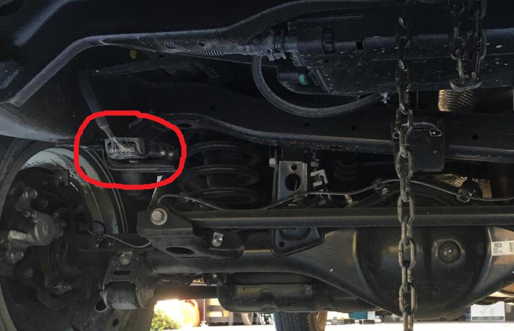

When I was doing my diff breather mod, I noticed this wire connector harness (circled in the photo). My immediate thought was, "Why am I only addressing the diff breathers when this connector is at about the same height?" After a brief search for "water electrical" it seems some people believe these connections are already water-resistant (or possibly "proof").
Is there a consolidated list of mods to perform to reduce risk for water crossings? I'm not looking to do anything as serious as this guy, but I figure I can tackle things one by one starting from the ground and moving upward.
use dielectric grease in any electrical connections you are worried about. for normal use you don't need to go crazy with it, but it's a good thing to do for any connections you work with as you go

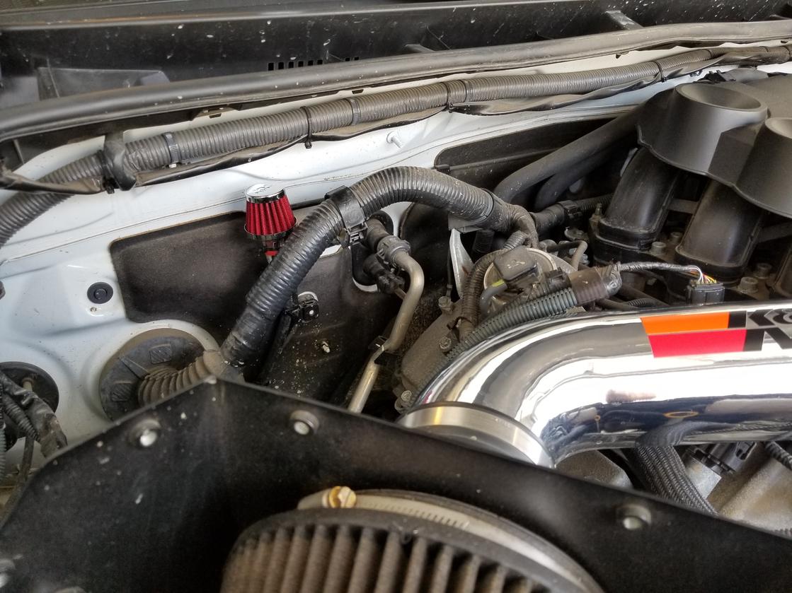

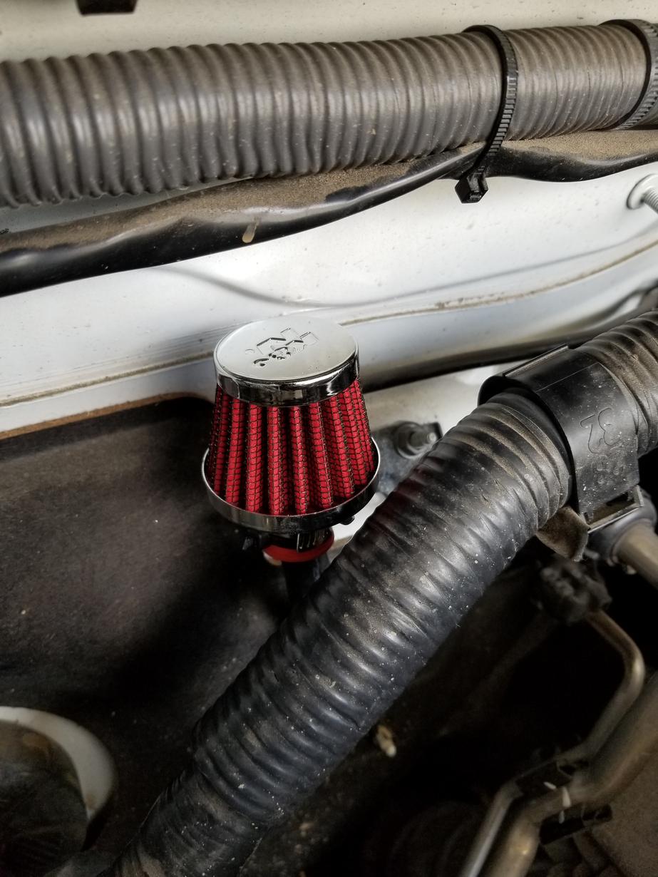

Routed mine to engine bay behind the K&N CAI. Topped off w/ mini K&N filter because I think it looks good matched w/ the CAI.
Think this mod takes the cake for most zip ties used in one mod...
