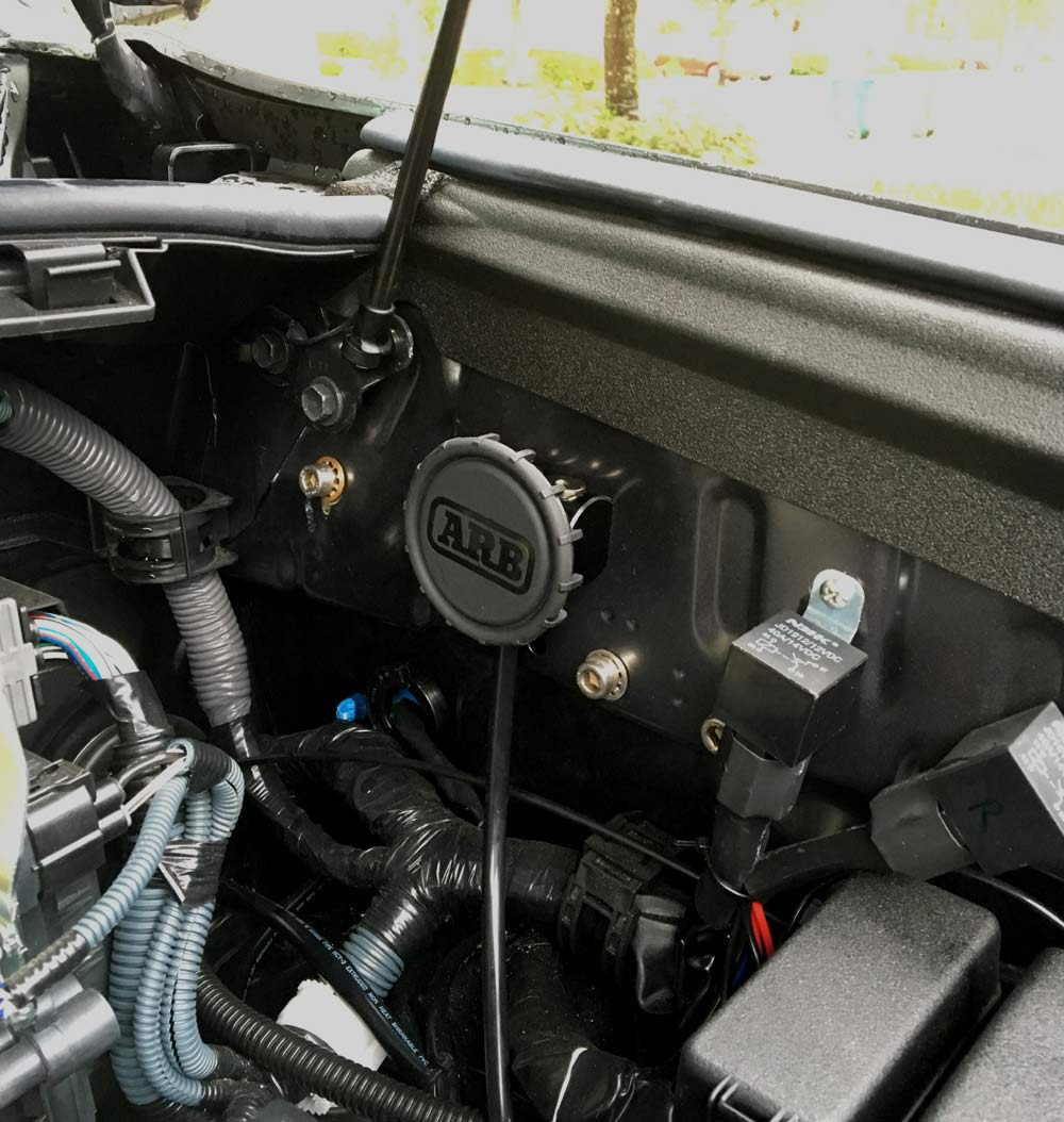

pic of the unit.

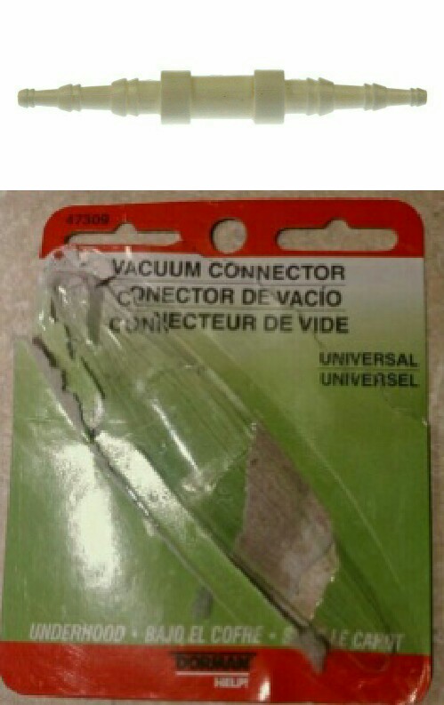

Installed the arb breather. Didn't do the e locker line yet because it needs a fitting to connect it to the arb line. Does anyone know which fitting will work. Just Barely enough line to run both lines with the arb kit so keep it tight and cut close.
This is what I used.
in my sig has some info that may help.
