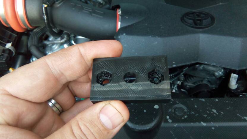

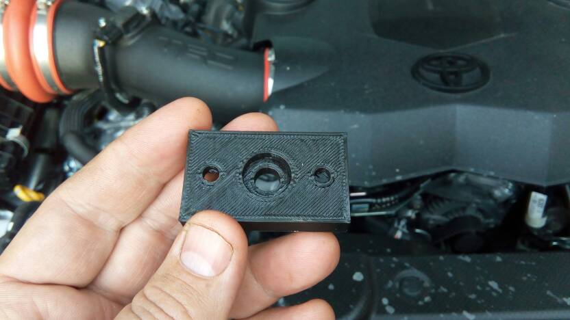

Had my buddy print me up a spacer so I could use the existing threaded holes on the fender, worked like a charm.

That's a good copy of my original aluminum one. Machine shops are easier to find in my area. I don't know anyone who has a 3d printer.

[MENTION=148258]elpete77[/MENTION] You should offer those for sale. I'd buy one when I finally buy my ARB kit.
We're gonna do one in a more robust material, apparently there's a type of nylon that's more robust in hot environments. Don't think it'll matter much since this isn't close to header or exhaust, but we'll do it anyway. Just let me know if you want one sometime and I'll see what I can do. Personally, I'd prefer to machine one out of aluminum, but I don't know any machinists.

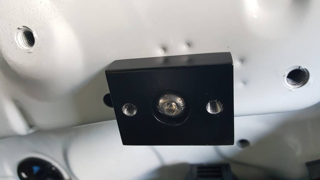

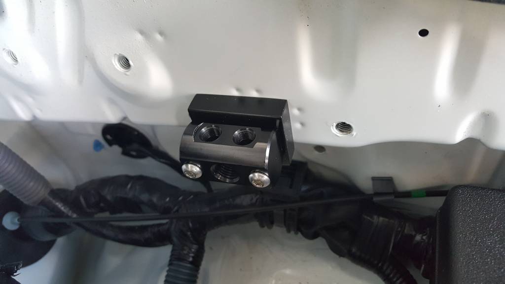

If you have a decent drill press at your disposal, you could buy aluminum bar stock, cut it to length and use a small end mill to make the countersunk hole. Drill the mounting hole and then the other two holes and tap those. Done pretty easily with minimal investment.
One caution I can give. I had 3 of these made, all the same, and the ARB block that came with one of the kits was drilled just slightly off from the other one. With some persuasion we made it work, but you should have the block in hand to get accurate centers on the mounting block screw holes.

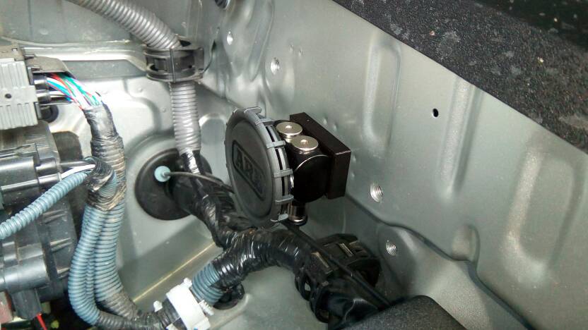

Going to install the breather this weekend. I'm split on where i should put/install it, in the rear of the engine bay or in the rear compartment where the stock lift-jack is stored (inside the rear cargo area).
Do any T4R members have their rear diff breather installed inside their runner or will i be the first?
I don't have the ARB diff breather. I made my own. I installed it in the jack storage area. Less line = Less money spent. I think I spent about $35 for the mod.
I think there was concern about odors from the diff venting into that interior location, but no one has reported any.
