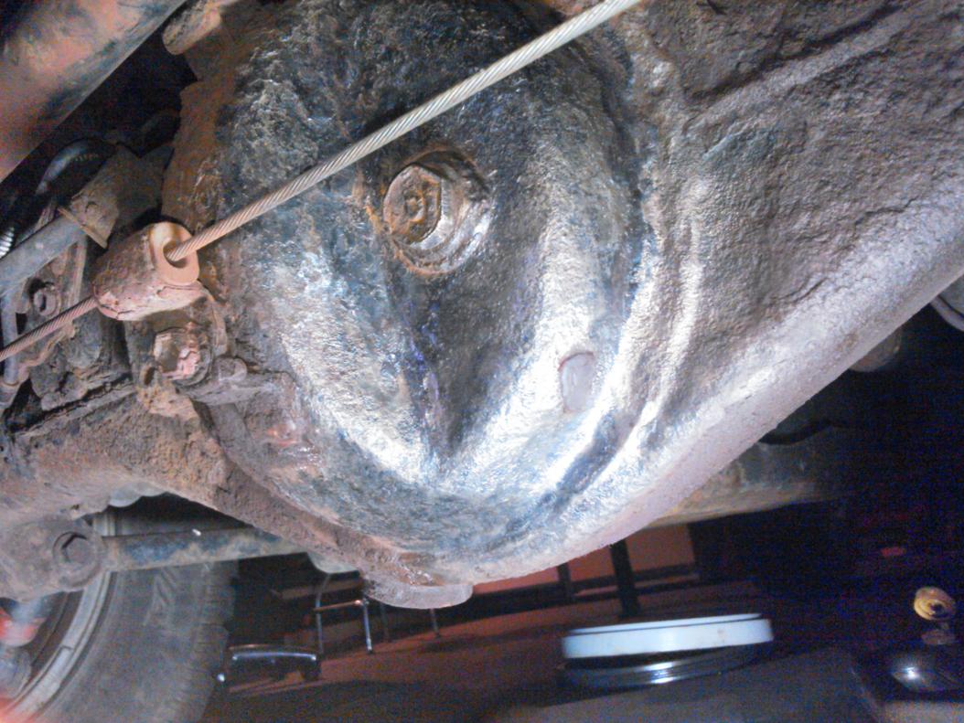

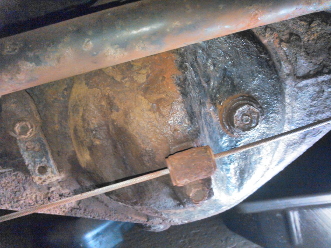

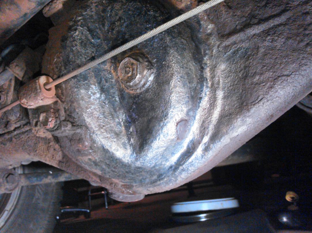

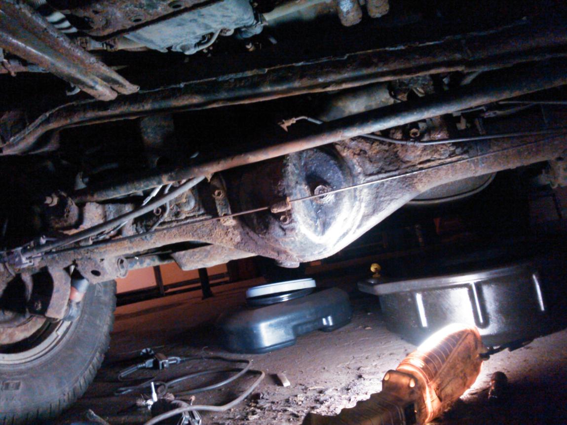

Well so far so good I haven't found anymore leaks on the right side. I think I got most of the rust off on the right side where I found that pin hole. I used a dremel with a grinding wheel & also used the wire wheel too. I also put a small piece of putty over the pin hole for now so it doesn't continue leaking while I search for more pin holes. Not sure how much better I can get this side with the tools that I have. I would of bought that air scaler but I dont think my air compressor is big enough to run air tools. Is this side prepped good enough as far as rust removal goes?? Might be kinda hard to tell in the pictures though..
Im kinda afraid to get any more off on this side since the metal might be getting pretty thin and I don't wanna make any holes. Thanks!

I'm pretty sure you have a hole on the other side, Looking at the pics and the way the wetness pattern flows downward with the peak almost pointing to the other spot. It's also above the other place of wetness, so it can't be the other hole. The first couple of pictures really shows where the hole is on the left (from the back)
