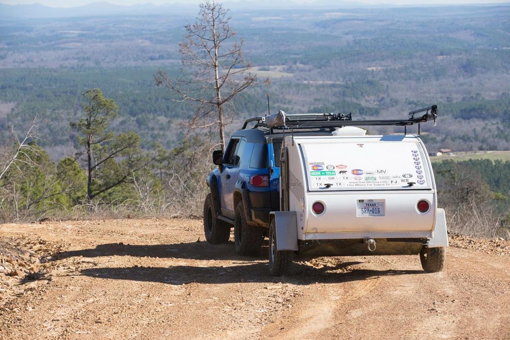

One last shot. If you have any questions Ill be happy to help anyway I can. I have never heard of yours therefore I cannot help in regards to that portion of your question.
I work with Teardrop Trailers - Oregon Showroom | Tear Drops NW, Salem Oregon ? and own the 1st built "Recon".
Building your own would be the most economical way to go about it if you have the skill set and the tools already. Otherwise, you're going to spend more from the mistakes, learning curves, and tooling you'll need to get going.
There are multiple manufacturers out there that build teardrop trailers. All of them have their pros and cons. But, if teardropping is seriously something you want to consider, then be prepared to spend a lot of money for something without the amenities of a traditional pop up or travel trailer.
I've learned throughout my extensive research before deciding on going with teardropsnw, the actual manufacturing process and choice of materials is what makes the difference in price between one maker and another. You have to ask yourself what the most important features are.
For example, do you want a frame that is fully boxed, C channel, welded, or bolt together...etc. Will this camper ever see an unmaintained forest service road? Do you want to have access to your cooler while camping? Will the cooler be on a slide? How important are cabinets and storage? Do you want quality wood such as marine grade birch or are you ok with plywood? How thick are the walls? Is everything screwed together or just stapled and glued?
All of these types of questions increase the price of a camper. Whether its something from a company like LittleGuy who makes thousands of these a year off a production line or a company like Moby1 who make less than 25 per year. To give you an idea, you can have a LittleGuy teardrop for about 10K loaded whereas the Moby1 XTR will set you back 30-40K for something similarly equipped.
If you're genuinely interested in learning more about teardrop campers and the lifestyle itself, shoot me a pm and I'd be happy to give you an honest and unbiased opinion.
