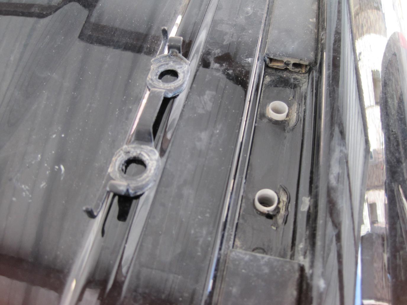

Anyone has the part number for this clip? Want to take the rack of my SR5 and they don't have this clip like the TE to attached the covers.
Pretty sure it is item 4 on page 139( Clip, Moulding (2/Side) 75561-52020) of the parts manual ,but ask your local parts dept. to verify.That's the drawing for the 4cyl model which didn't come with roof rails standard.

I did order those clips you pointed out but they are some other little plastic clips for the mouldings. I checked the parts manual up and down with no lock for the part nunmber. I know this clip is used in the older (4Gen) 4Runner models and on the Toyota Prados (GX470) but can't find a parts manual with diagrams for them either. Since ToyoDIY.com removed all of their diagrams it's useless to even look there and my local parts department is not very helpfull. Thanks anyway and will keep looking.
Tell the parts department to look at the TE for the part number. I'll take another look at what I have when I get back from Portland.

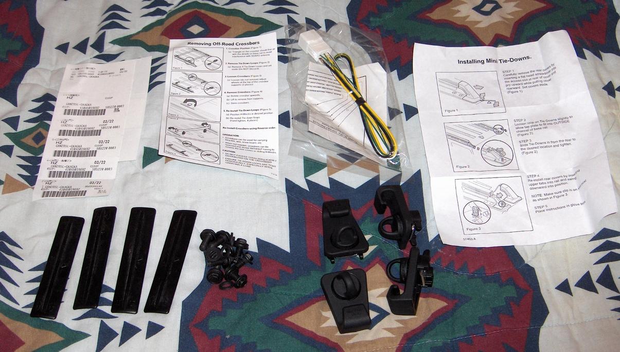

A picture of what I got in my 'goodie bag' that came with my 4R TE.
4 Roof rack hole covers with 8 bolts and rubber washers
1 Trailer brake harness
4 Mini tie downs
Should this not be coming will at 4 Runners?? I'd ask your dealer if you didn't get these parts.

I got everything you did, except for the hole covers and bolts.

Same here. I had to buy the covers as they probably got discarded when they installed the off-road rails.
