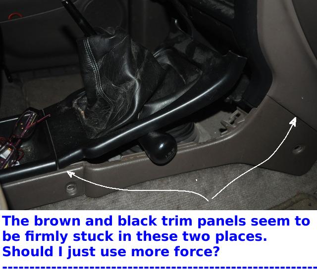

Q: How should I remove the two brown side "panel garnish" plates and the black "upper console panel" surrounding the shift lever?
Yeah, those plastic fasteners are a PITA. I break about 50% of them trying to get them out.
I think the panel around the shift lever just pulls up, no fasteners (that what the automatic dash is). Same as the radio panel, and the center console around the e-brake lever.
YI think the panel around the shift lever just pulls up, no fasteners
Hi Nelson,
It probably is that simple because the DIYs didn't even bother to mention this step. But for the life of me, I can't get either the brown side panels off or the top black plate surrounding the shift lever.
Maybe I'm not using enough force?
Hi Nelson,

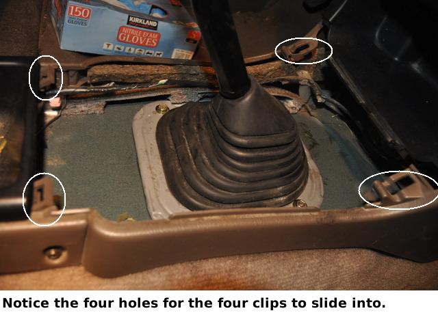

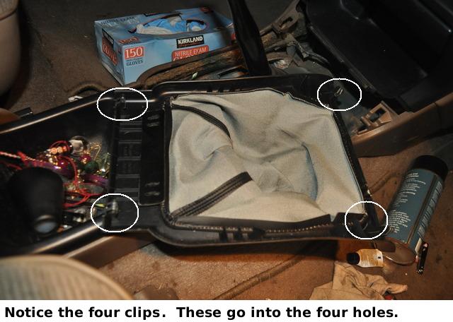

The shifter panel is held down by the center console panel (the one around the e-brake). Open the center console compartment, then pull straight up on that plastic. It should pop out, then you can get the shifter panel off.

As you said, I had to pry up on that center console black plate simultaneously with pulling outward (toward the front doors) on the brown garnish panels.
attachment.php
Wiggling and prying and pulling ... the black garnish came off! Thanks.
attachment.php

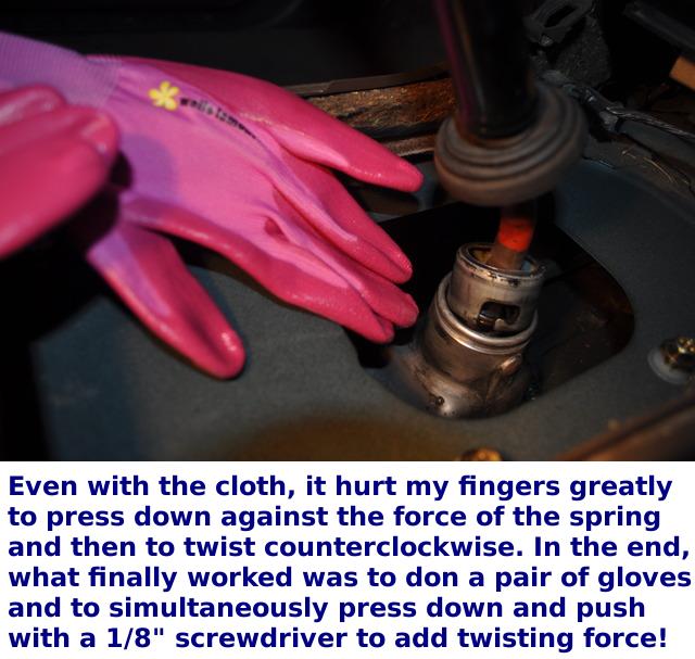

I still haven't been able to get that shift lever cover off.
Q: Is there a tool that will help me get that cover pressed down against the spring and then twisted off?
(Will the spring shoot out?)
No, the "metallic cap" as you call it, won't shoot out.
No, it should not take a lot of force the push it down and rotate it.
Put your thumbs on the wider areas on either side, and then push the "metallic cap" down. With it pressed down a bit, rotate the cap counter-clockwise, and the cap will pop up just slightly, and the shift lever can be pulled out of the transmission. Re-installation is just the reverse of removal.
DO NOT put water on the shift lever when sliding the rubber cap back down into place, or when reinstalling the boot. You do not want water in the transmission. Just slide the rubber cap back down, even with the friction of the "cap" and lever being dry of lubrication. Then slide the shifter boot down the shift lever, with the black painted part of the lever clean and dry.

No, the "metallic cap" as you call it, won't shoot out. No, it should not take a lot of force the push it down and rotate it.
Thanks O2SE for the confirmation, which echoes the instructions in the manual for removing the 2WD shift lever and give me courage to keep trying.

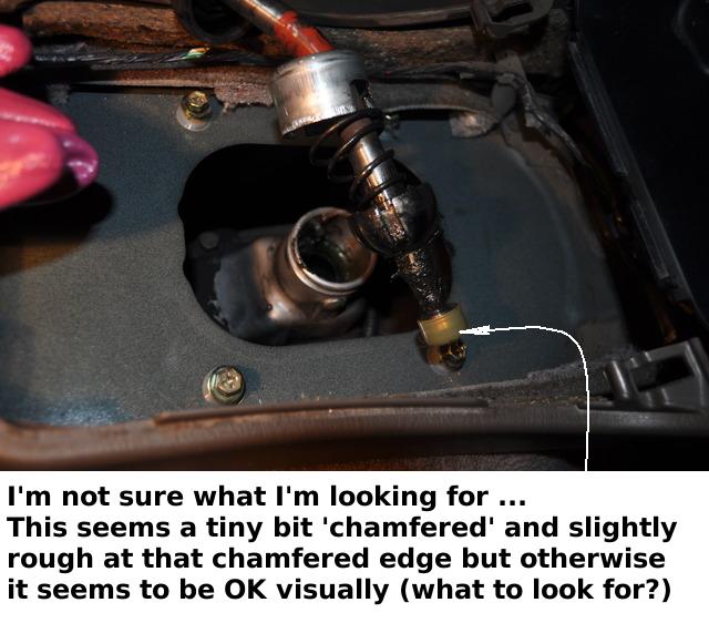

Bear in mind that a worn shift lever seat or shifter socket, might not be the problem.
Interestingly, the shop manual says it could be the following (but it doesn't mention the fluids, seats or sockets for these two problems):
attachment.php
Anyway, given your encouraging advice, I was able to press-and-spin that inner 'shift lever cap' off only after donning gloves to protect my fingers and adding a pushing force with a small 1/8" screwdriver in the counterclockwise direction!
(And, you were right, the strong spring did 'not' shoot out at me!)
attachment.php
attachment.php

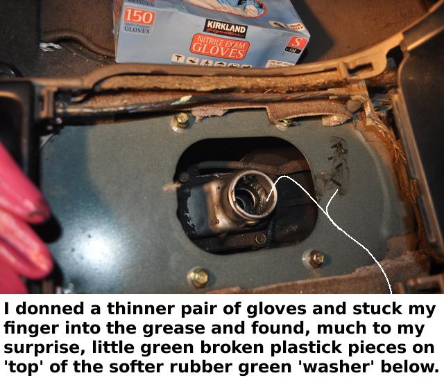

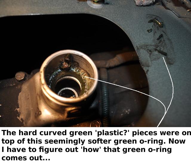

EDIT: Oh oh ... I think I found a possible culprit (just as you said it could be):
attachment.php
attachment.php

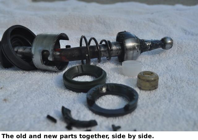

What I 'think' may have happened is the top of the two-piece bushing shattered.
My next two steps are:
a) How to remove that shattered bushing (I'll keep trying to spin it out) ... and ...
b) Where to get (tomorrow) a new bushing while still being able to drive the 4Runner to get it (probably the dealer).

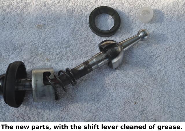

Wow. With your kind help, I think I've gone as far as I can for tonight (it's past midnight).

1. Lithium grease (is my Mobil1 synthetic grease OK?)
2. New shift lever ball seat (definitely!)
3. New shifter socket (maybe? How would I know?)
Q: Being midnight, where can I find the part number for my 1997 2WD W59 5-speed transmission shift lever ball seat & shifter socket?

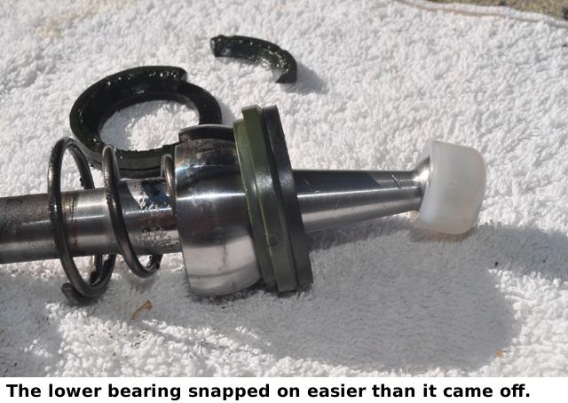

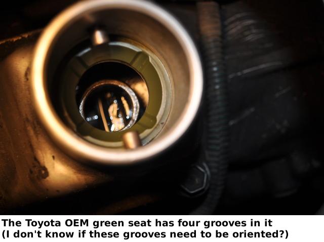

Here, from photobucket and from this forum is a nice closeup of the destroyed shifter seat (33505-35020):
IMG_1749_half.jpg~original
And, here (from the same source) is a closup of the upper shifter bushing (33548-31010):
IMG_1752_half.jpg~original
As for materials, this is what I found out, so far:
1. Rubber ==> Toyota (lower, larger, softer 33505-35020 $17.65 at San Jose dealer; upper smaller harder 33548-31010 $8.59 at dealer)
2. Delrin ==> Marlin Crawler 559-252-7295 ($12.50 & $7.50 respectively, they say it's nylon, 1 day fedex, 1 week usmail)
3. Urethane ==> AST 866-789-3624 (called and they can get it to me in 2 to 4 days for $11 & $5 respectively).
The prices online are about $10 for the lower shift lever bushing (W0133-1741737) and half that for the upper shift lever bushing (W0133-1644479) but the availability is two days or more:
66644d1340631430-how-do-you-post-text-interspersed-pictures-diy-what-am-i-doing-wrong-final.jpg~original
Apparently the upper (smaller) shifter bushing is relatively universal (33548-31010) and easy to find online (OEM Toyota BUSH, SHIFT LEVER) ... but the lower (larger) shifter bushing can be either part number 33505-35020 or 33505-35030 (OEM Toyota SEAT SUB-ASSY, SHIFT) but for my 2WD 1997 4Runner with the W59 transmission, it's PN 33505-35020 according to a call to the Toyota dealership this morning.

Regarding the Mobil 1 grease you have: The shift lever and seat is lubricated by the gear oil in the transmission. So any grease you put on the shifter would just be to ease installation of the shifter. As is specified in the manual. The write-up I referenced in my first reply, the Author coated the shifter with grease. That is unnecessary, and in fact the grease will be dissolved into the gear oil in short order as the transmission gets warm, as you drive the vehicle.
The thing about write-ups that you find, is that they are usually one individuals method for accomplishing a task. There is usually more than one way to accomplish any task. So someone's write-up may or may not be the best way to accomplish a particular task.
Considering how dirty it was in the shift lever tower, I'd consider changing or having the gear oil in the transmission changed.
I would personally go with the parts I referenced in my first post, as they are more durable than the OEM parts
I don't disagree one bit. In perfect hindsight, this is what I 'should' have done:
a) I noticed the shifting problem & asked here
b) You gave me a great pointer to upgraded parts
c) I 'should' have ordered the upgraded parts pronto (it would have taken 2 to 4 days)
d) By the time I was about to disassemble, I would have had the upgraded parts in my hands
Lesson learned.
BTW, I called the company you referenced and they said their seals are nylon and that they could fedex them for receipt in two days or US mail which would take a week.
Your socket doesn't look too bad, so it's up to you if you want to replace it.
I agree with you, now having seen pictures of the new upper socket.
But I already pulled it off the shifter (it wasn't as easy to do as it looks) because I had decided to replace it. In doing so, I chewed it up a bit so my advice, again in hindsight, is that you can't easily remove the upper socket with pliers without ruining it.
That's interesting!
I called Toyota and they also said not to lubricate it ... but ... the weird thing is that the big ball on the shifter has grease on it which must then be from when the clutch was replaced 5 years ago if it wasn't the factory from 15 years ago.
Thanks for the advice. I'll stay away from the grease. But, just for the record, if you look in the pictures prior, you'll see black grease still on the big ball - so - some greases must stay.

Now, having done it, I would say it's an hour job - but - it took me over six hours, mostly in the time it took to figure out how to remove the trim (but I also did a lot of web reading and DIY photo annotations which took a ton of time - but which I hope helps others in the future). I'm a people person who loves to please ... so I hope others like the DIY instructions above.

It's hard to say from the picture, but it could also be, and likely is, bits of the disintegrating seat mixed with gear oil. Giving a look of grease.
There are some very high temp greases available, and it's possible someone put high-temp grease on there at some point, but they are unnecessary in this application.

Putting it back together took all of about five minutes. I tested it and it seems to be working fine now.
Thank you very much for your wonderful, timely, and most of all, courteously helpful advice!
Here, for the next reader's edification, are some final pictures of the old and new parts together.
No problem. I'm glad it wasn't an internal problem in the transmission, as that quickly gets expensive.
