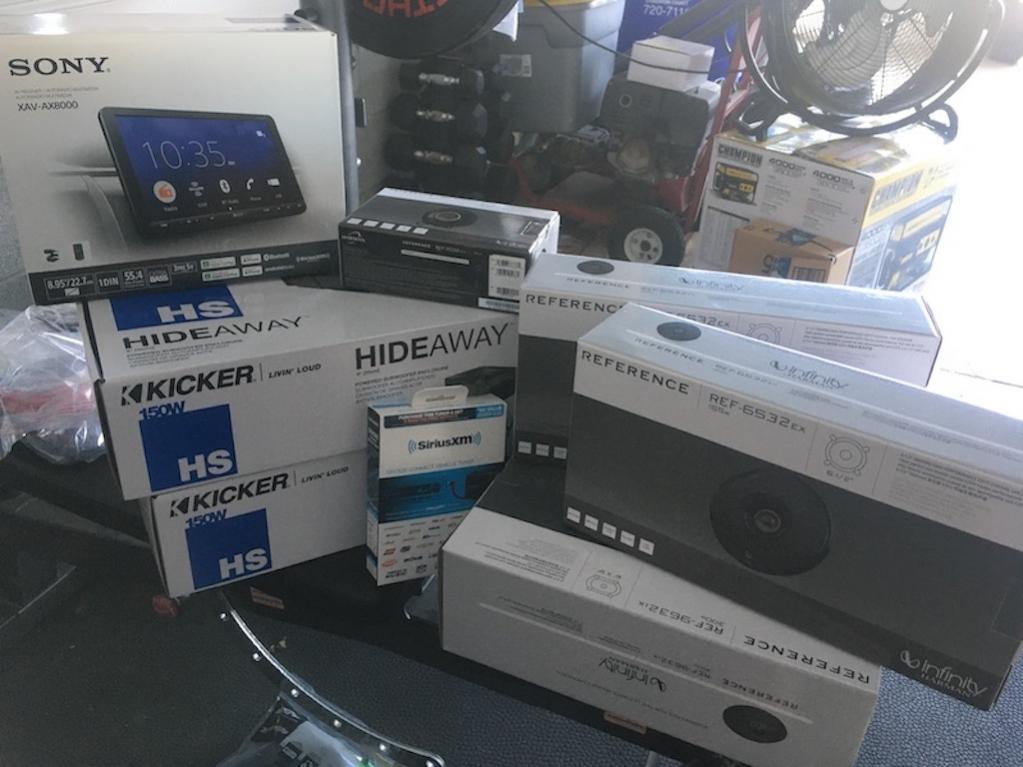

Long time forum reader, but finally wanted to do something and put it out there for your input, thoughts and advice. All of this started with the factory Entune system and its constant need to restart itself. That drove me to want to replace the head unit, and thinking "i will replace the head unit" then i might as well replace all the speakers as well. Great Choice... but if you are going to replace all the speakers you might as well just add two powered subs to round out the system and sound dampen/dynomat the entire cabin...
SO with that pragmatic logic, compounded by my inability to say no to a good Black Friday deal. I come before you this evening on the precipice of a full install and retrofit of:
Head Unit : Sony XAV-AX8000 (Sony's New 9 Inch Display)
Infinity Reference: 3.5 Inch (Front Dash)
Infinity Reference: 6x9 (Front Doors)
Infinity Reference: 6.5 Inch (Rear Doors)
Infinity Reference: 6.5 Inch (Rear Hatch)
(2) Kicker Hideaway 8" Powered Subwoofers (Driver Seat/Passenger Seat)
152 Square Feet of Damplifier Pro - Second Skin
90 Square Feet of Luxury Liner Pro (MLV) = Second Skin

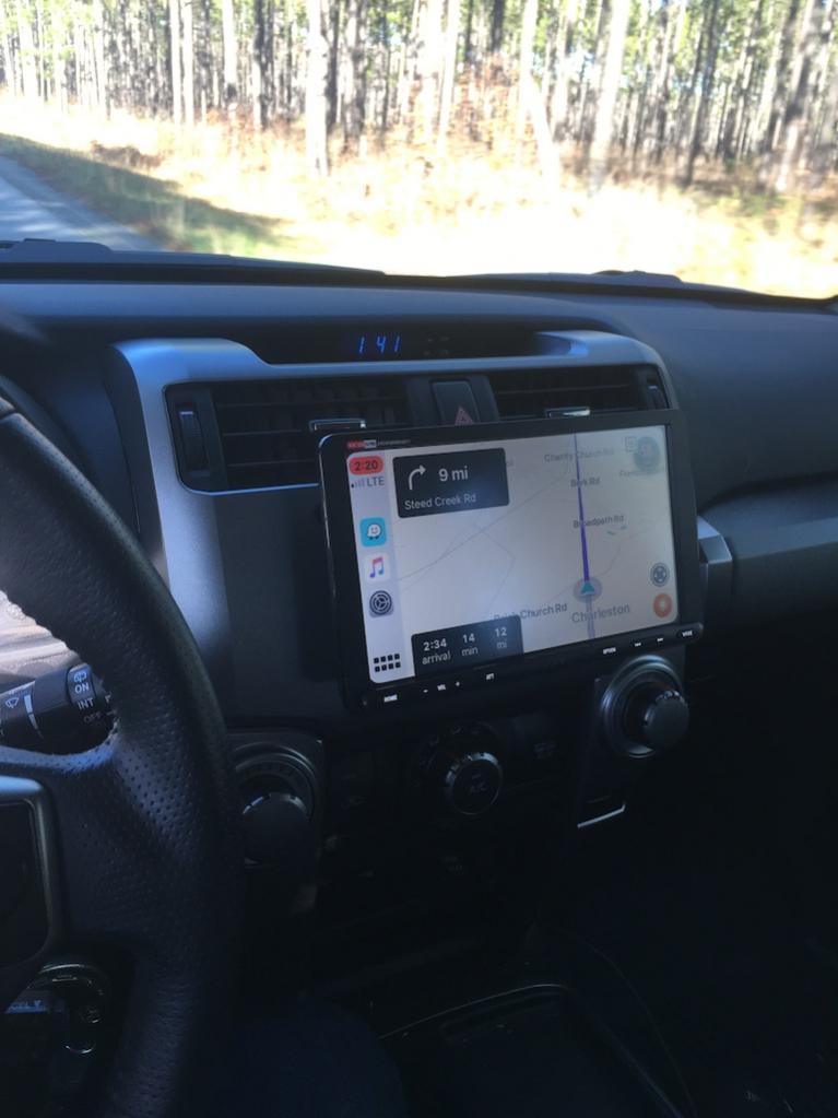

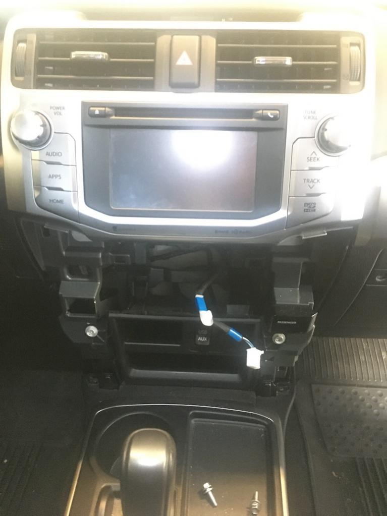

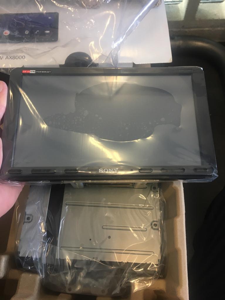

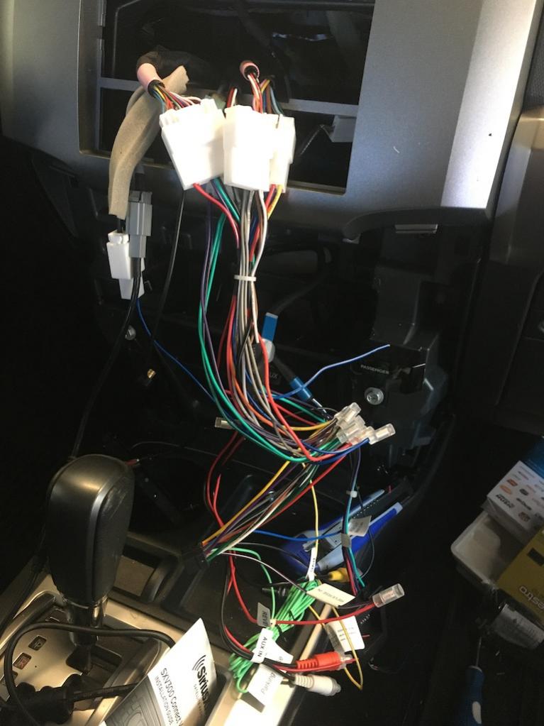

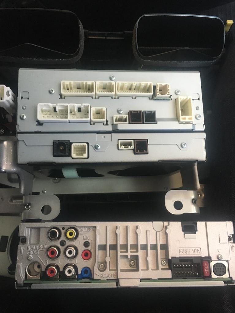

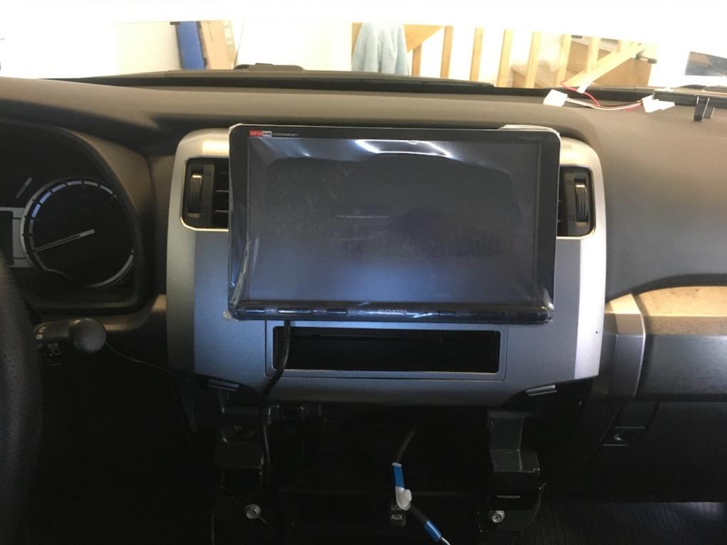

I had time and managed to get the SONY XAV-AX8000 installed today in a little under 3.5 hours. I will post a full write up about it tomorrow and the install but so far i am pretty impressed.
Funny how an install that you thought would take 60 minutes ends up almost taking four hours....

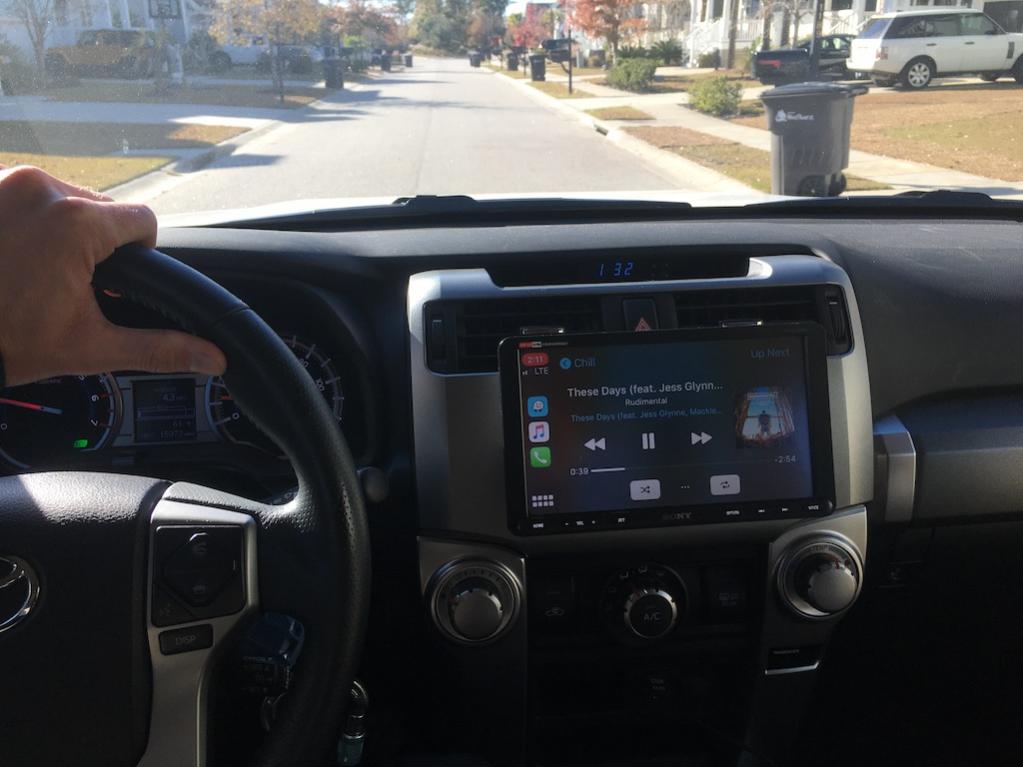

I was wondering how the Sony would work/look. You can lower it a bit to not block vents (but likely touch climate controls)? Backup camera is retained? Nice work.
On the Crutchfield site it indicates some setups retain the backup camera and lose the fader.
I've been goofing around with a cardboard mockup to see how I think it will fit. The pictures help. I'd move it down to the bottom of the vents and see if I can still see the controls underneath. It looks like it sticks out too much for my tastes. So, I'll probably just stick with the Alpine and the smaller screen....which works fine.
the one thing that i didnt like about the sony unit is that there is no option for maestro. Good luck on the deadening, long sleeves and watch out for the foil edges. What do you plan to do with the door holes?

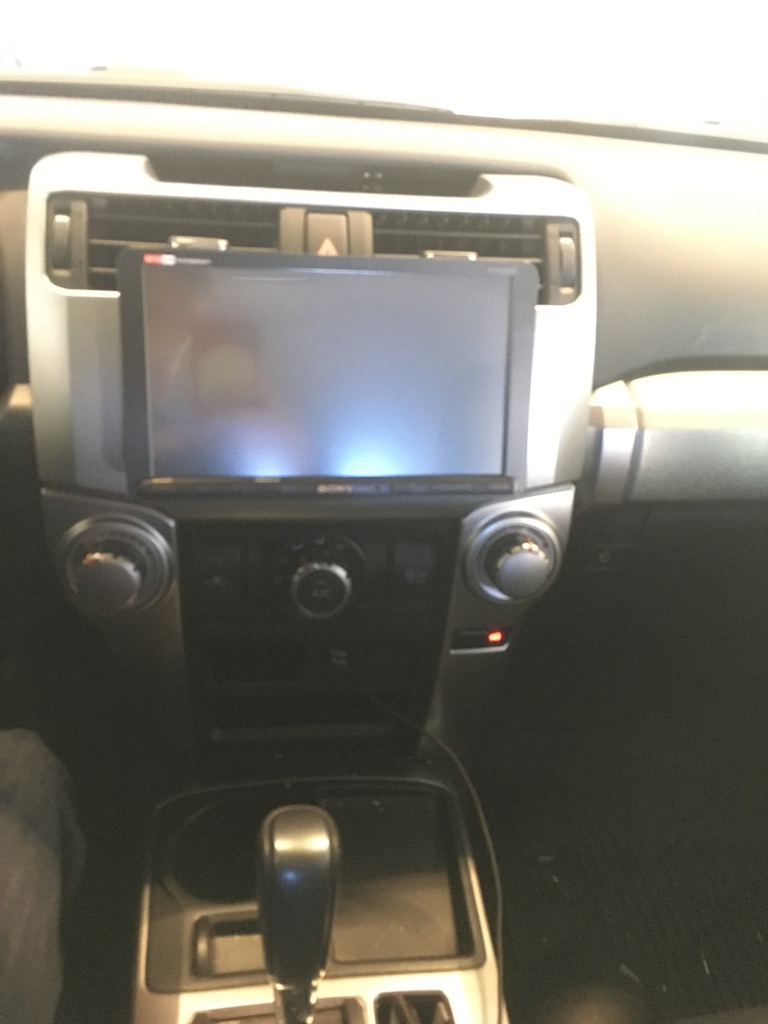

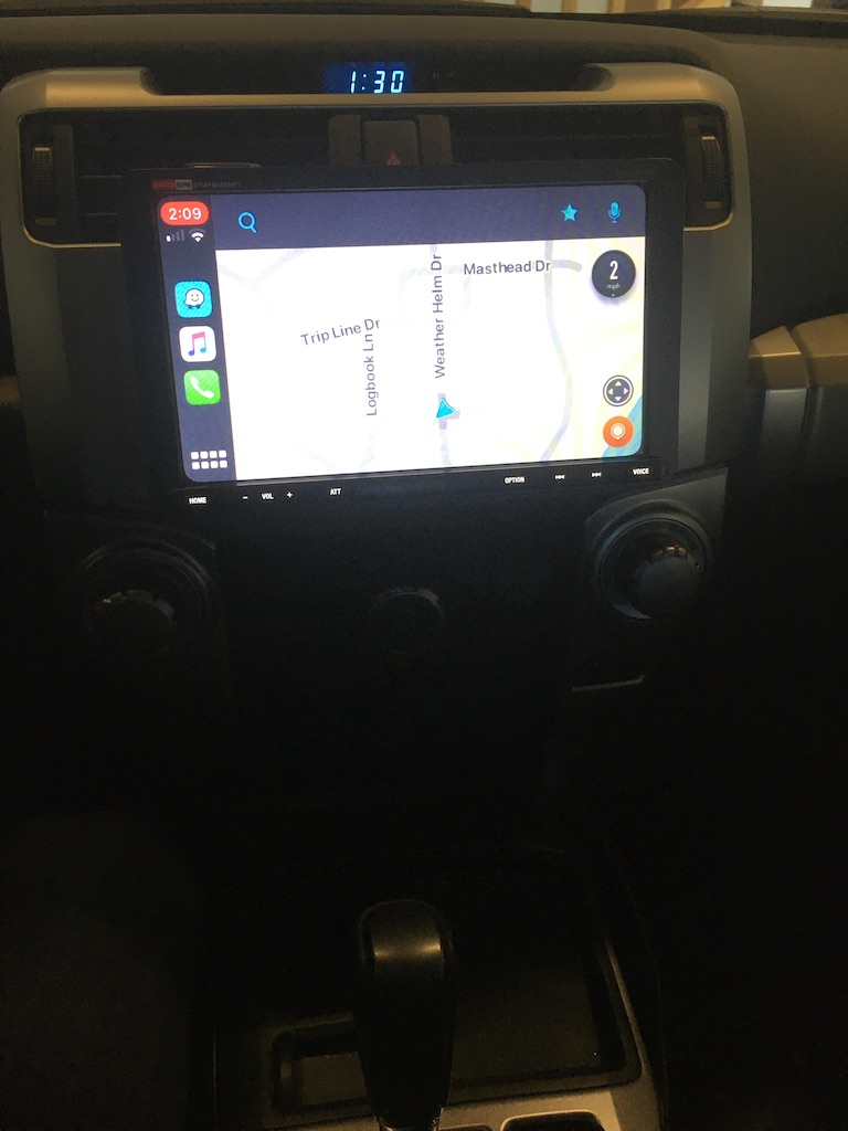

The Sony head unit is highly customizable as far as height, tilt and vertical placement. I ran it through a few options and it is in the "middle" as far as "being pulled out from the dash" and i can lower it by "two slots." This was my first run at positioning and I am going to lower it by those "two slots" and am confident it will not impede the vents nor touch the AIRCON controls.... Pictures to follow.
NO WIRELESS Apple CarPlay (but i knew this going into the purchase) I always have my phone plugged in when i am driving, so there is not much of a concern with not having this feature.
I retained full BackUp Camera, Driver Steering Wheel Controls and Factory use of Radio Antennas...
In just 12 hours I really enjoy the head unit...

Is that bottom pic as low as the screen can be mounted? Looks like it would be perfect another .5-1" lower.
Bonus hidden stash cubby.
Screen Mounting

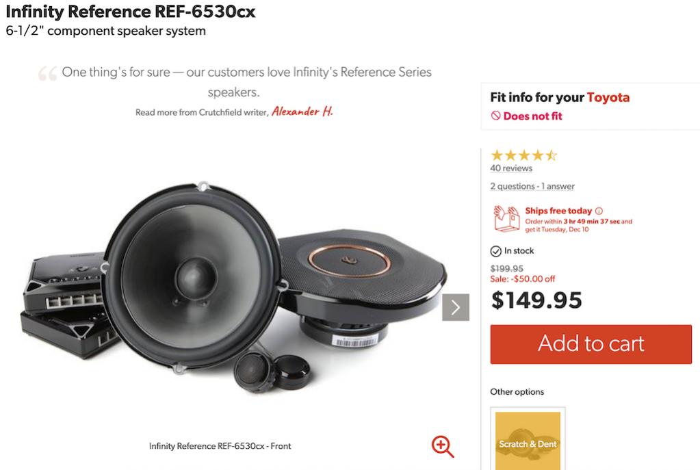

No. As the screen is currently mounted there are two more "slots" to lower the screen. Sometime today I am going to drop the screen and take new pictures. I am on the phone with crutchfield trying to figure out what 6x9 Component or 6.5 Component to buy for the front door/dash
Thoughts?
This is what I am being told is good alternative... Thoughts?
Yes, those are the component version of the coaxial speakers you ordered. You can get those or they also make a 6x9 version as well.
Just a heads up Amazon has last years model (same specs) for $98 if you are looking to save some money. It is directly from Infinity's through amazon so I believe it is considered an authorized dealer, although you will still get better customer service through crutchfield.
