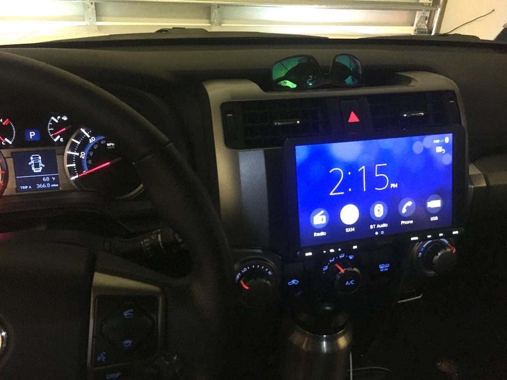

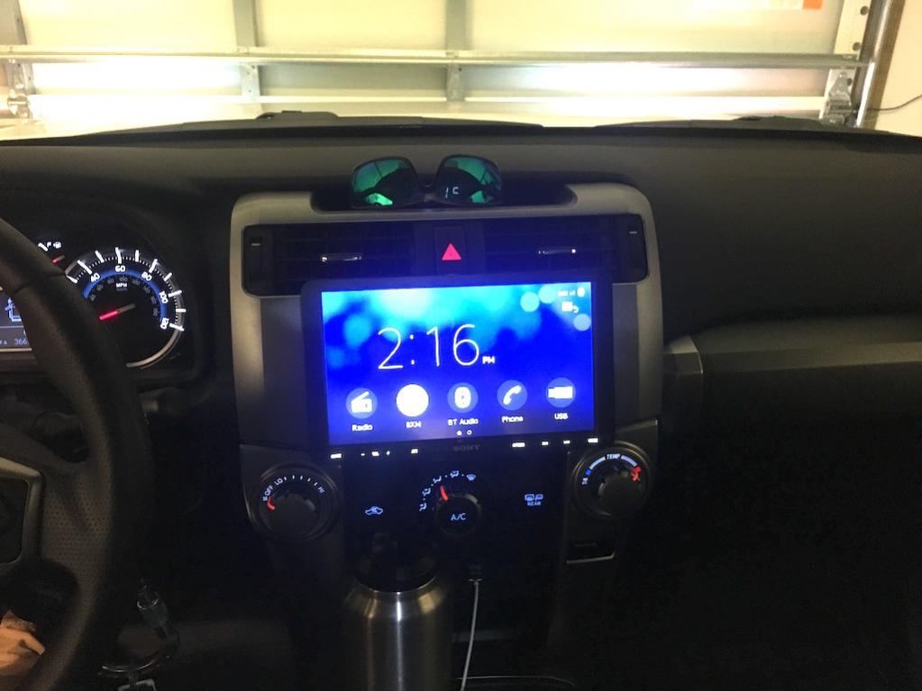

Just discovered this HU yesterday and was wondering how it would look.
How is the boot up time? Is that cubby easily accessible with the HU mounted where you currently have it?

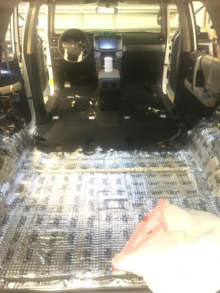

Trim, Carpet Removal - Screen Lowest Postion
Afternoon.
In prep of the sound deadening install, I spent yesterday removing the trim, carpet and seats to allow for better access. I am glad I started early as it seemed to take me more time than I anticipated... I also lowered the Sony head unit screen to it's lowest position and attached pictures for all those that have asked.
(As a side note... When i removed the factory carpet and trim and drive the 4Runner around, I was very surprised how significantly more loud the ride was... it really sounded like all the windows were down. I had no idea the factory carpets and trim blocked so much noise!)
Total Invested: $1,629.00
Hours: 6.5 Hrs
dB Reading Idol: 32 dB (11 dB increase)
dB Reading at Speed: 55 dB (5 dB increase))
dB Reading at 65 MPH/Highway: 84-87 dB (5-7 dB increase))
Up Next: Sound Deadening the Trunk/Wheel Wells and Floorboards
Remaining: 6x9 Ft. Door, 6.5 Rr Door, 6.5 Hatch, Dual Subs, Sound Deadening

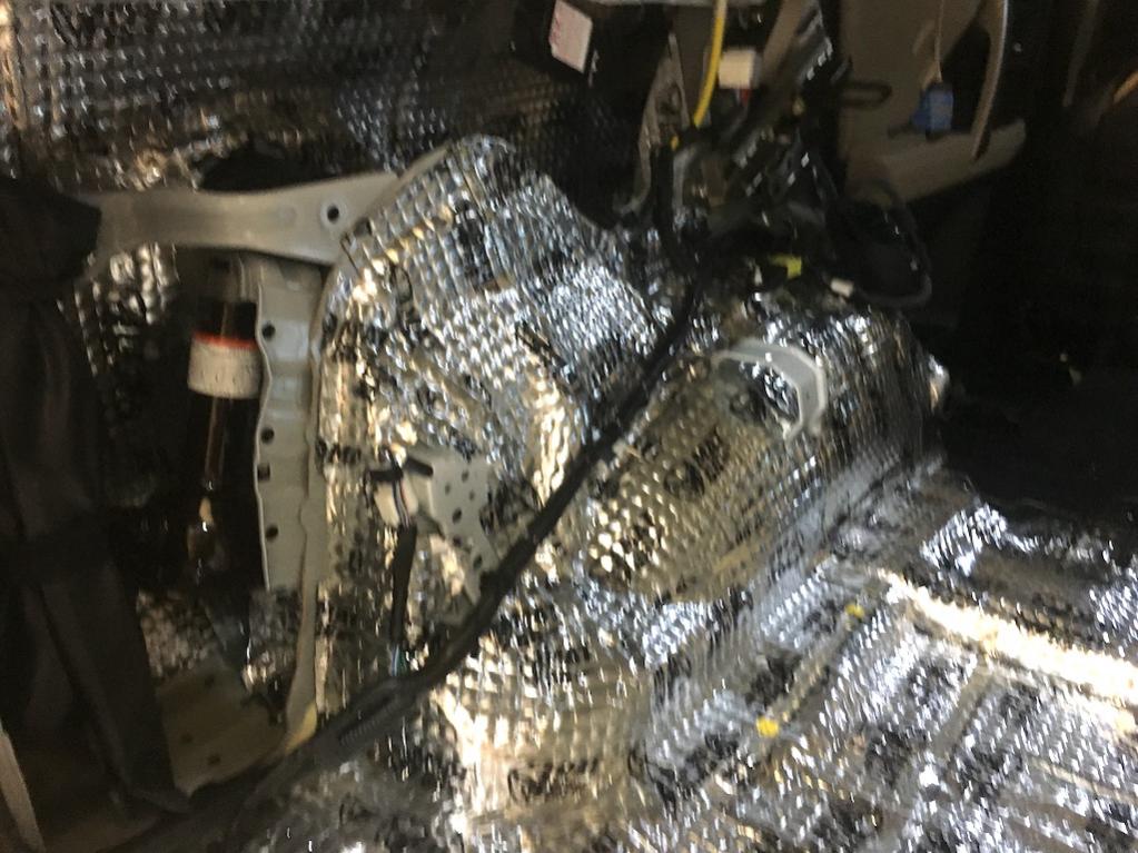

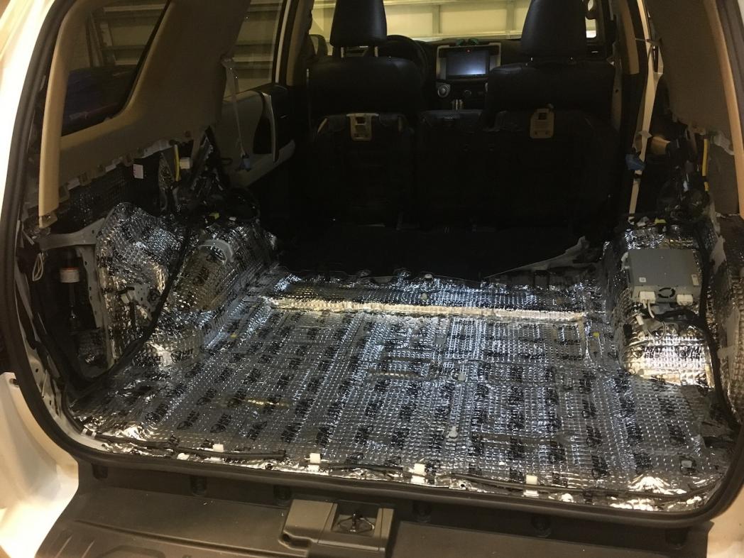

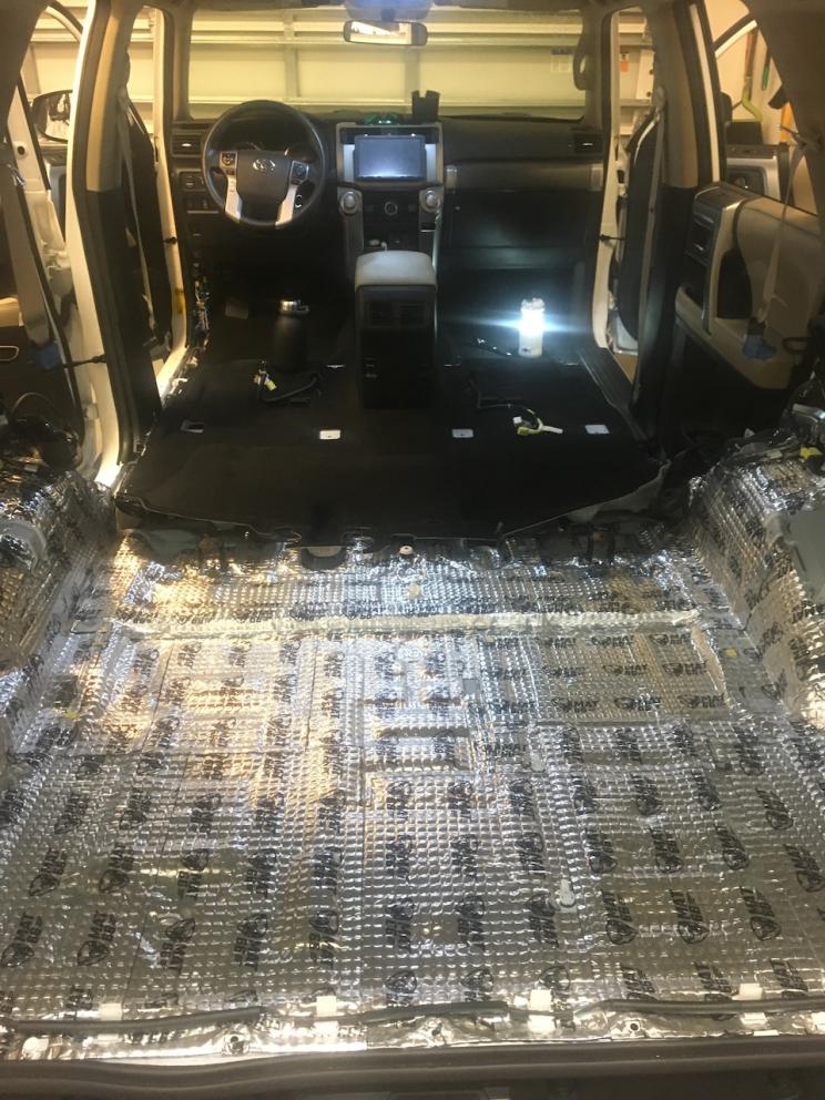

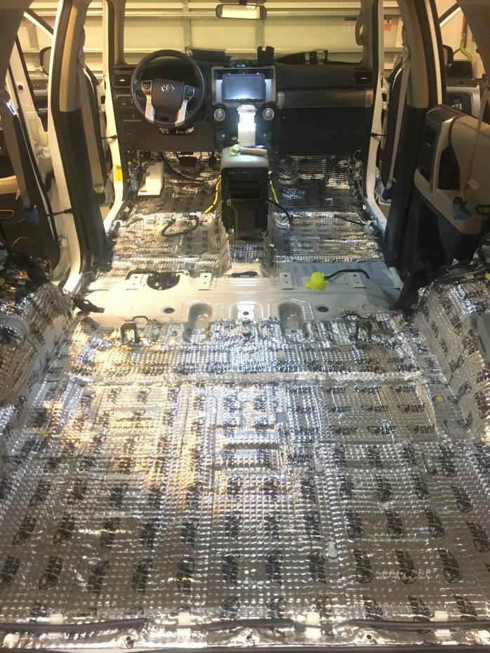

Sound Deadening Trunk, Wheel Wells and Floorboards
I started tackling the sound deadening today. I am glad I started prepping the trim yesterday because it really allowed me to concentrate on the placement of the Constrained Layer Damper. I am enjoying the process but slightly concerned about material buildup and how well the factory carpets will go back in to place (especially with the Mass loaded vinyl yet to be put down)...
Hours: 10.5 Hrs
dB Reading Idol: 32 dB (11 dB increase) NOT TESTED
dB Reading at Speed: 55 dB (5 dB increase)) NOT TESTED
dB Reading at 65 MPH/Highway: 84-87 dB (5-7 dB increase) NOT TESTED
Up Next: Sound Deadening the Driver/Passenger Seat and MLV

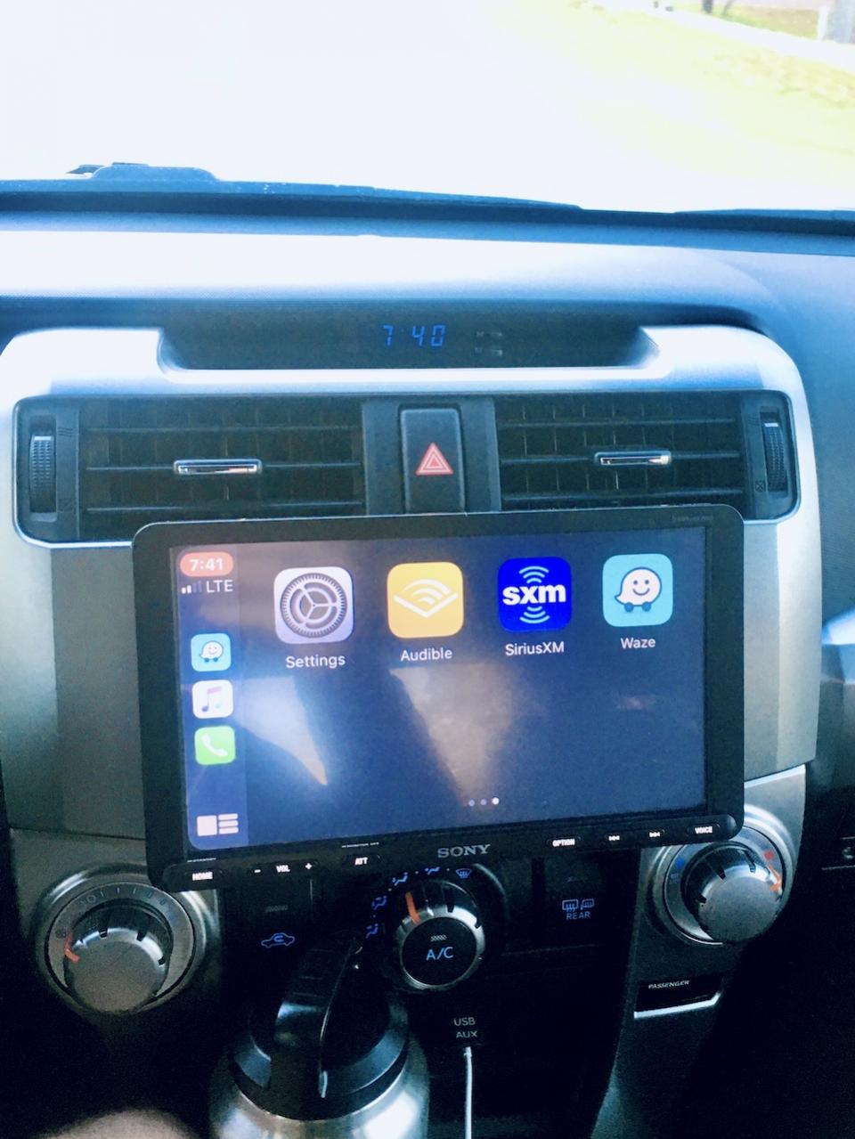

awesome work :) this HU is a great alternative to the halo. btw, when your running carplay.. how many icons across ? most only have 4 icons across. i believe only T9 has 5 icons across.

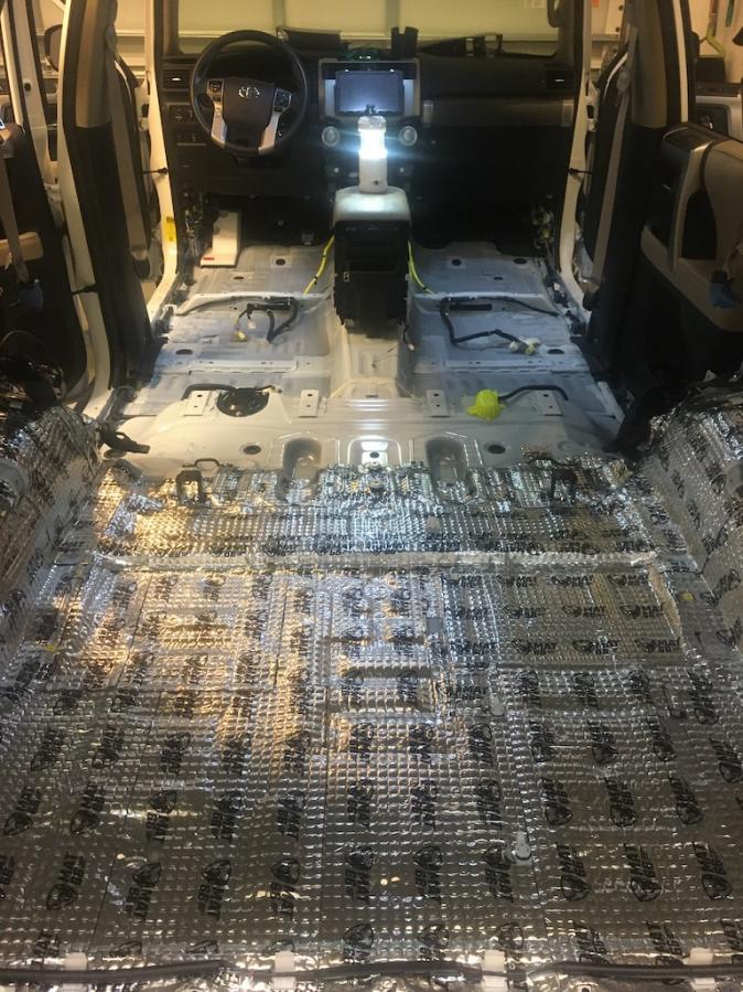

Working today on putting Constrained Layer Damper all the way to the driver's cabin. If i feel spry, I will attempt putting some Mass Loaded Vinyl to see how difficult the process is... Friday, I am pulling all the seats out and removing the full run of carpet to knock out a large chunk of the overhaul. Expecting to spend 10 hours (or a bottle and half of Maker's Mark, depending on how you personally gauge time) on the project.

1) I did order the 6.9 and Tweeters component system and will return the 3.5 and 6x9 co-axial. I hate to see them go at the price i paid for them on black Friday.
2) The Song Head Unit shows FOUR rows of Apple CarPlay when running. (Picture Included)

Tested dBs last night with the trunk, floor-liner and wheel wells covered in CLD. Surprised how quickly the numbers are coming down... I will say, having the CLD on the sheet metal really makes the structure seem more "solid"... there is probably a better way to say that but my South Carolina education is holding me back.
Hours: 11.5 Hrs
dB Reading Idol: 27 dB
dB Reading at Speed: 46 dB
dB Reading at 65 MPH/Highway: 76 dB

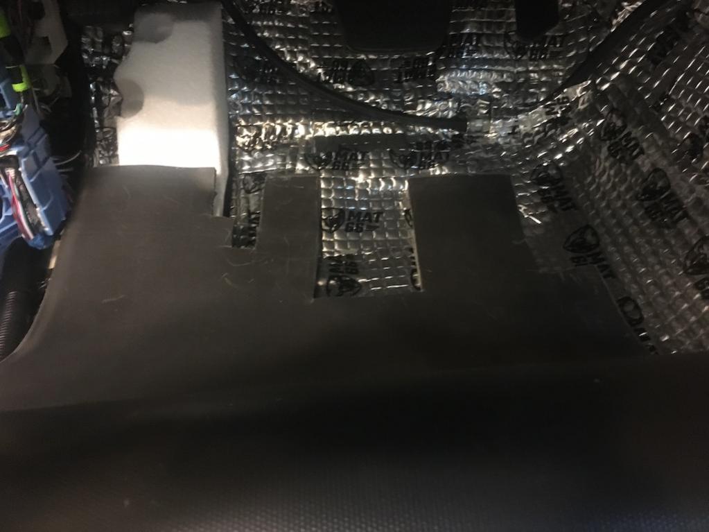

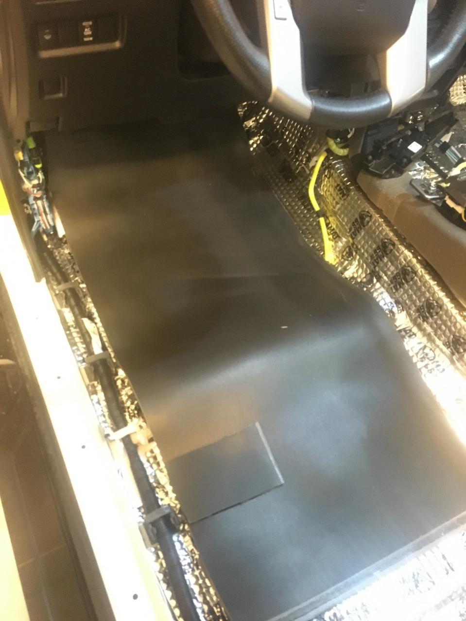

Question - In Progress...
Guys... Working forward on the sound deadening... I am going to completely remove the entire carpet runner...
QUESTION
What do you think about just Velcroing the MLV to the carpet and using the factory flooring as a template? Could that yield a solid fit in a timely fashion?
Thoughts?

Great work so far. I think you be very pleased with the sound deadening.

10 Hours working on Sound Deading and only 60% Finishesd
More to Follow Sat/Sun.
This overhaul is much more aggressive than I imagined The MLV is a bear to work with but I am slowly getting through it......

Factory USB port
I had time and managed to get the SONY XAV-AX8000 installed today in a little under 3.5 hours. I will post a full write up about it tomorrow and the install but so far i am pretty impressed.
Funny how an install that you thought would take 60 minutes ends up almost taking four hours....
I bought this head unit and am installing it now after seeing your post. A Noob question - were you able to retain the factory USB port under the AC controls? I just found out that the other end of the port connection is a part of the harness to the factory head unit not an USB connection. Help would be appreciated!

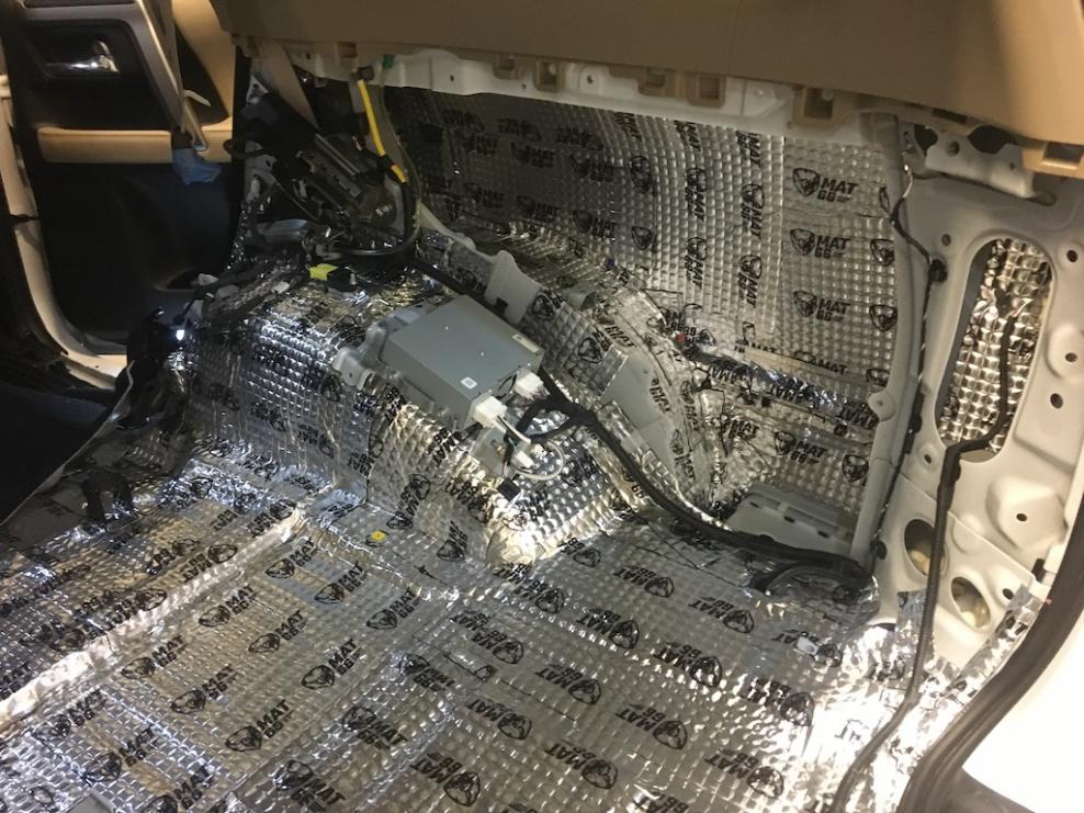

CLD (DynoMAT, KilMat) - I ended up using 144 square feet of CLD on the entire cabin. I know this number is a little overkill but I had invested the time and wanted to err on the side of caution versus possibly regretting adding more later. Driving a few days with just the 4Runner with CLD tiles was a unique experience. To a small degree it does drop the noise but for the most part i would say it “dulls” the noise… I don’t know if that makes sense (forgive my South Carolina education here), but the CLD tiles make the truck feel solid (i love the way the doors feel like a luxury car when you open or close them). The CLD tiles make a definitive improvement to the ride but they don’t truly “knock the sound down.” The BEST example i can give is if you are riding with the front windows down and then you roll down the rear hatch window. Both have a certain degree of noise but they SOUND DIFFERENT. If anyone can articulate more concisely what I am attempting to explain here please jump in. Bottom Line: CLD tiles serve a precise role in sound deadening a 4Runner they just don’t significantly make it more quiet.
MLV (Mass Loaded Vinyl): OHHH… MLV… How I love to hate thee… If you have never worked with MLV, it is an experience. I used Luxury Liner Pro (MLV integrated with 1/8’ closed cell foam) from SecondSkin. 90 square feet in 10 sheets. Think of a 18 pound yoga mat you would buy for your wife if you wanted her to be sweating by the time she got from the car to the yoga studio… That is pretty much what a MLV sheet is like. It is great to work on flat, horizontal surfaces but a true bear to work in curves, angles or around ridges. The goal is to create a solid, unbreakable “mat-layer” running from the firewall all the way back. With that being said I DID NOT MLV my rear driver/passenger doors or the rear hatch (i would have run out of product). It took some time to get get used to working with such an unruly product. To join seams I used an electric kitchen knife (think carving a turkey) to remove the closed cell foam from the back from scrap MLV and used HH-66 contact cement to join two pieces.. I concentrated most of my sober attention to the driver/passenger cabin and the rear trunk, wheel-wells and sidewalls. I was surprised the large amount of noise that was coming in the 4Runner from the firewall AND the rear trunk.wheel-wells. (Side Note: Placing MLV inside the driver/passenger door is possible, it just takes a LOT of trial and error. The results are phenomenal but I actually let mine sit overnight closed but not attached so the next day I could see the indentations in the MLV to know exactly where I needed to trim.) I am still not 100% finished with the drivers door but am very happy that I have an entire slab of MV starting 8 inches above the pedals on the firewall running all the way too the rear door hatch seal.

The noise/sound deadening and blocking between the CLD and MLV is PHENOMENAL. I can not hear the sound of the engine regardless of the RPMs and at highway speed I can clearly hear an audiobook (because here in South Carolina no one ever taught us to read), at volume level 5. It is incredible how much the difference is between before and after. The car feels more solid from the CLD and the MLV does an outstanding job of blocking the road/engine noise form the engine, wheels and road. Of course it is not “dead silent” there wind hitting the windshield is now more pronounced (because of the lack of sound anywhere else) but it is hard to describe how quiet the car runs even with all the windows down and the sound system off.
If I had to do it all over again, I absolutely would. I would attempt to recruit help (I did 100% of this project by myself) it is not difficult work just very tedious. To do it all over again, I might think about just replacing the 4Runner’s carpet since I had pulled it completely out of the cabin anyways and would purchase a roll of MLV without Closed Cell Foam to be used as a seam joiner between MLV sheets…. IT was an adventure but I am impressed.
(SO a friend pointed out the program that I am using to measure dBs is not “calibrated” but used it one last time to measure the CHANGE in dBs (before and after). I am going to run a true dB test with a calibrated device on Sunday but will update my numbers below for the changes I observed).
Total Invested: $1,689.00 (Increase 81.00$)
Hours: 48.2 Hrs
dB Reading Idol: 18 dB (Decrease of 14.3%)
dB Reading at Speed: 39.7 dB (Decrease of 22.2%)
dB Reading at 65 MPH/Highway: 56.7 dB (Decrease of 31.1%)
Final Adjustments are still being made to the driver/passenger MLV. Pictures will follow, please feel free to correct any errors I made in my explanation or articulation of the install….
